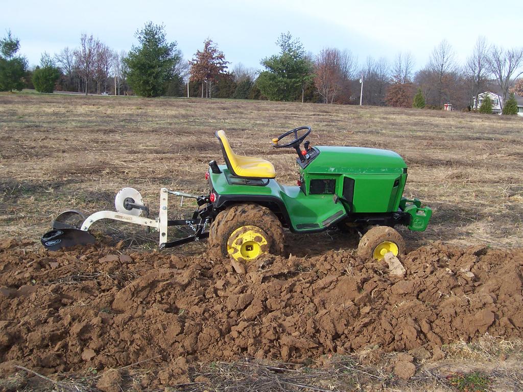

Serial number makes it a 1987.  The earlier versions had a B43E 16 hp Onan, while the later ones used the P218 18 hp Onan.  I believe the change was around 1987, so yours may have the 18 hp.  The 316 Onan was basically a stripped down 318, with no power steering and just one spool of hydraulics while the 318 had power steering and two spools of hydraulics. You could get a category 0 3 point hitch for these tractors. I had a '88 316 that was converted to dual hydraulics and it had the 3 point hitch.  It was my plow tractor, and it was great in the field - a lot better than my Wheel Horse 416-8 that I used a couple of years ago.
