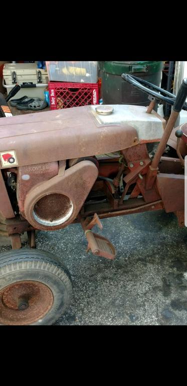

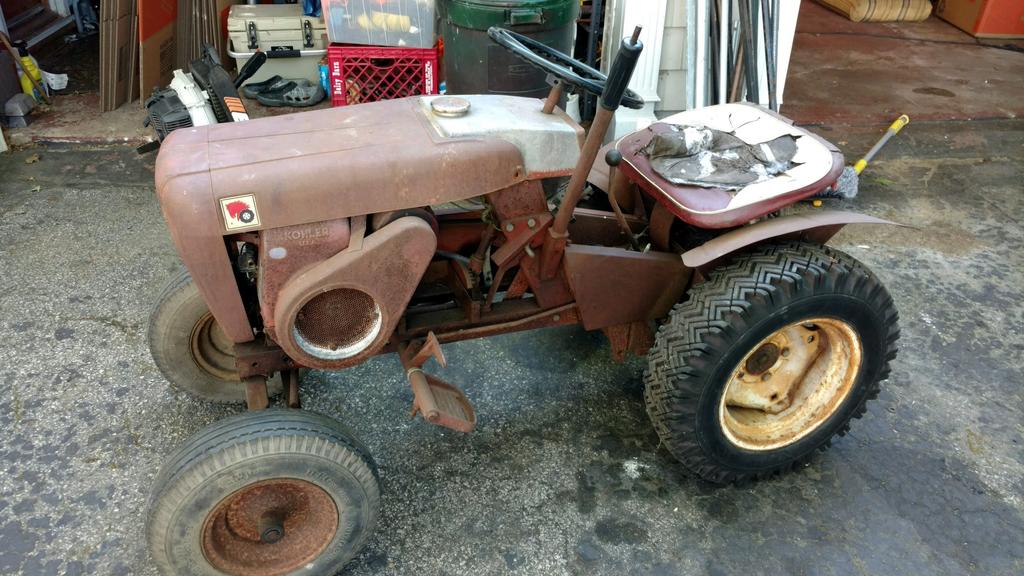

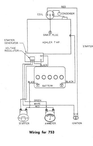

Elliot Garfinkel 166 #1 Posted July 8, 2019 Hi all just picked up a 702 and can use help with wiring diagram I have the manual but is their any place that has the color code,thanks elliot Share this post Link to post Share on other sites
pfrederi 19,264 #2 Posted July 8, 2019 welcome to red square. I couldn't find a color chart for a 702. however the year newer 753 has a very similar wiring system. I would imagine the 702 colors were the same. Share this post Link to post Share on other sites
Elliot Garfinkel 166 #4 Posted July 8, 2019 Thank you very much for diagrahm and fast response.trying to send pics but that might take awhile not that savvy. Elliot Share this post Link to post Share on other sites

The Tuul Crib 7,340 #10 Posted July 8, 2019 IMO all that tractor needs is to be cleaned up leave the patina like it is Service it all around and have fun! Nice looking tractor! Share this post Link to post Share on other sites
