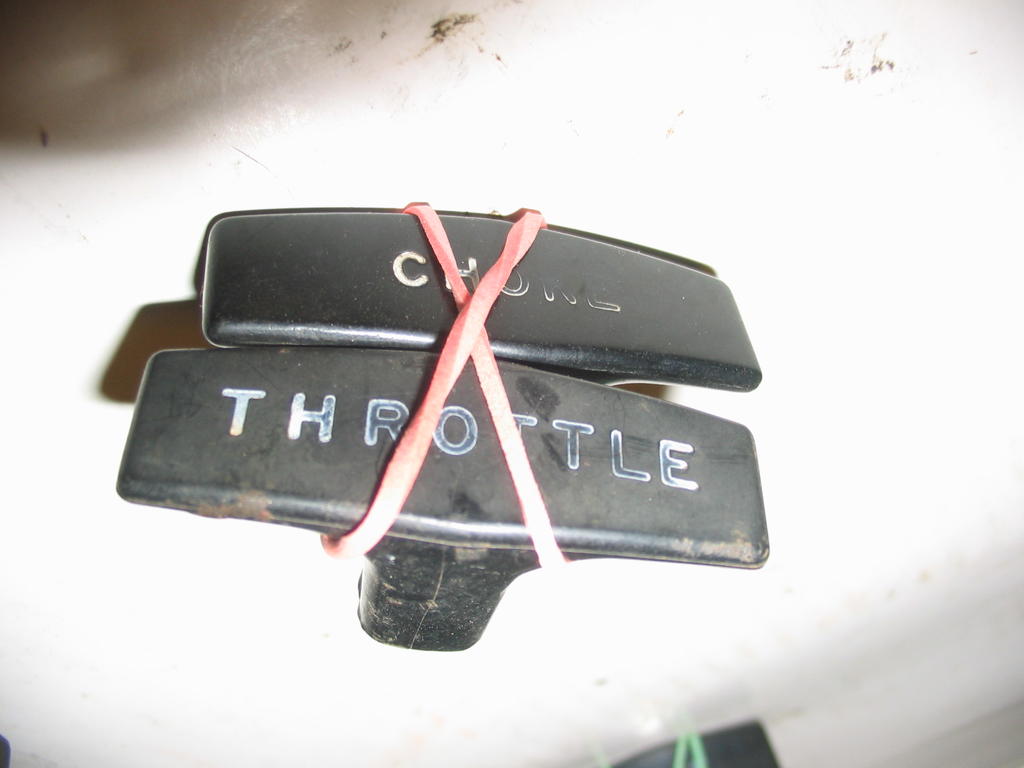

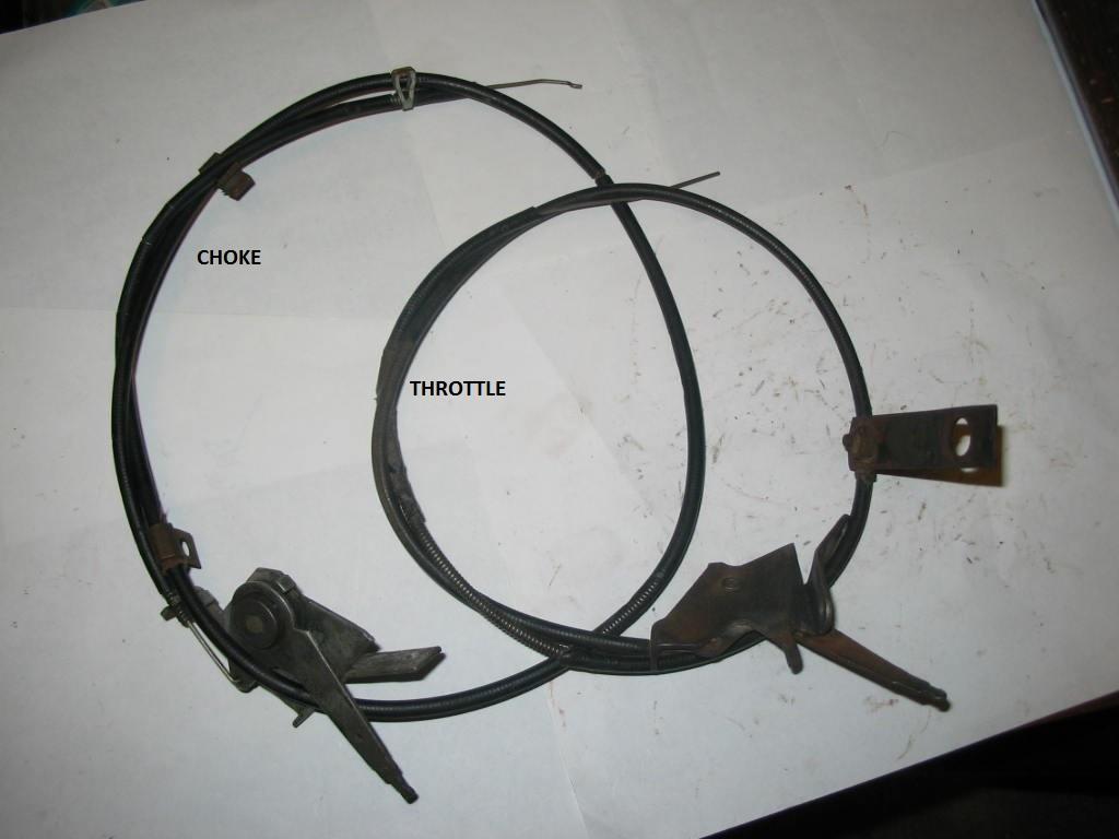

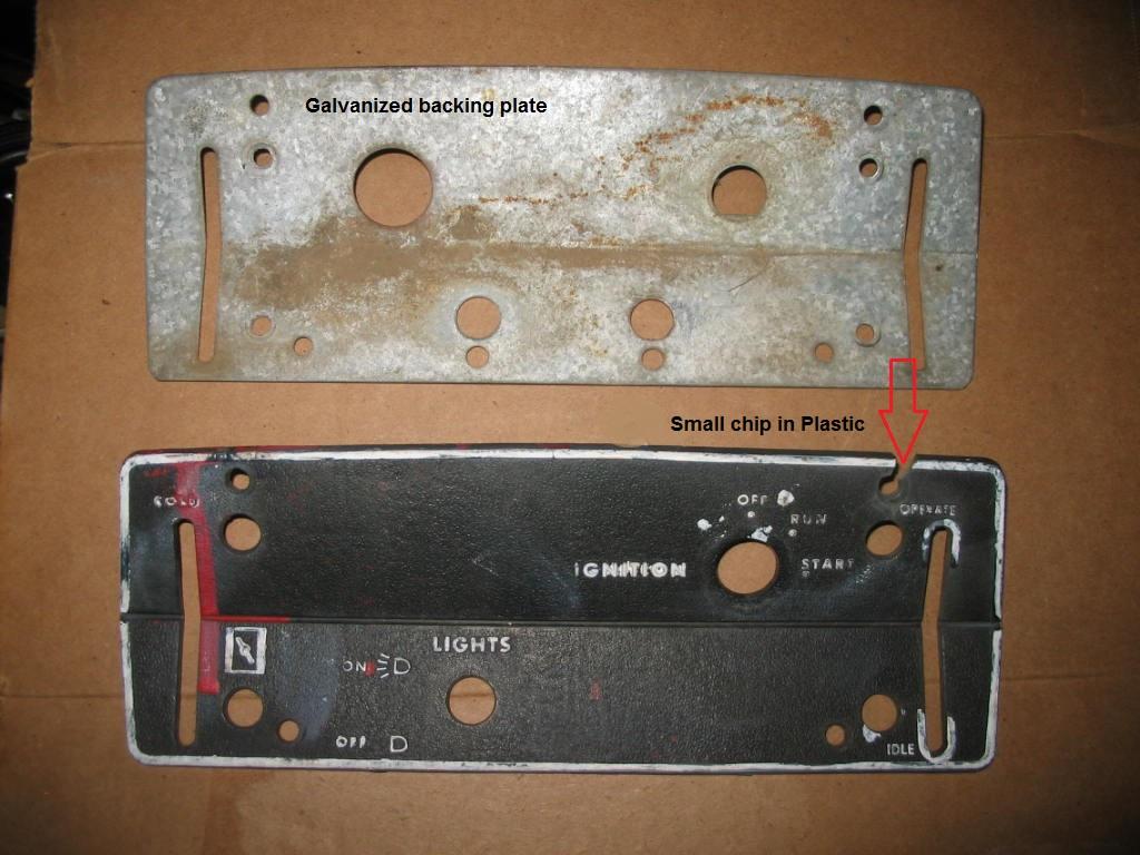

You'll need : 1) Slotted dash panel and metal backing plate. 2) Choke and Throttle Cables...trim to length. 3) Push-on slotted knobs for Choke & Throttle.  4)couple of stand-off clamps for the cables.  I can get you ALL of this...50 bux & 7 to sjip in USA.
NOTE... I don't have  pic of the THROTTLE cable, but it is the exact same style as this CHOKE cable (left side) ./.. but in reverse for the dash mounting on the opposite side (right side).
