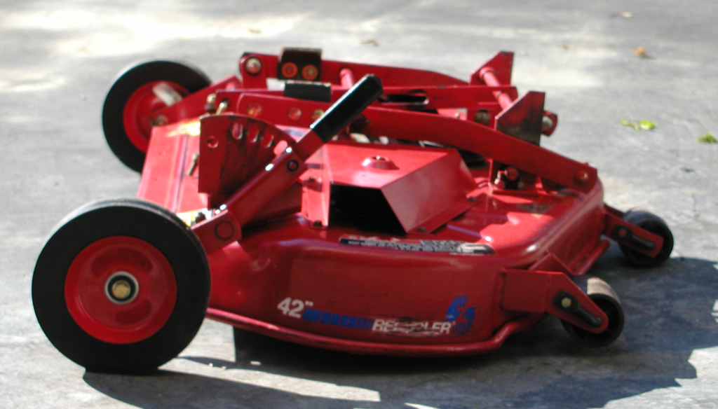

peter lena 8,583 #1 Posted July 7, 2019 recently replaced all bearings and seals on two 42 " r/d mower decks, they were getting noisy, picking them up used , but solid , zero rust. used 6203-2rs bearings and timken # 473380 grease seals, repacked spindles with lucas , red and tacky grease, also replaced the blade nuts. sharpened blades with a coarse and fine file , no impacts or damage , sharp and clean. added a spindle belt tension pulley on the back side of deck , to take out the belt bounce, very quiet and smooth. also scraped down and rustproofed both decks with chain and cable fluid , and heated them both up in the sun to dry. added martin deck wheels from t/s on rear of deck, and went after the proper adjustment setting to stabilize the deck. lubricated everything that has to move , especially the rear height adjustment handle rod, for easy height adjustment. both decks operate like new, very smooth and quiet , i just consider this to be regular maintenance. one of the decks is on my 82 black hood ,magnum swap, its so good you just have to love it. keep them going , its worth it , pete 4 1 Share this post Link to post Share on other sites

tunahead72 2,411 #7 Posted July 12, 2019 On 7/7/2019 at 4:44 PM, peter lena said: ... added martin deck wheels from t/s on rear of deck ... I'm shopping for larger deck wheels as we speak, do you have any details on the ones you use? 32 minutes ago, peter lena said: ... found it interesting that the idler pulley is usually the first to go into noise mode ... Interesting indeed. I replaced all my spindle bearings and mule drive pullies on one of my decks in the last year or so (it was time), and I still have some noise from the deck, I think it's exactly that idler, already have a new one waiting to be installed. Thanks for the tips! Share this post Link to post Share on other sites
peter lena 8,583 #8 Posted July 12, 2019 https://www.tractorsupply.com/tsc/product/martin-wheel-6x1-3-8-plastic-deck-wheel-1-2-in-bushing-1-3-8-in-offset-hub-1128205?cm_mmc=feed-_-GoogleShopping-_-Product-_-1128205&gclid=CjwKCAjw36DpBRAYEiwAmVVDMNZk2Lr8QI82g60d66dax_BARgl5IikN2rdrBuZgArecBmiOLVWyVRoCEHkQAvD_BwE these are the deck wheels that i have on my mower decks, great price and they really stand up , pete 1 1 Share this post Link to post Share on other sites

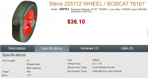

P3x 56 #9 Posted August 6, 2019 I have a 42 SDD, 42 Recycler, and 48 SDD. All cut too low for my liking no matter how I adjust them. So took the idea from others and got larger wheels made by Sten - 8 Inch. A little expensive but can cut at a height that helps to keep the grass green during the dry season. They're even the same color! 1 Share this post Link to post Share on other sites
