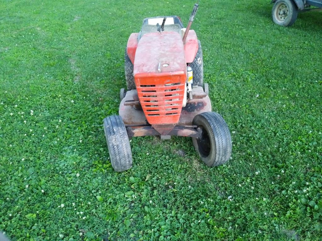

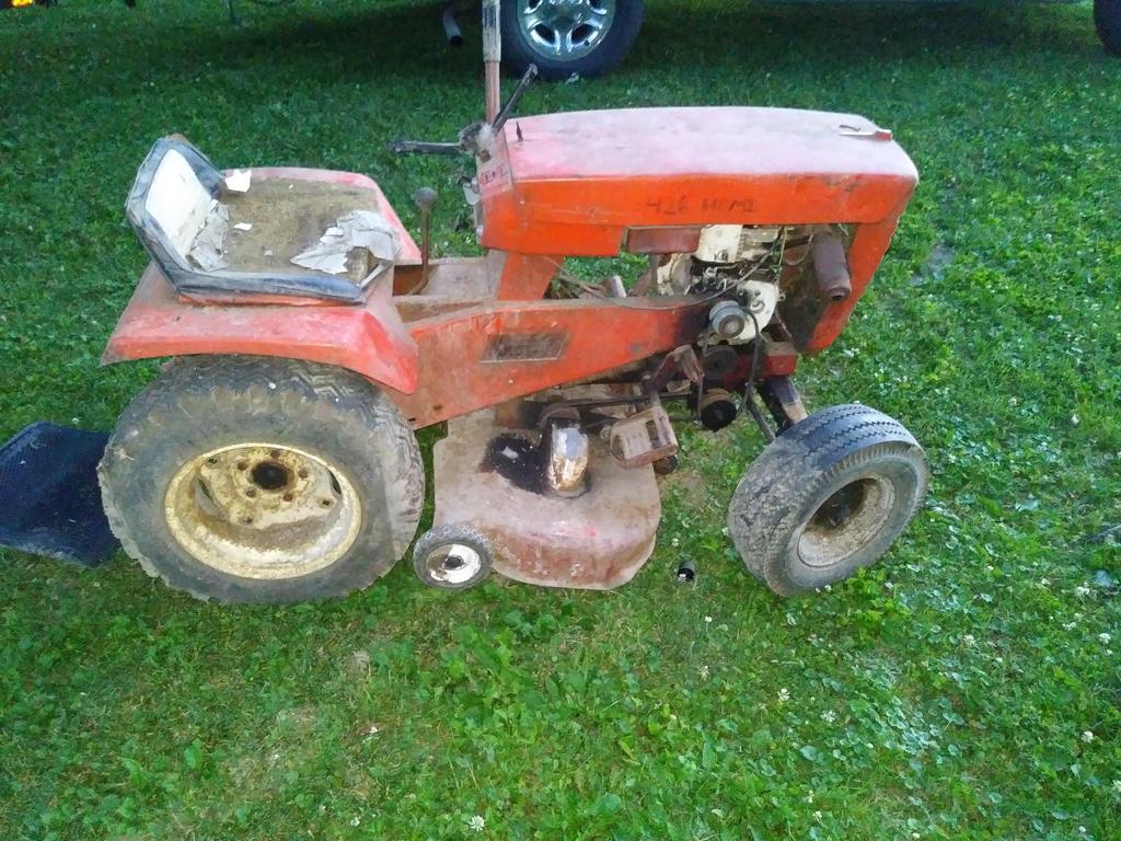

GetEmJohnnyBoy 14 #1 Posted July 5, 2019 Hey boys, I just inherited this Wheel horse and know nothing about them, yet. Is there any way I can get some identification on this Wheel horse? Its obviously not original and I Dont know what to look for but I want to restore it back to condition! I don't have enough room for more pictures sorry 1 Share this post Link to post Share on other sites

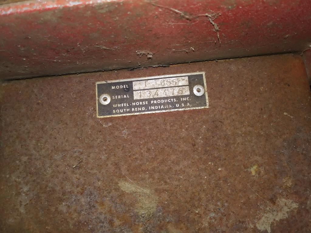

GetEmJohnnyBoy 14 #3 Posted July 5, 2019 Here are some more photos, I just found that tag. If someone could help me identify the year that would be amazing Share this post Link to post Share on other sites
gwest_ca-(File Mod) 11,160 #4 Posted July 5, 2019 Welcome to the forum. 6 = 6hp 5 = electric start (0 = recoil start) 5 = 1965 Already added your serial number to the list. Click on the picture Garry Share this post Link to post Share on other sites
AMC RULES 37,143 #5 Posted July 5, 2019 1965 Model 655... 6=6HP Tecumseh... 5=electric start... 5=1965. From the model list... 655 1965 Lawn & Garden Tractor 655 4-Speed Tecumseh H60-75117D 6 Wheel Horse 5049 1 Share this post Link to post Share on other sites

Sparky-(Admin) 21,664 #9 Posted July 5, 2019 Well according to the hood it has a 426 HEMI in there....she must be a race tractor ! Just kidding....and.... 1 3 1 Share this post Link to post Share on other sites

953 nut 56,426 #14 Posted July 5, 2019 Looks like a new steering wheel and a little TLC will make it a good looking . If you want a nice new seat cover @BOB ELLISON can fix you up with a nice one. 1 1 Share this post Link to post Share on other sites
GetEmJohnnyBoy 14 #15 Posted July 5, 2019 I just sent Bob a message. I wish it had the 426! That day was long gone lol. The motor is not original in it, its a pull start Briggs with a homemade air filter. I got it sputtering yesterday, the carb needs gone through and the gas tank replaced. I'm not sure how I'd remove rust from the interior of a gas tank. 1 1 Share this post Link to post Share on other sites
