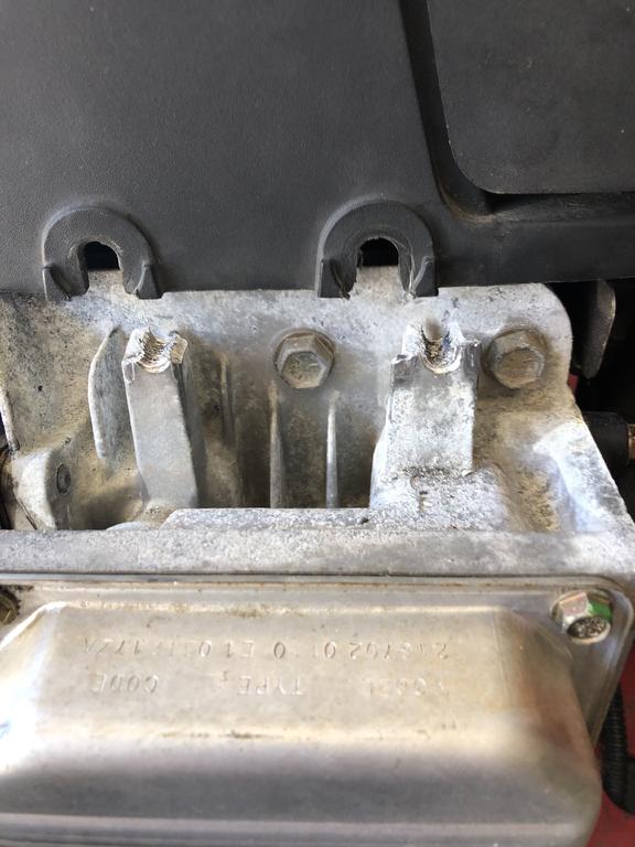

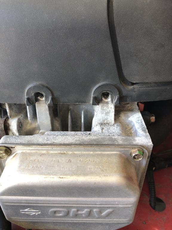

Go to start it today’s making sure everything’s nice and tight. Shroud pulls loose with a metallic clang.One of  the hole for the mount (that’s what I’m calling it) broke. This is part of the block, and the only way to secure the shroud.  There are two on each side of the engine. As o go to pull the shroud off, I see the pawls for the recoil start fall. My recoil start that got here Tuesday, has broken. 🤬
I take usable pieces off the old one (only problem was the spring) and replace. As I’m securing the shroud, again, the other mount on the same side breaks. They were part of the aluminum block.

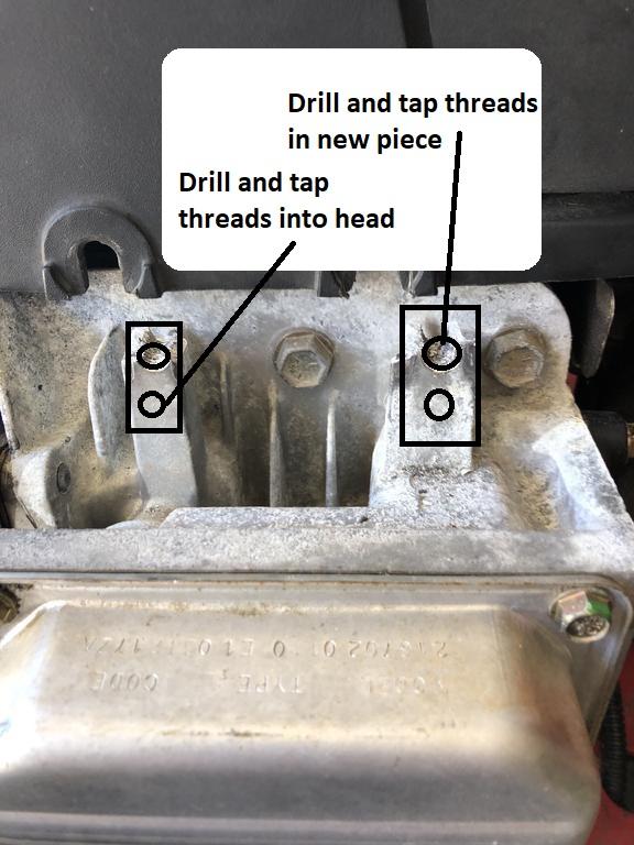

Off the top of my head, I would drill a hole in a piece of steel flat bar (and do this for each busted hole) and tap the holes so the original bolt fits and mount it into the original holes. With the flat bar hanging down below those original holes, drill holes through the flat bar and into the head just below the existing holes. Tap the hole into the head and enlarge the second hole in the flat bar so a bolt fits through it. Basically bolting on a piece to hold the shroud. Maybe one solid piece of steel instead of two separate pieces would allow for another bolt or 2 and nuts to hold the plastic????
That should be doable..
I was thinking a piece of steel bolted to the inside of of the plastic shroud, with holes for the bolts, that way it’s not those slots solely holding on.

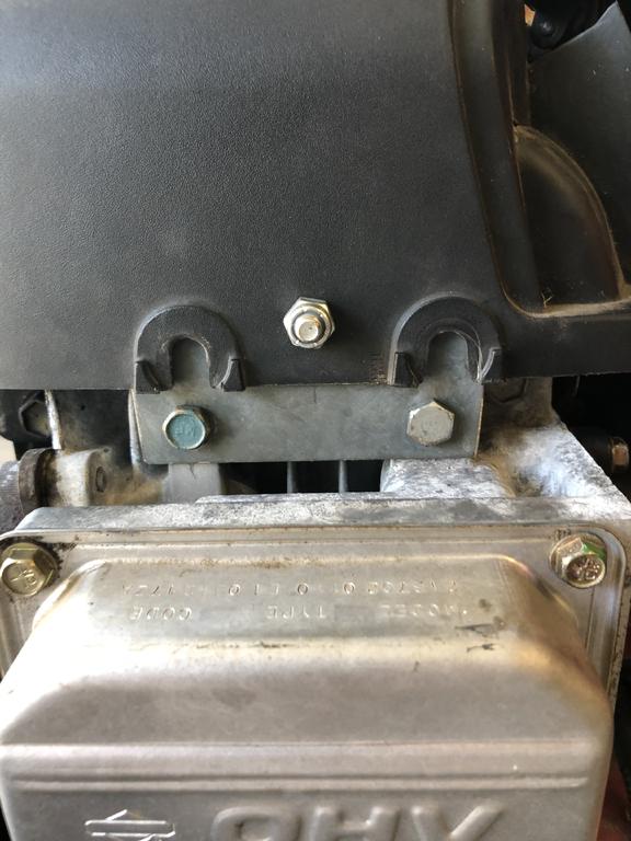

@wallfish, with your general plan, and a look around the shop, I got ‘Er done. (With some instruction provided by my FIL)

Maybe put a fender washer on that bolt holding the plastic to pinch more area of it
LengerichKA88
That’s not a bad idea
