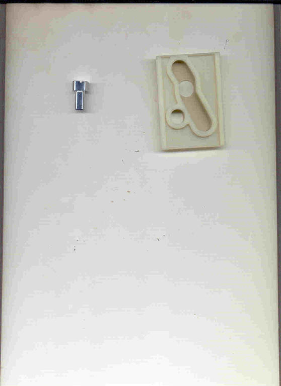

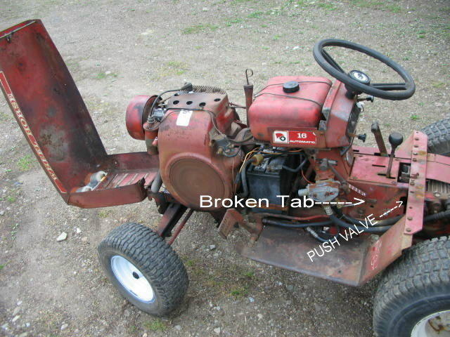

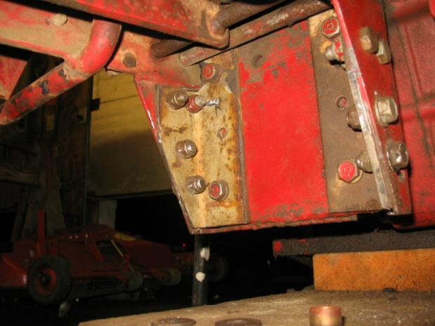

Me thinks you broke the NYLON CAM  # 5996,  But, something caused that to happen.  It MAY also be that the lock-down tab on the LEFT side is broken, causing the fricton contorl apparatus to fail.  OR... or...or...  it could be any one (or more) of several things.  Also look under the tractor and see if the FRAME PLATE is broken where it bolts to the transmission.  This is a repaired frame plate, but you'll know a broken plate when you see it...also very common.

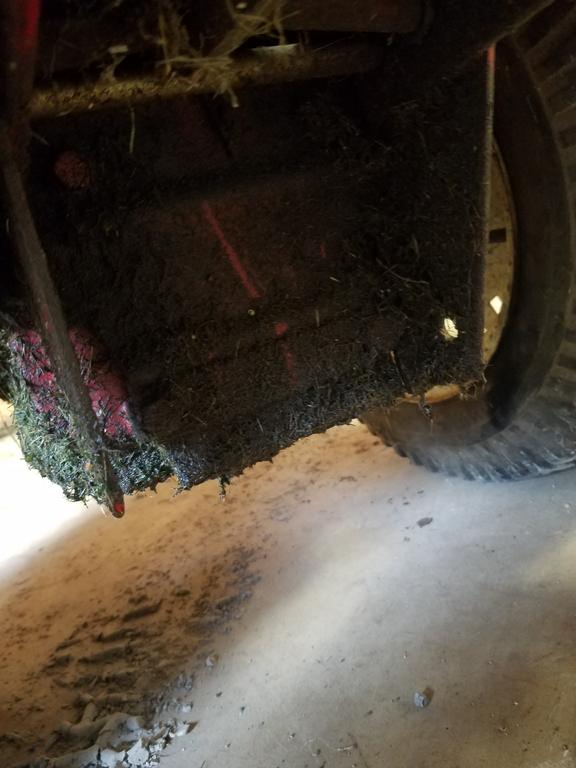

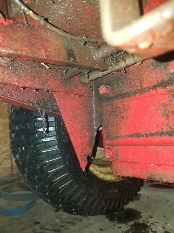

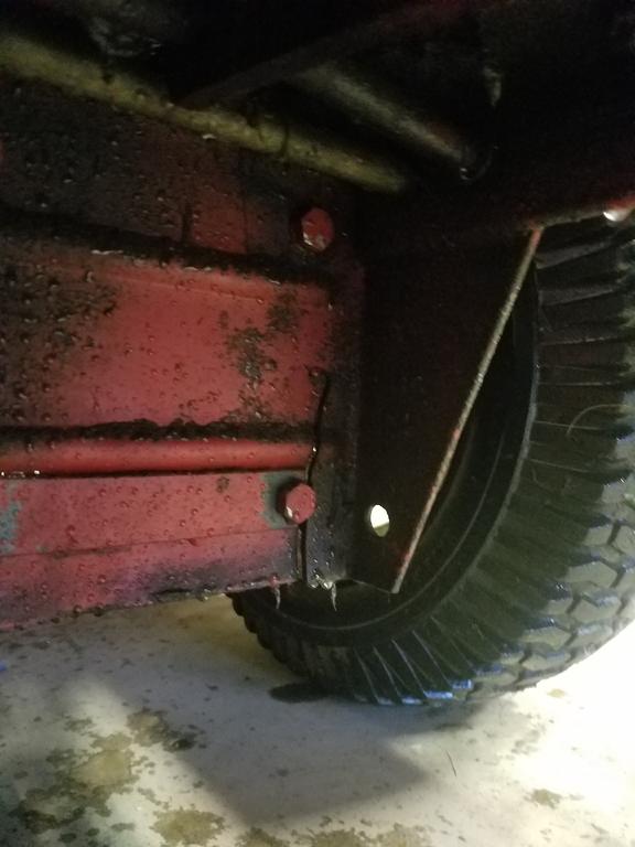

Autoc120
Thanks for the help it was a little of both. Frame is broke and it must have flexed enough to pop the shifter out of its guide. Guess I have some fab work to do

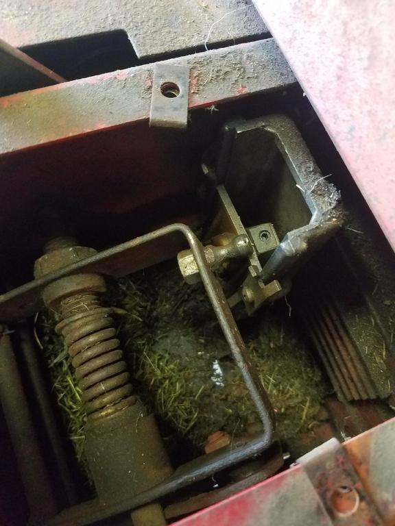

Better pic now

Yup your frame done broke. I had a similar issue years ago with a hydro. The little allen screw in your pic had backed out.
