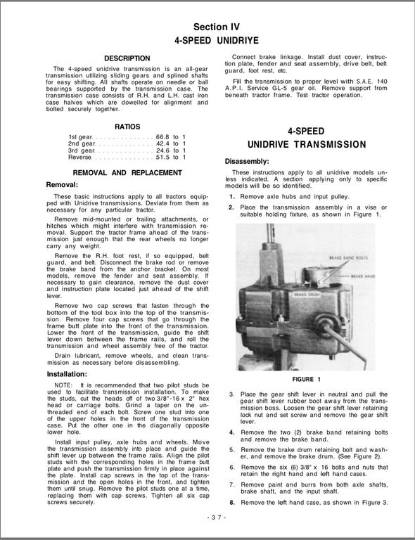

They actually take 140 weight gear oil. This is straight from the transmission manual. I found 140w at my local carquest.

Not to get into a big thing about the viscosity of oil to use in the transmissions, but I just want to point something out.  @3QTR40 is using the transmission manual to point out the 140 wt oil suggested in the Section III (4 speeds) section.  If you look at the Section II (3 speeds) section, it states using 90 wt.  All of you guys are correct, and temperature might play a role in what is selected.
I just want to point out the only difference between the 3 speed and 4 speed transmissions is what shaft the brake drum is mounted on.  All of the internal gears are the same except that the mushroom gear shaft is shorter and the cluster gear shaft is longer in the 4 speed.
So, we are all correct.   :occasion-xmas:
