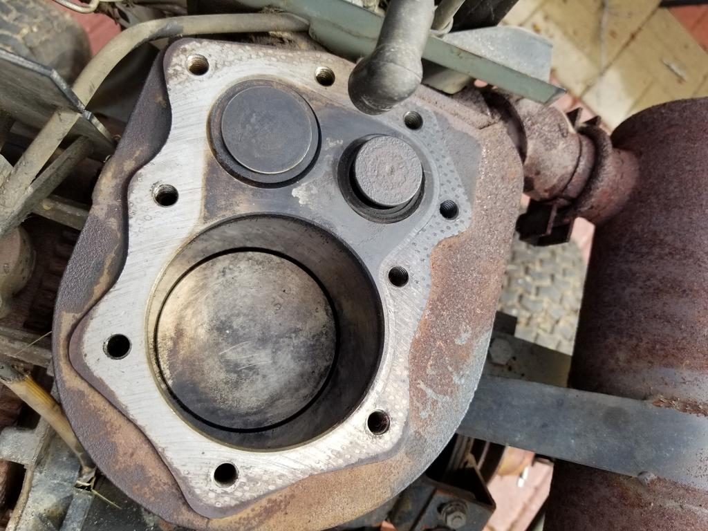

RedPaul 50 #1 Posted June 23, 2019 Does the timing on a Kohler magnum engine advace with engine RPM? The engine on my 312-8 starts instantly and idles smooth but as it revs the exhaust note changes to a popping sound and it loses power. It acts like it is going out of time or a valve is sticking. When it starts to 'pop' you can feel a puff coming back out of the carborator with the air cleaner off. I have pulled the head and the valves are clean, move like they should, (at least when spinning by hand) and seem to seat well. This engine has run sort of strange strange since I got it about a year ago (kind of a stutter exhaust note), I just used it to pull a little wagon so was not to concerned. Now I have it up at my new house in Northern Mich to cut about 1/2 acre of flat lawn, This is the first time I have really put a load on it and there is a real lack of power, as in pretty much usless for mowing. When I got the tractor I cleaned the head, top of piston and valves and changed the fuel lines and filter, I checked the fuel shutoff valve today and the screen was kind of mucky but I cleaned it up. Any Ideas would be appreciated, Share this post Link to post Share on other sites
