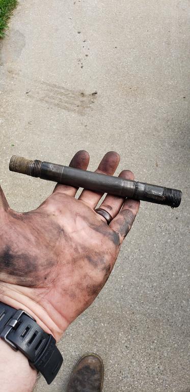

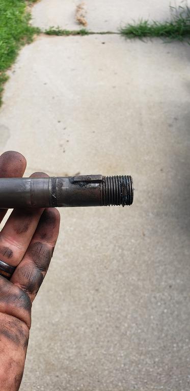

Khill3253 2 #1 Posted June 17, 2019 (edited) Hi all, I was recently gifted a C145 from a buddy. It has a 48" deck on it. One of the spindle shafts is stripped out. And i am having some trouble finding the right part for it. The shaft has a notch on it that the pully locks into. If anybody can point me in the right direction that would be awesome. Edited June 18, 2019 by Khill3253 1 Share this post Link to post Share on other sites
Stepney 2,356 #2 Posted June 17, 2019 That's a woodruff key, it'll pry/hammer out with a little effort. If you can get us the model number off the deck, we can easily help you find another. I have a pile of spindles up in the shed if someone else can't help you with a brand new one or another used. 1 Share this post Link to post Share on other sites
Khill3253 2 #3 Posted June 17, 2019 (edited) Copy. I just grabbed it and it pooped out. I cant find anything with the model number off the deck. There are only 2 stickers left on it and neither if them have anything. All the stickers are on the motor with the model numbere, etc. But nothing on the deck. I do know it is a 48 in. nd the mower is an 81. Edited June 17, 2019 by Khill3253 Share this post Link to post Share on other sites

gwest_ca-(File Mod) 12,484 #5 Posted June 18, 2019 Has to be one of these decks. 1977 model 75-48MS02 - (First deck to use blades with 3/4" center hole) 1978 model 85-48MS01 1979 model 95-48MS00 1979 model 95-48MS01 1980 model 05-48MS01 1981-1983 model 05-48MS02 1984 model 05-48MS03 1985 model 05-48MS04 1986-1988 model 05-48MS05 1987-1988 model 05-48SC01 1989 model 15-48SC01 1990 model 15-48SC02 1991-1992 model 15-48SC03 1993-1997 model 78360 1998-2007 and 2009-12 model 78361 - These all use blades with 3/4" center hole Click on the fuzzy picture and again on the page that comes up. Spindle looks different so may be wrong one. Garry 1 Share this post Link to post Share on other sites

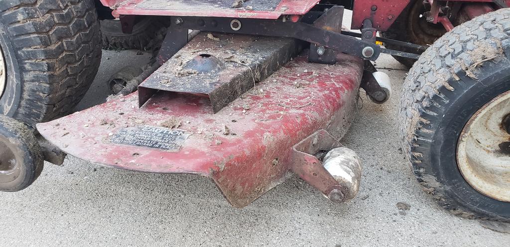

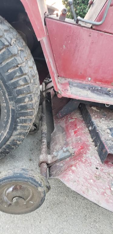

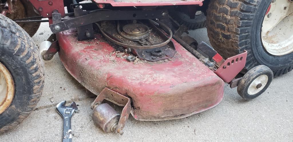

Khill3253 2 #6 Posted June 18, 2019 Here are some more pics of the deck and bonus snowblower he gave me that seems to be locked up but is a project for another day. Share this post Link to post Share on other sites
Khill3253 2 #8 Posted June 18, 2019 This one seems to look real close after some digging. https://rover.ebay.com/rover/0/0/0?mpre=https%3A%2F%2Fwww.ebay.com%2Fulk%2Fitm%2F333164863266 1 Share this post Link to post Share on other sites
gwest_ca-(File Mod) 12,484 #9 Posted June 18, 2019 The earlier decks used spindles with an odd 6203 bearing with a 3/4" ID x 40mm OD x 12mm deep. Bearing numbers 106084 and 106085. The number of seals being the difference. The last design used bearings that are all metric. 17mm ID x 40mm OD x 12mm deep. Bearing number 109966. That should identify which you have. I can not tell which bearings were used with the 105193 spindle. You can eliminate the Woodruff key at the top for the pulley as long as the pulley will spin freely on the shaft. File off any nicks so it can spin. Then use a regular spring lock washer and regular nut replacing the Nylock nut that was on it. The natural direction of rotation will keep it tight. Coating the spindle and pulley with never seize will make it easier to get apart next time. This is how the last design went together and there is a service bulletin suggesting this could be done on the older version. Garry Share this post Link to post Share on other sites
peter lena 10,047 #10 Posted June 18, 2019 khill3253, those woodriff keys shoulder out in the setting, to prevent a loose fit, a small chisel direct hit on the horizontal base of it will get it out. also i would recommend using the LUCAS RED n tacky grease OR SIMILAR, with a high flash point. recently replacing bearings and seals on decks found , liquefied grease , causing failure of bearings. glad you found us , lots of answers to your problems , pete Share this post Link to post Share on other sites

gwest_ca-(File Mod) 12,484 #12 Posted June 18, 2019 Looking for the 105193 shaft came across this assembly that is still available. It uses metric bearings with the 17mm ID 110172 replaced by 111726 https://www.partstree.com/parts/toro/parts/111726/ This site shows 110172 available for $115. http://www.psep.biz/index.htm May be worth giving them a call to confirm parts and price if it will work. Garry Share this post Link to post Share on other sites
daveoman1966 3,884 #13 Posted July 5, 2019 I have the spindle shaft you are looking for... it is on Ebay at item # 133093012851. Have a look, if you've not already got a replacement. This one has a BIG nut on the blade end and that is the ONLY difference. These shafts are completely interchangeable.... 42 & 48 " decks. 1 Share this post Link to post Share on other sites
