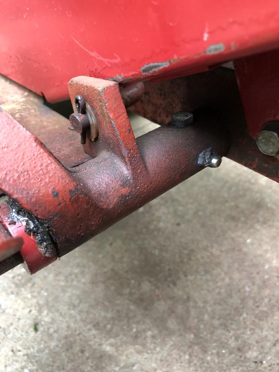

Picked up an old 312-8 that probably has been outside for 5 years. Almost ready to use. One of the last things is the brake pedal doesn't return to the normal position after use. Believe it's just the one spring on the lever but also greased the brake pedal.  So ordered a new spring but Iit doesn't appear that bad. Is there anything I'm missing?

Could it be that the brake pedal has rust on the shaft and the spring can’t can’t over come the friction.  I would spray lube or remove it and clean the shaft up

The brake crosses over on another shaft it's bolted in from the left side with a tab. You may have to remove it there are two bushing in the tube that crosses over. Could be rust in there.

That could be it. After I greased it and it sat in the sun, it appears to be looser but we'll see if it is loose enough!  I am reluctant to pull that whole shaft apart!
