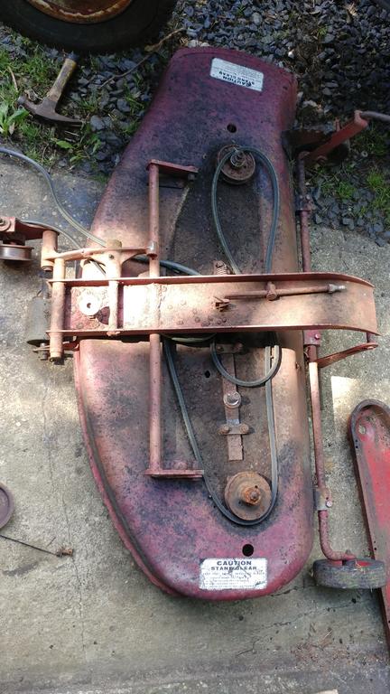

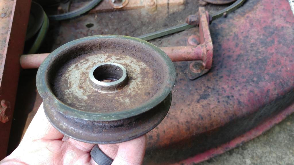

boondockboost 34 #1 Posted June 14, 2019 I dug my raider 12 outta the weeds today and got her running again after about 2 years. I was mowing the yard with it and I broke the tensioner pulley for the blades. I was searching around and couldnt find a match so I figured id ask. Its a 36in side discharge deck. The pullley seems to be 3/8 mounting hole 3 -3/4 tall 3/4 inside belt dia. (The center bearing is not in the pulley) Share this post Link to post Share on other sites

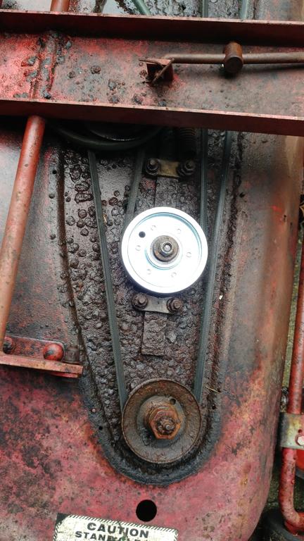

gwest_ca-(File Mod) 11,846 #3 Posted June 14, 2019 Dave I think he needs the flat idler on the deck. Might be this one Flat idler pulley - 3.750" OD - 3-3/4" - WH 6719, 112425, 519567 replaced by 92-7101 Napa 7-05207 with flanges, Stens 280-099 Std Flat OD 3.250", Stens 280-578 replaced by 280-114 HD Flat OD 3.250" No picture Garry Share this post Link to post Share on other sites

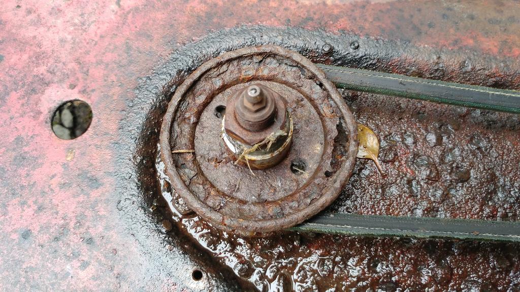

boondockboost 34 #4 Posted June 22, 2019 Well the pulley nunbers you have worked great everything is back together . only issuse know is I noticed the pulley for the blade seems to be rotting out. Is this a common oulkey to find? Or is it gunna be a treasure hunt? Share this post Link to post Share on other sites
