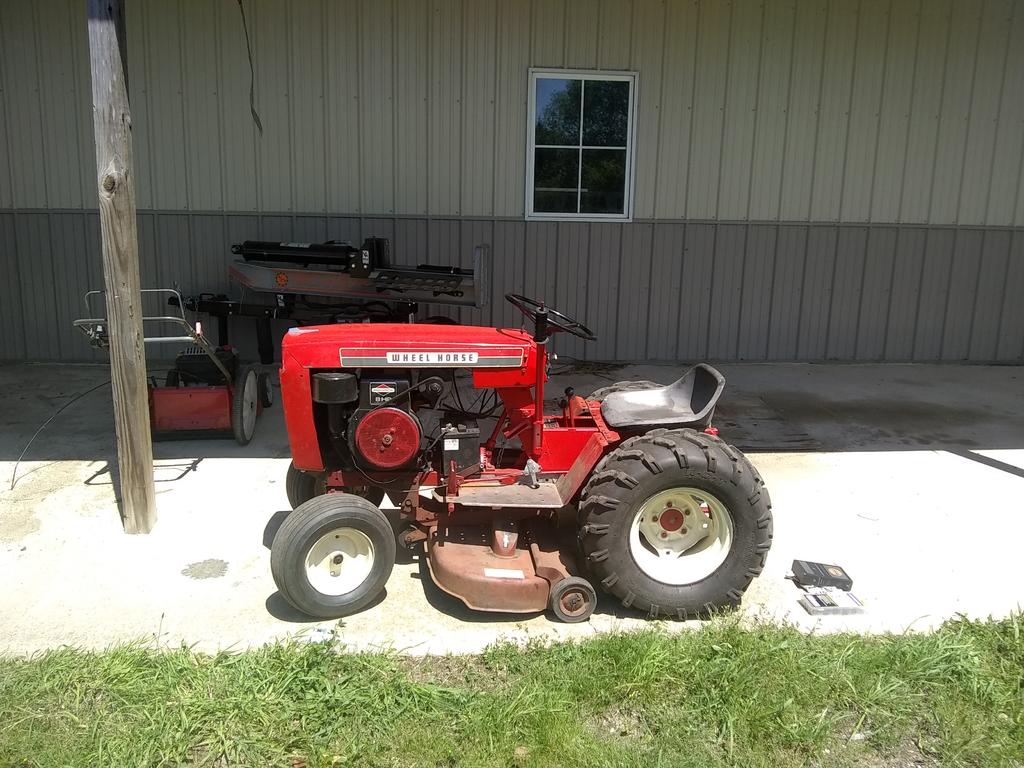

(30 ton log splitter in the background that I used)
If you look closely, you can see it has an un-original Briggs and Stratton 8 horse engine.
Model# 190432
Type# 5535-01
Code# 88081510
As you can see I need the Raider 10 Raider 12 manual along with a set of Raider 10 decals.
The model # on the body is..
Model# 1 6041
Serial# 577983

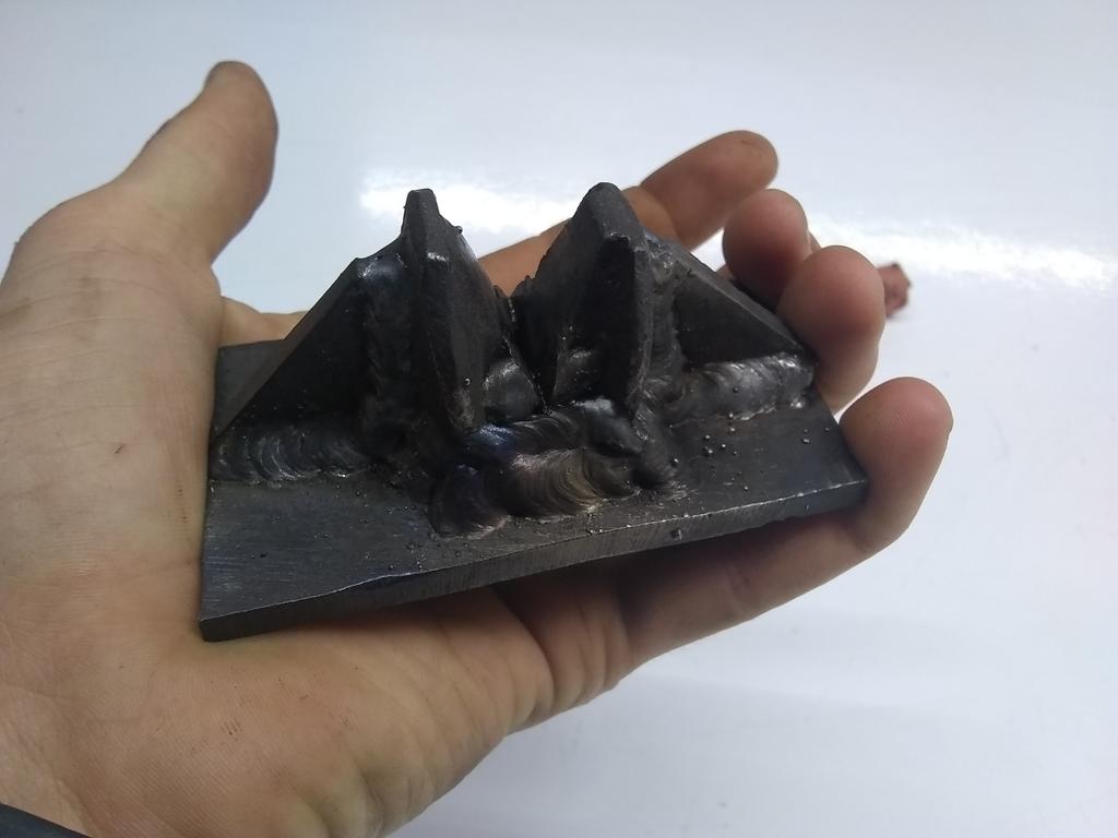

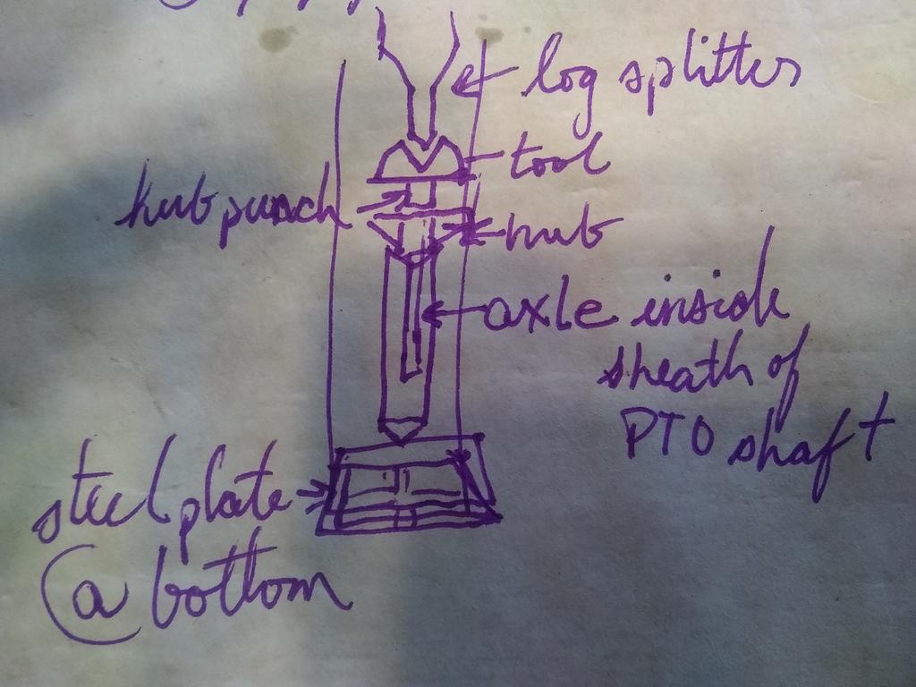

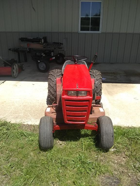

I've cosmetically restored the rims, frame etc. everything but the running boards, engine, hood, mower deck, brackets and fenders. The tires are ATV and gained me 11" of circumference and 3 ½" diameter on the rear, so the original fenders won't fit. I also had a hard time removing one of the hub's, neither my three jaw puller nor my hub puller were even trying to work on it. In the act of removing it, I pounded so much that I accidentally popped the snap ring off the axle on the other side of the transmission. So I wound up tearing into the transaxle fixing the problems. But the offending hub was still holding on despite multiple applications of penetrating oil!!!
So I welded up a piece, using the heads off of two railroad spikes on ¼x2x4" steel plate to use as a ram in our 30 ton log splitter which finally worked, thank God! IMG_20190614_135004567.jpg.ab2f5f57a6141dd95eda15d0566daaf4.jpg

@jkosackuk :text-welcomeconfetti: and nice work!  You might be able to use blocks to lift the fender over those awesome tires, they remind me of @19richie66‘s GT-14!
