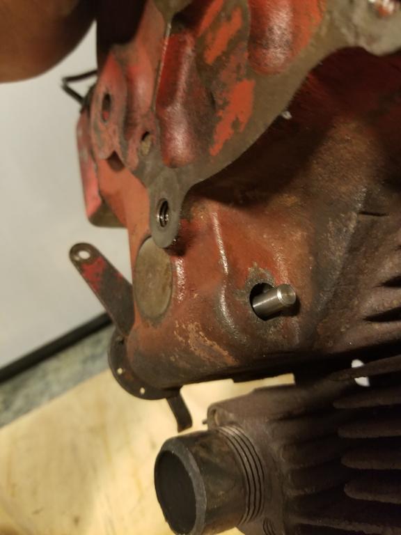

Koby 0 #1 Posted June 5, 2019 (edited) I am reassembling the motor and it's been awhile. I put new governor and new cross shaft the side that is opposite of the brass fitting is that supposed to have a fitting I have the shaft coming out of that side with play and in my parts and memory I dont remember punching anything out there and cannot find anything online Edited June 5, 2019 by Koby More info Share this post Link to post Share on other sites

Racinbob 11,398 #3 Posted June 5, 2019 This looks to be on the opposite end of the governor shaft than what I was dealing with. The parts manual shows it as #234866 bearing. I wasn't aware that it could be seen from the outside of the case but I never looked. I'll verify later this morning. Share this post Link to post Share on other sites
Koby 0 #4 Posted June 5, 2019 Thank you very much I just ordered one up Share this post Link to post Share on other sites
Racinbob 11,398 #6 Posted June 5, 2019 By any chance do you have the spec # for that engine? There are quite a few variations. The part # I posted was for a spec 30629D in the 1976 parts manual. Share this post Link to post Share on other sites
Racinbob 11,398 #7 Posted June 5, 2019 By golly, that is accessible from the outside of the block. It would be a good idea if @pfrederi chimed in here. 1 Share this post Link to post Share on other sites
