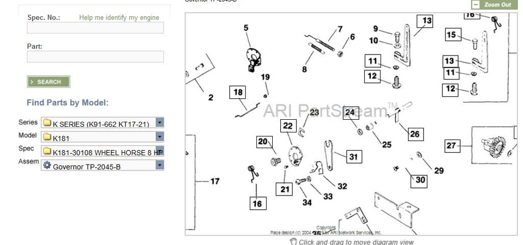

Racinbob 11,398 #1 Posted May 28, 2019 I've had a wanted posting running a few days but I'm still in a pickle. I need a bushing for a Kohler governor (model & spec in picture). It's item #25 in this diagram. There's no part # anywhere. I know the ID is 7/32" and Garry informed me that he found 5/16" in one of his IPL's. I don't know if that's length or OD. In any case I need the 3rd dimension. It looks like I'm going to have to find a bushing and cut it to length. Does anybody have one of these apart and measure for me. The picture is fuzzy but it slips on the governor shaft, then a washer and then the external parts. I'm at pretty much a standstill on my 854 due to this. Thanks for any help. Kohler Governor.pdf Share this post Link to post Share on other sites

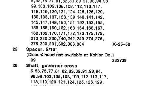

pfrederi 18,108 #3 Posted May 28, 2019 You are not supposed to have #25 Note there is no box around the number.... 1 Share this post Link to post Share on other sites
pfrederi 18,108 #4 Posted May 28, 2019 (edited) There are hundreds of spec #s for K181 I found only 3 that use that part. Variation 99 One for Chamberlin Metal products and 2 for Allis Chalmers Part number for what is worth is 232739 Edited May 28, 2019 by pfrederi 3 Share this post Link to post Share on other sites
953 nut 56,609 #5 Posted May 28, 2019 (edited) I just checked my NOS Kohler stash and don't have that part number, but there is one on and the price is reasonable. https://www.ebay.com/itm/KOHLER-SPACER-232739/401054444572?hash=item5d60b52c1c:g:jOsAAOSw3xJVanUq Edited May 28, 2019 by 953 nut fat finger 1 Share this post Link to post Share on other sites

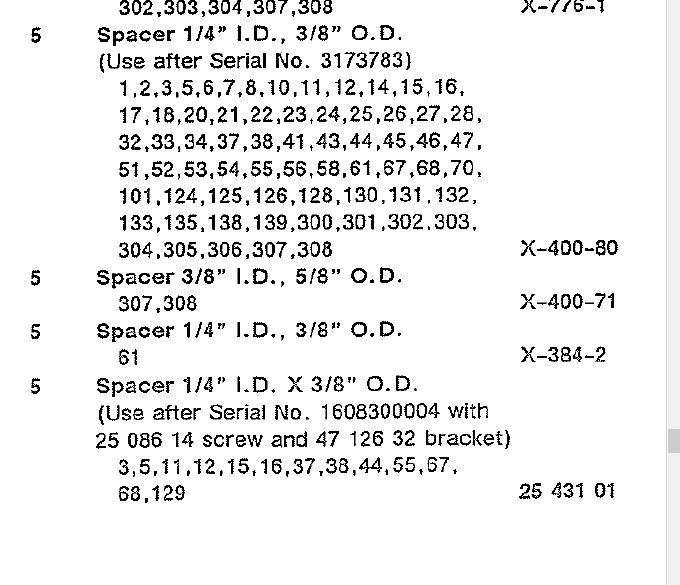

pfrederi 18,108 #11 Posted June 2, 2019 From the 301 parts manual. Several different sizes/types were used. 1 Share this post Link to post Share on other sites
Racinbob 11,398 #12 Posted June 3, 2019 Odd that your list says the X-400-80 is 3/8" OD. The one I received was 1/2"......BUT, the original Kohler packaging did have a cut in it so there's no way I could be certain that it was the right part in the package. Gotta love Ebay……. 1 Share this post Link to post Share on other sites
