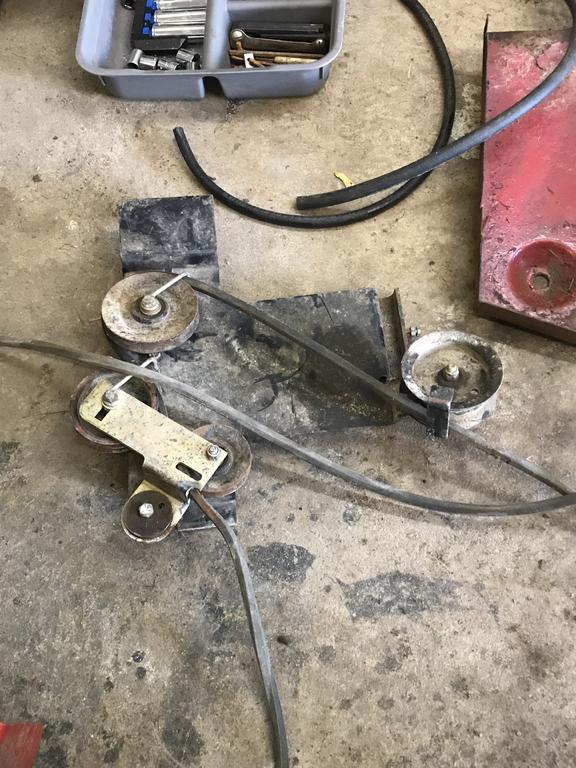

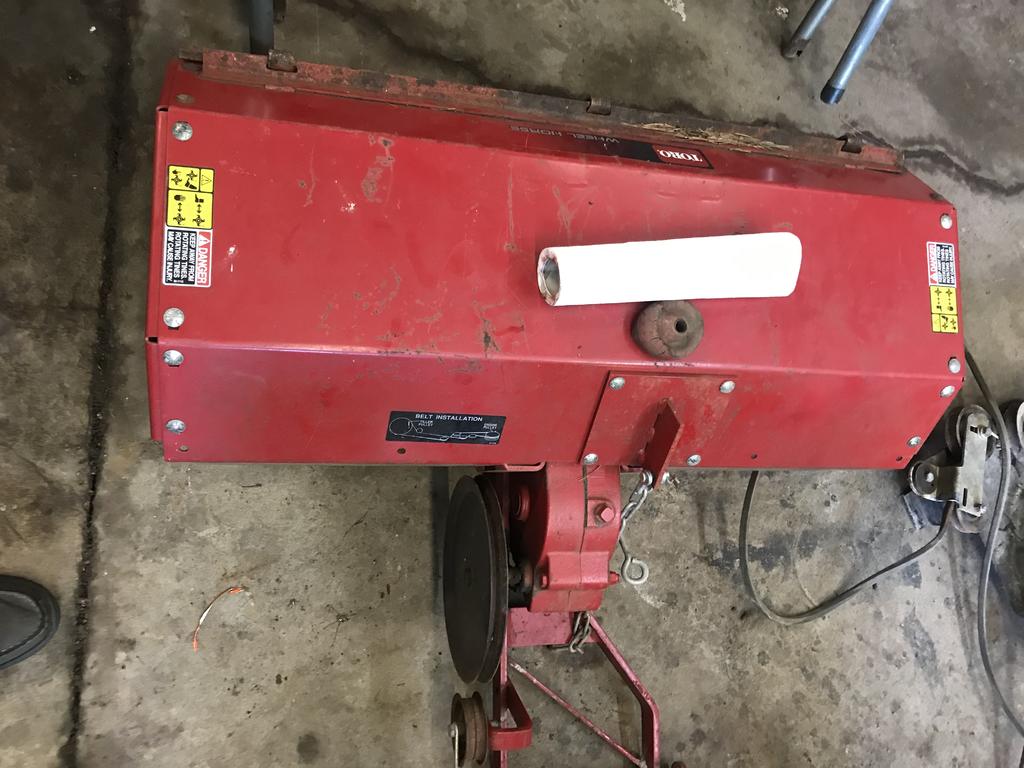

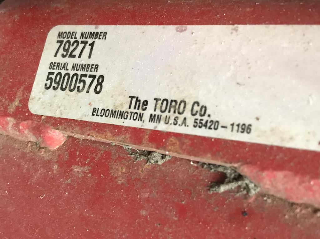

My neighbor just bought this tiller and a snowblade for $250.   He showed me today.   I never saw this model tiller before!   Looks like a regular Wheel Horse horizontal motor hook up tiller but has a mule drive/ mid-attach system for a vertical motor setup.

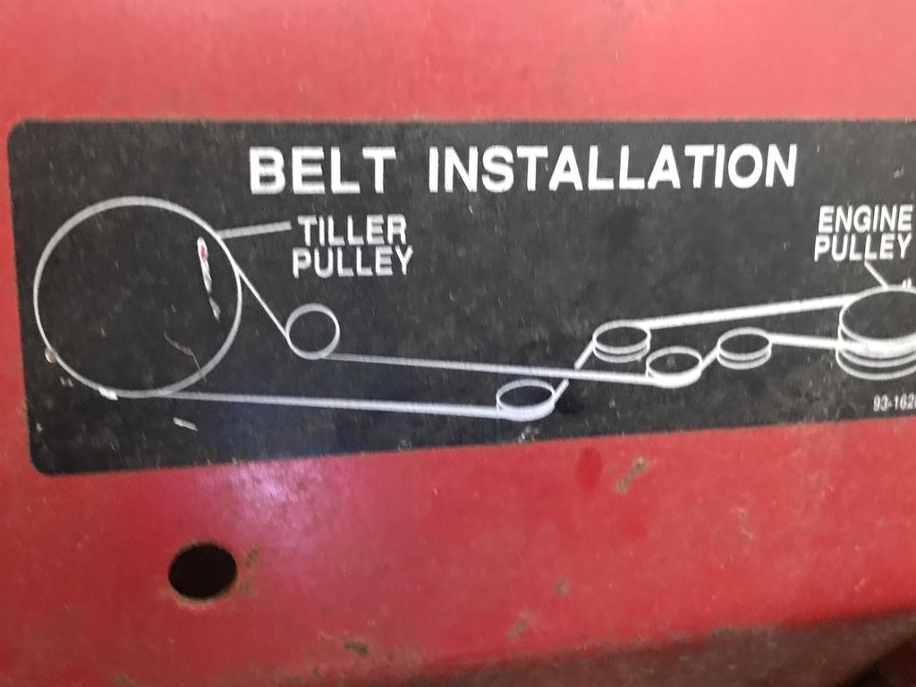

The drive belt for this looks to be longer than the regular horizontal tiller drive belt too.   Just thought I would post this as maybe a new item for others!

That is for the 26x series lawn tractors...

Yes but will the tiller alone work on a horizontal motor wheel horse?
WVHillbilly520H
That I cant tell you for sure, but does look like any other :wh: tiller minus the the mid tach idlers.
All that is needed is a lift mechanism and a drive belt routing system. A bit of ingenuity and anything can be done.
c-series don
Yes that will work if you on a C-series if you have the pulley set up that goes in the mid-mount tach-a-matic.
