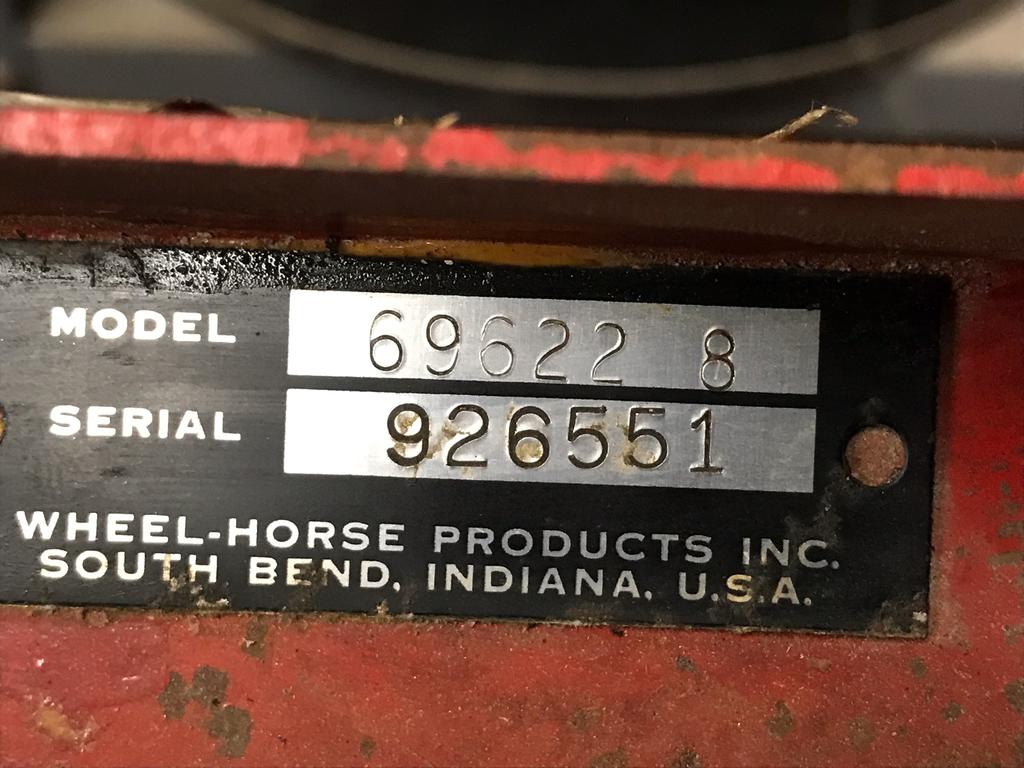

McGrew 460 #10 Posted May 21, 2019 (edited) Dadof2, I also have a 71 Raider 10. My Dad bought this tractor new, and I have the dozer blade he bought a few years after the tractor. I used it as a kid, and have had it on once since inheriting the tractor, so i know it fits. It is a little hard to see, but the model # is 69322-8. Danny Edited May 21, 2019 by McGrew More info Share this post Link to post Share on other sites
gwest_ca-(File Mod) 11,190 #11 Posted May 22, 2019 15 hours ago, McGrew said: Dadof2, I also have a 71 Raider 10. My Dad bought this tractor new, and I have the dozer blade he bought a few years after the tractor. I used it as a kid, and have had it on once since inheriting the tractor, so i know it fits. It is a little hard to see, but the model # is 69322-8. Danny Think the model number should be 6-9622-8. Click on the picture Garry Share this post Link to post Share on other sites

McGrew 460 #13 Posted May 22, 2019 Garry, you are absolutely correct on the part number. The pic wasn’t very good, and my eyes aren’t what they used to be... New pic attached. Danny Share this post Link to post Share on other sites
