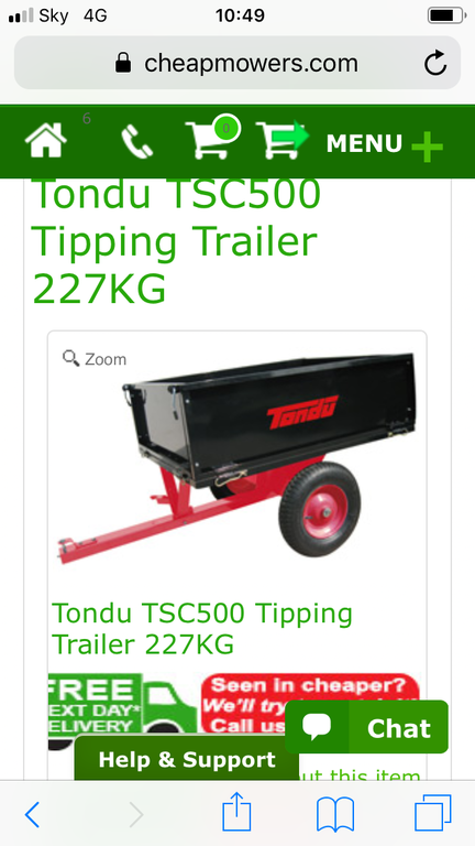

Felix 145 #4 Posted May 13, 2019 This is what I’ve bought. I hope it can pull it😬 Share this post Link to post Share on other sites

Lee1977 6,894 #15 Posted May 13, 2019 That is a trailer raited for 500#. I don't think you could have any problem with that weight. Share this post Link to post Share on other sites
