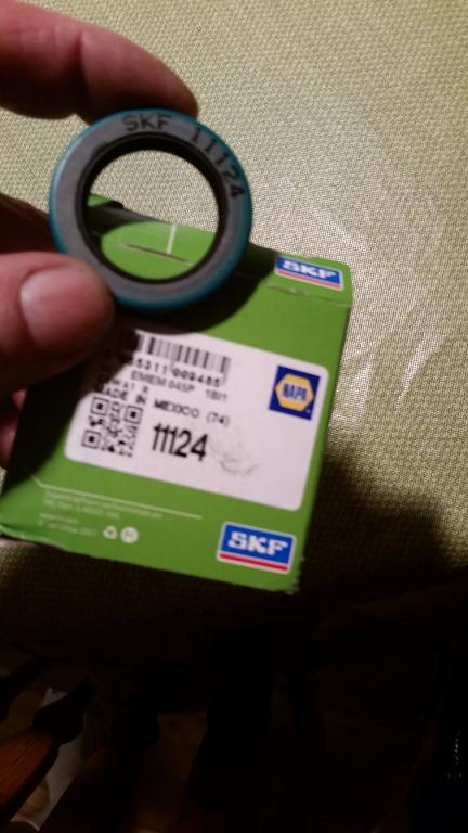

fourwheels0 191 #1 Posted May 10, 2019 I got a seal for my 520h and I believe it's the wrong one. I got part #11124. What is the part number for the thicker seal?. Share this post Link to post Share on other sites
WHX?? 49,168 #2 Posted May 10, 2019 Guess I don't know what your saying about the thicker seal but I use a 11124 SKF seal from NAPA. Works fine lasts a long time for me. Installation issues perhaps we can help out with? 3 Share this post Link to post Share on other sites
JAinVA 4,621 #3 Posted May 10, 2019 Seal number is 6449. 1 Share this post Link to post Share on other sites

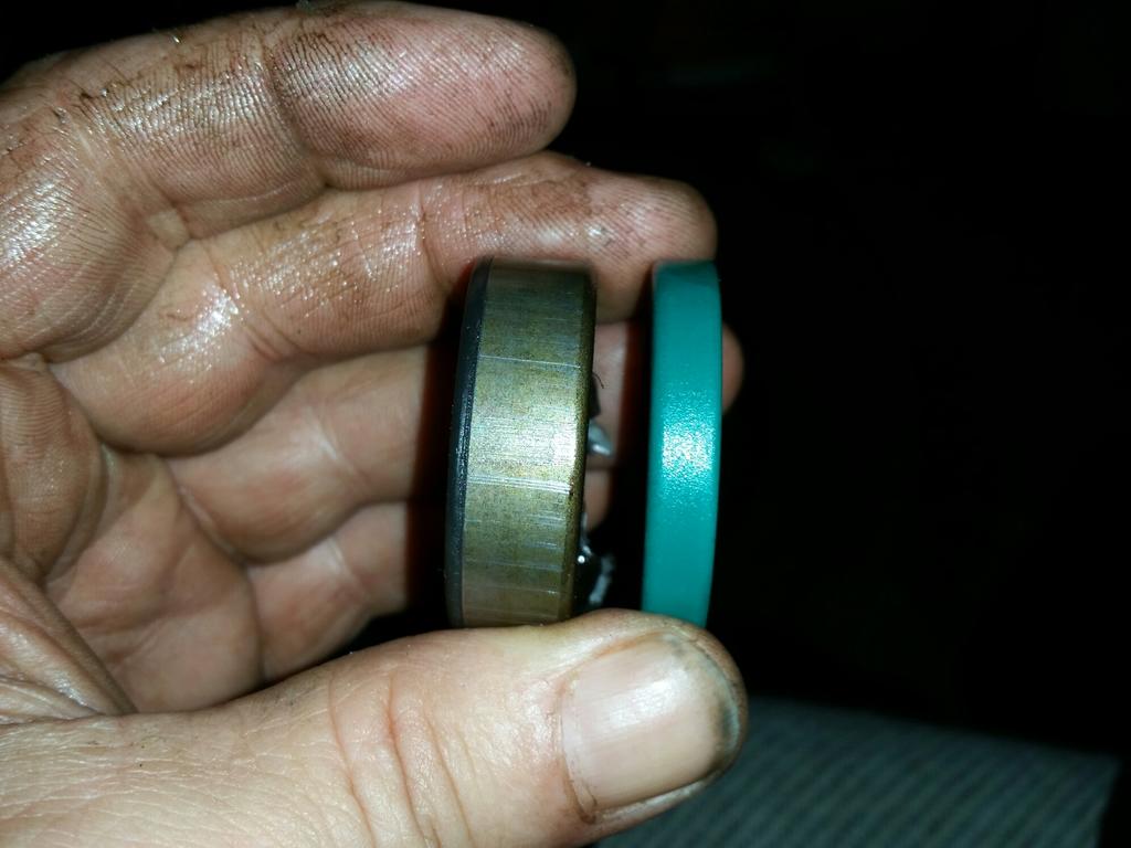

fourwheels0 191 #4 Posted May 10, 2019 The stock seal I took out is twice as deep as the #11124 seal. Share this post Link to post Share on other sites
JAinVA 4,621 #5 Posted May 10, 2019 The seal for this application is of single lip construction.One elastrometric element with a metal mount.Put in what you have and it will work. Share this post Link to post Share on other sites
gwest_ca-(File Mod) 11,096 #6 Posted May 10, 2019 1997 hydro transmission https://www.partstree.com/parts/toro/parts/6449/ Garry Share this post Link to post Share on other sites
fourwheels0 191 #7 Posted May 10, 2019 34 minutes ago, gwest_ca said: 1997 hydro transmission https://www.partstree.com/parts/toro/parts/6449/ Garry Thank you. That's what i'm looking for. Share this post Link to post Share on other sites
pfrederi 17,881 #8 Posted May 10, 2019 The 11124 will work just fine. modern seals are thinner than they used to be. 1 Share this post Link to post Share on other sites
WHX?? 49,168 #9 Posted May 10, 2019 12 hours ago, fourwheels0 said: The stock seal I took out is twice as deep as the #11124 seal. That's bizarre .. every one of the OEM ones I changed out was like the 11124's. Check the shape of that outboard bearing while you have the hub off. Any slop and you will be wasting money on a new seal. Also don't forget a little black tape over the keyway. Guys have been reporting the sharp edges can nick the seal. Yes .. Thanks for the link @gwest_ca 1 Share this post Link to post Share on other sites
fourwheels0 191 #10 Posted May 10, 2019 Seems like the thick seal is nla. Been replaced with the thinner one. Same part number though. I have pics of both on facebook wheel horse junkies. Share this post Link to post Share on other sites
oldredrider 2,549 #11 Posted May 10, 2019 Here ya go... 2 Share this post Link to post Share on other sites
