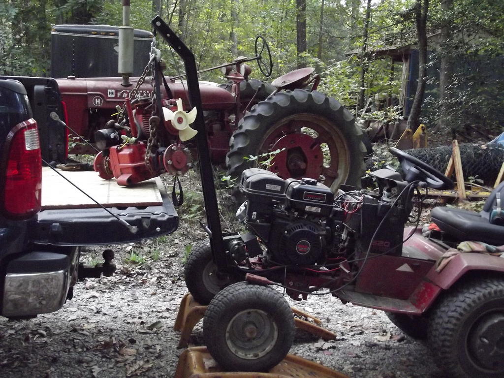

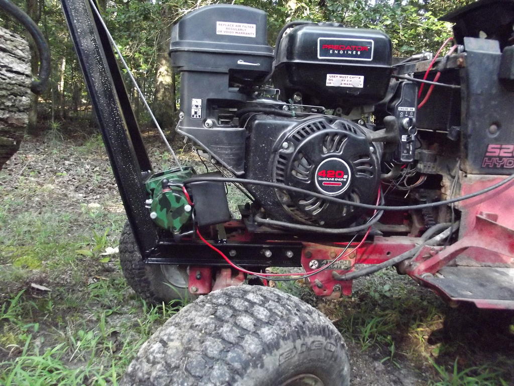

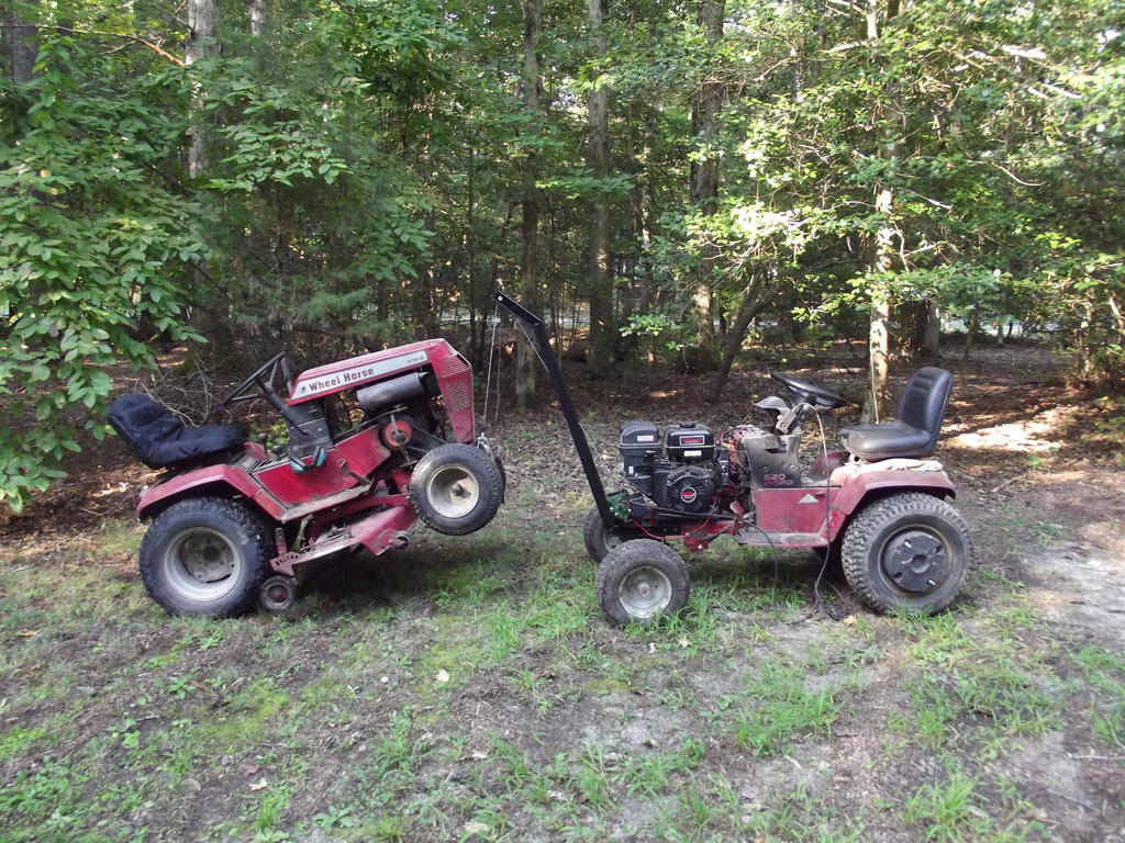

JAinVA 4,629 #3 Posted May 9, 2019 (edited) It really depends on what you want to do.If you want to lift a pallet and keep it level at various heights then a FEL will be useful.You could make an attachment similar to a fork lift to lift a pallet and keep it level.Picking up things,especially if you can't lift them on your own, with a GT and transporting them is great.Until I get my FEL finished this is my solution.Fabrication skills vary and you need to be motivated. Edited May 9, 2019 by JAinVA 5 1 2 Share this post Link to post Share on other sites

posifour11 723 #16 Posted May 9, 2019 12 hours ago, JAinVA said: It really depends on what you want to do.If you want to lift a pallet and keep it level at various heights then a FEL will be useful.You could make an attachment similar to a fork lift to lift a pallet and keep it level.Picking up things,especially if you can't lift them on your own, with a GT and transporting them is great.Until I get my FEL finished this is my solution.Fabrication skills vary and you need to be motivated. 12 hours ago, JAinVA said: It really depends on what you want to do.If you want to lift a pallet and keep it level at various heights then a FEL will be useful.You could make an attachment similar to a fork lift to lift a pallet and keep it level.Picking up things,especially if you can't lift them on your own, with a GT and transporting them is great.Until I get my FEL finished this is my solution.Fabrication skills vary and you need to be motivated. I've been considering this exact type of setup made from parts tractors. Any chance you have closeup pictures? @JAinVA 1 Share this post Link to post Share on other sites
1990Onan520-H 15 #17 Posted May 9, 2019 This might be an even better idea for me. Buy a pair of forks and go pick up a beat up blade to just weld them directly to. My current blade is really nice so I wouldn't want to ruin it. https://www.palletforks.com/1-2-thick-pair-of-pallet-fork-carraige-bars.html?gclid=Cj0KCQjwn8_mBRCLARIsAKxi0GJoZ6xoyGOrrwnpI8mEG0tYuKZC-rxbU8lLYnt1dnVZFfaj9U5e4rkaAvxyEALw_wcB Share this post Link to post Share on other sites
JAinVA 4,629 #18 Posted May 9, 2019 I have a couple close ups.Hope they help. 1 1 Share this post Link to post Share on other sites
posifour11 723 #19 Posted May 9, 2019 2 minutes ago, JAinVA said: I have a couple close ups.Hope they help. Excellent! Thanks. It sure helps my imagination engineering. Share this post Link to post Share on other sites

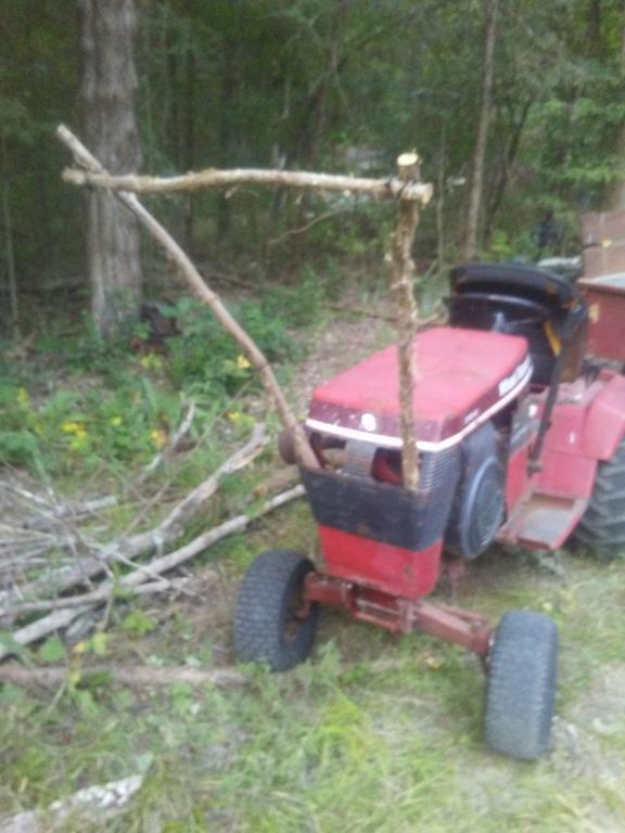

posifour11 723 #21 Posted May 9, 2019 (edited) 12 minutes ago, cafoose said: Got me thinking too! And with a couple "curb feelers" I could retire the cedar and zip-tie hillbilly style spiderweb killer. 😀 Edited May 9, 2019 by posifour11 Words are hard. 1 5 Share this post Link to post Share on other sites
lynnmor 7,577 #22 Posted May 9, 2019 7 minutes ago, posifour11 said: And with a couple "curb feelers" I could retire the cedar and zip-tie hillbilly style spiderweb killer. 😀 Great idea, patrol the road and use it to hang your roadkill. 1 1 Share this post Link to post Share on other sites
posifour11 723 #23 Posted May 9, 2019 10 minutes ago, lynnmor said: Great idea, patrol the road and use it to hang your roadkill. FYI, you can't hang a deer, but could probably hang a few raccoons. The rubber hood keepers give way after a while. I learned this by putting a third 25 pound weight in the hood. It does fine with two with them being wired in. A third weight breaks out your headlights, rips your hood keepers and dents the heck out of the hood. 😀 Share this post Link to post Share on other sites
