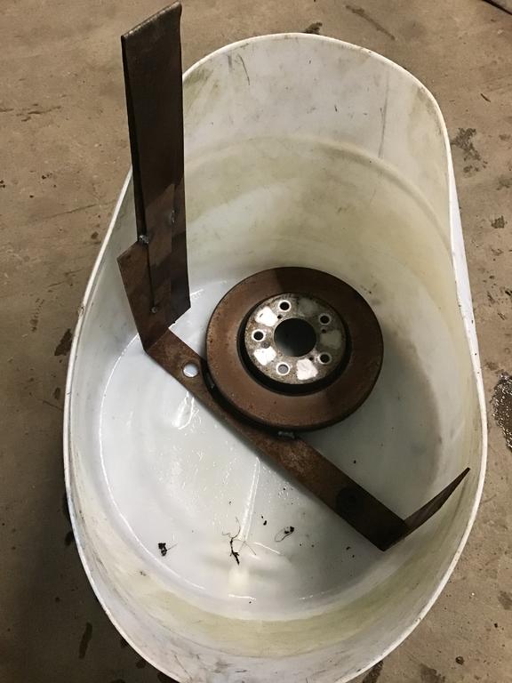

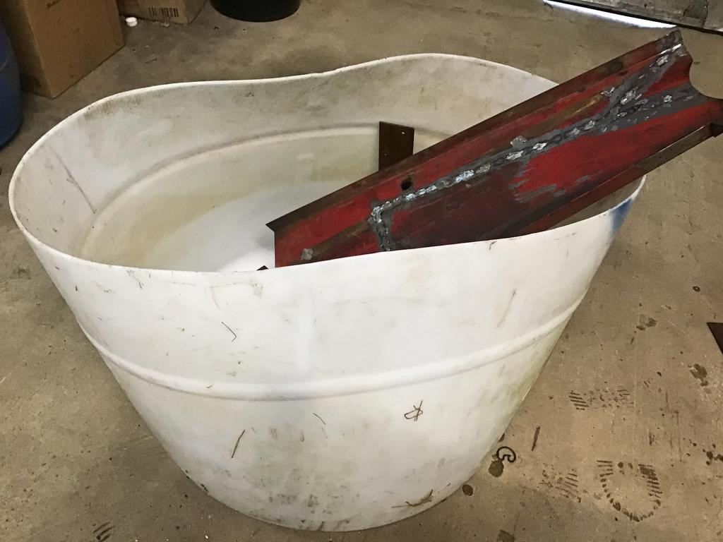

I’ll likely use this half barrel or blue trash bin then.  They both will fit more than 2/3 of a belt guard, likely the same scenario if I dip a frame.  Plus I can get away with less cooking juice.  Thanks fellas!
This autta’ do the trick!
