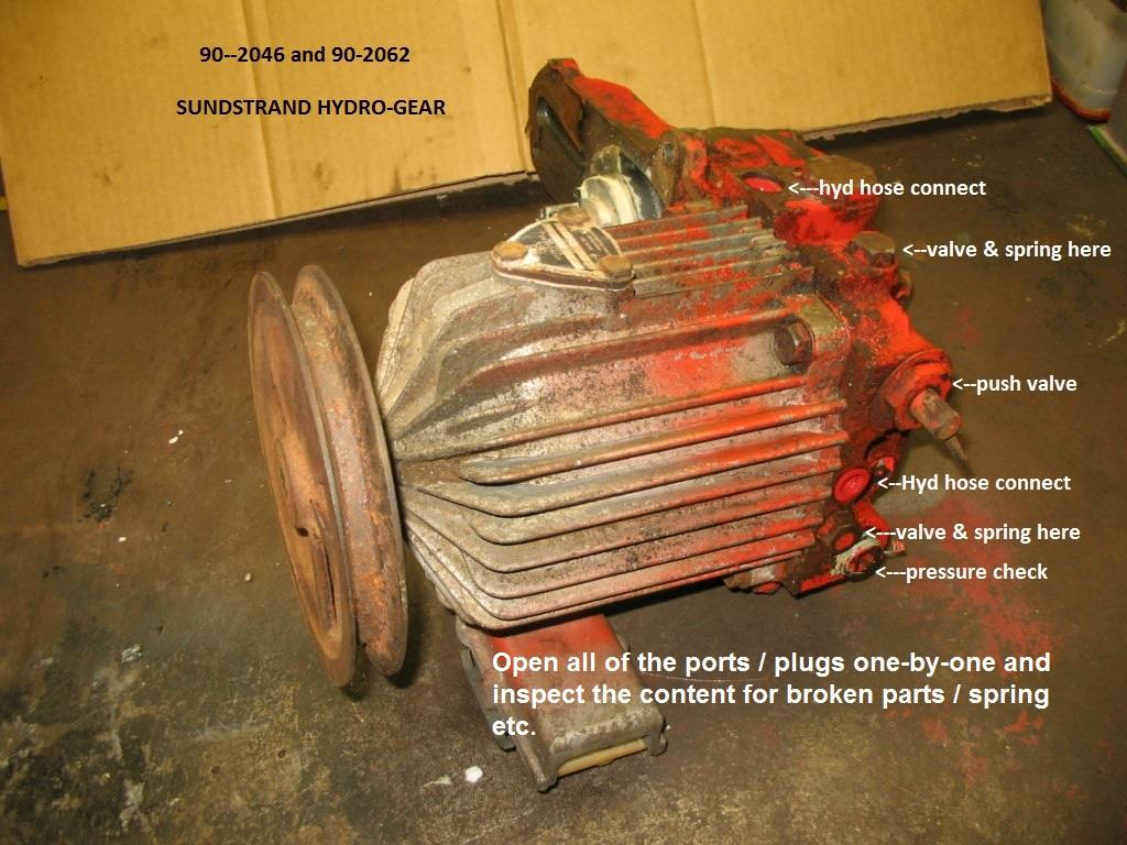

@daveoman1966 and @pfrederi can add a lot to this. I would start with the Acceleration valves and springs as a likely problem.

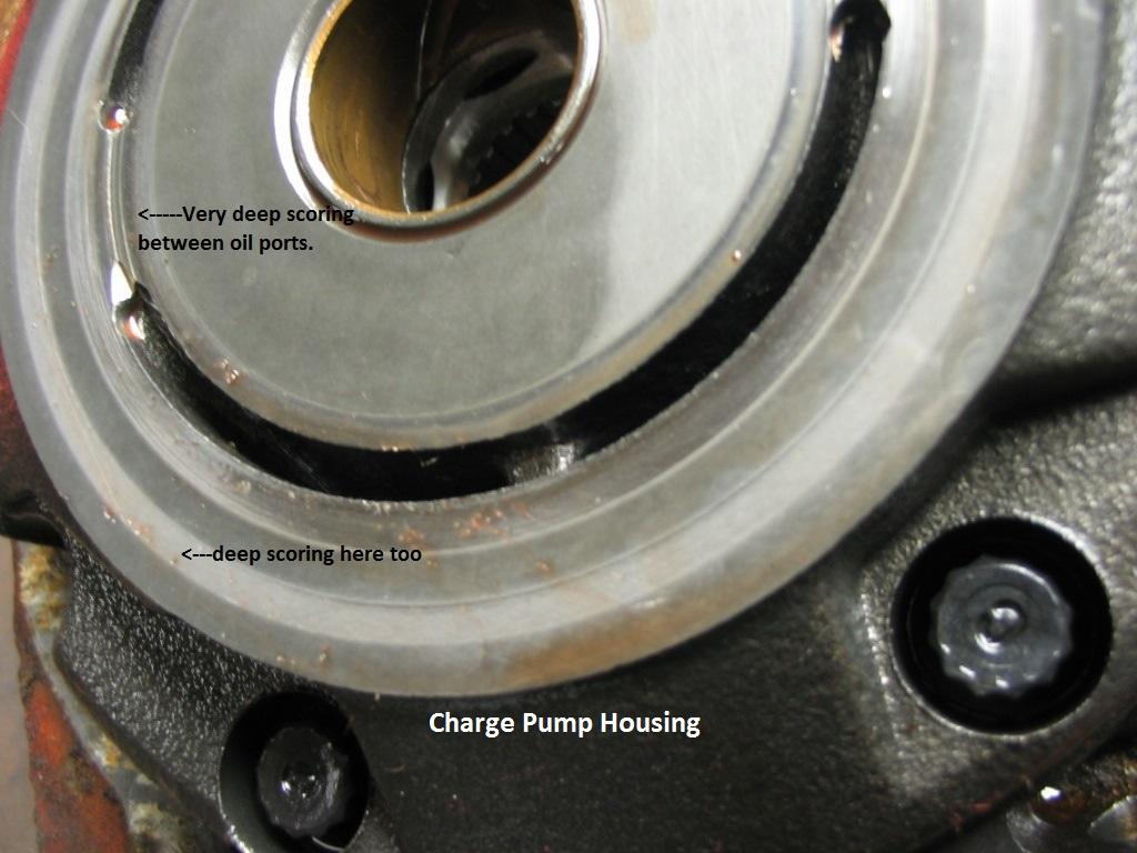

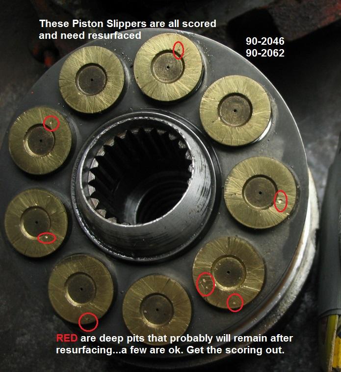

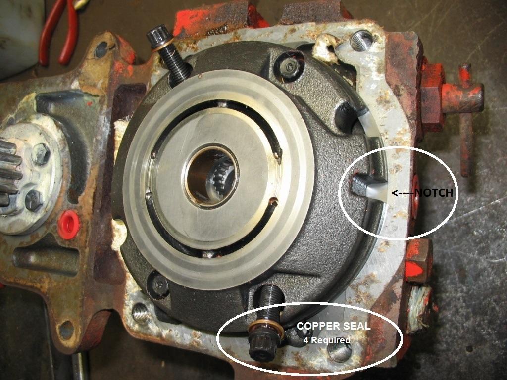

What you've described is typical of a worn-out hydro pump.  A rebuild is not difficult...the exercise of getting it out and bolting it back into the tractor is the bigger half of it.  This is is Sundstrand Hydrogear model 90-2062 and, usually, a very robust power unit.  However, when dirt / debris gets into the hydro pump, damage is caused to the soft brass internal components, resulting is loss of pressure with ensuing power loss.
If you can turn a wrench and know the working end of a screwdriver, you can manage the rebuild.  There is a manual to download for the rebuild on RS.  There are also several members that have contributed to this rebuild service, including me.  Not sure where the moderators have posted these reference files...but they are here somewhere.   Meantime, here is a pic or two of what you will find inside the pump.

Start with the service manual and look at all the springs and valves first. It is rather unlikely that they have been serviced for several decades. There is a trouble shooting section and some pressure test procedures you should do before diving in head first. As Dave said, these are not too difficult to work on and we have good members like him that will help you through the job.
