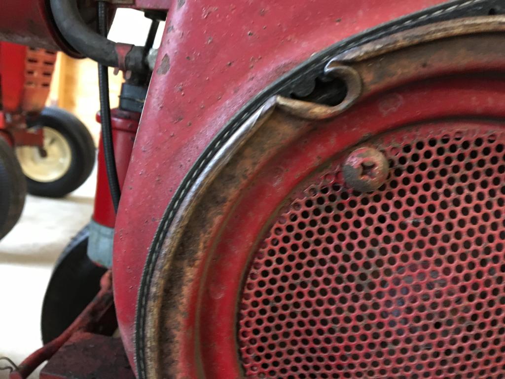

  Found out it was a WH part #1583. That would make it a 3L-33 or 3/8”x33”.
  Also showed a Gates belt 3V-315 which would be 31.5” long.
  Not exactly sure what I’ll find at Tractor Supply. The old belt is 31.75 long so maybe a 3/8x32 offbrand belt?
Crossed over the WH and Kohler belts to Gates and the suggested replacements are actually automotive belts with raw rubber sides.
Click on the fuzzy picture

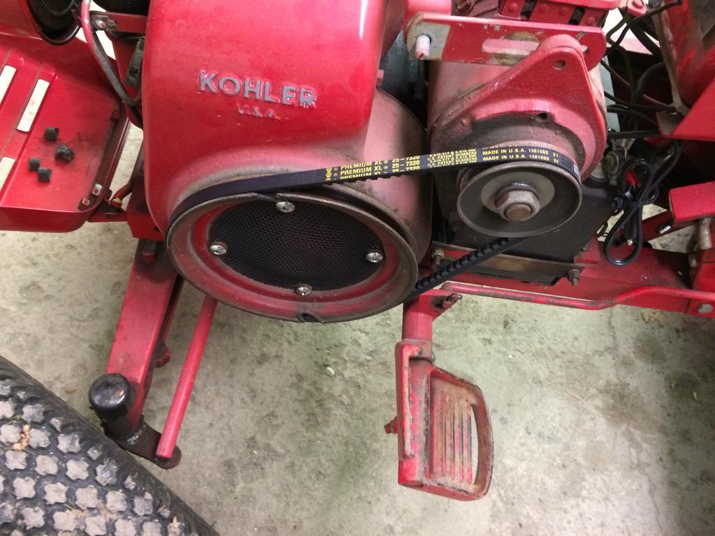

So ended up with this one from Autozone. I’ll report back if it works well or it.
That belt crosses to a Napa 25-9319 which is 32.38" Long.Top width .47"
The 25-7315 I used on my 8 HP is 32.08" with a top width of ..41" It sets right in the middle of the tension adjustment range.
Sparky

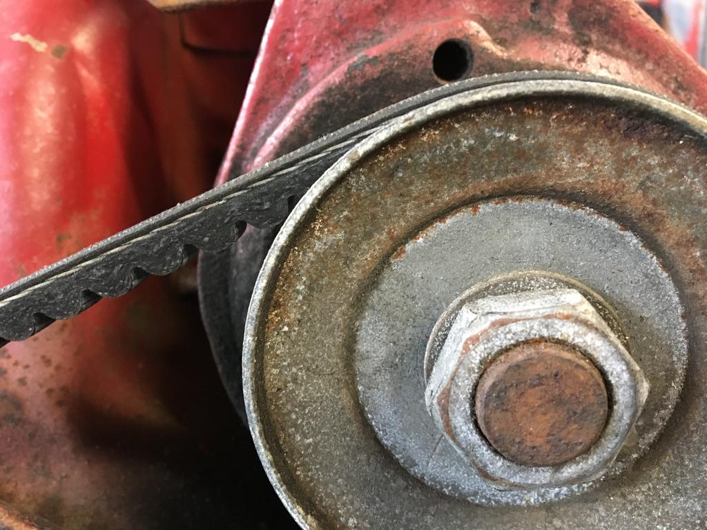

Hmmm...so this belt just barely fits? Starter gen is almost up against the motor 🤔. It was a fight just to get it on.
Belt width too wide. Do you have a Napa near by or maybe AutoZone can cross ref a Napa 25-7315?

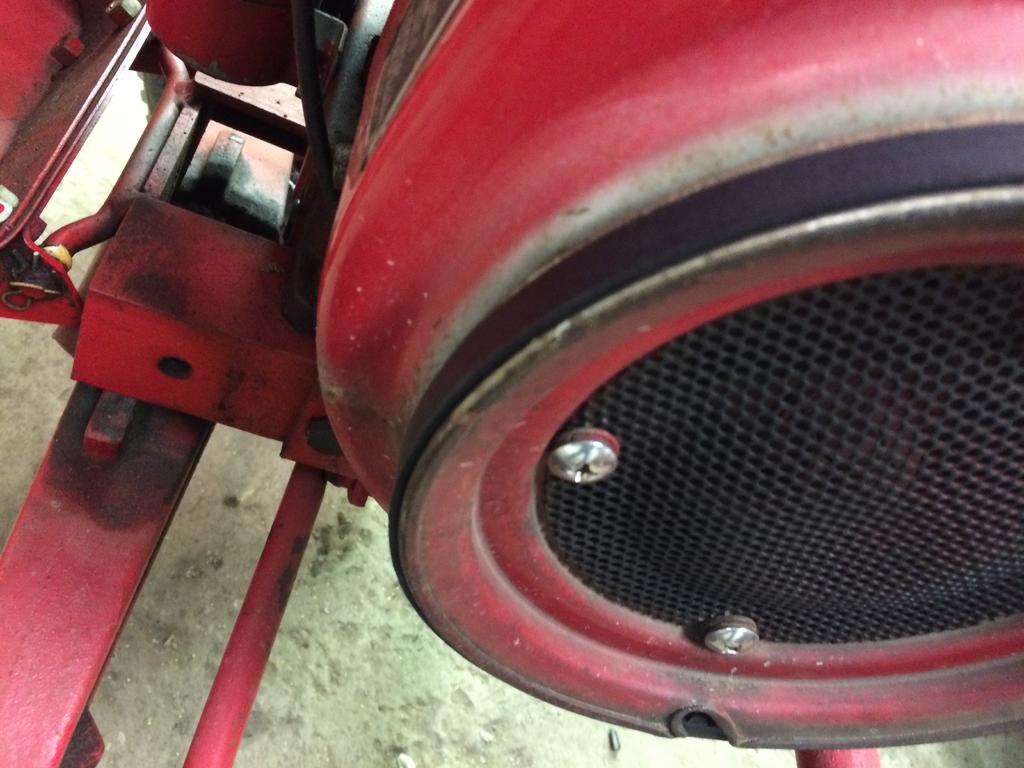

I guess I was not even close! I installed the belt guard anyway and of course it rubbed 🙄
