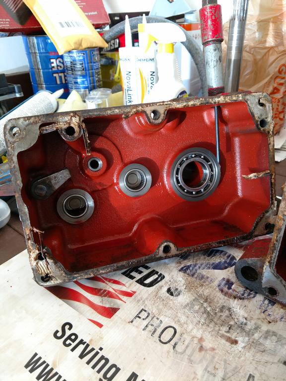

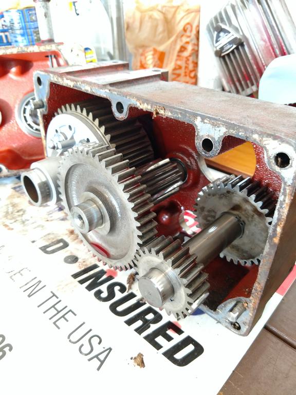

Ran d 24 #1 Posted April 21, 2019 Posting pics of internals of transaxle. 3 Share this post Link to post Share on other sites
953 nut 56,577 #2 Posted April 21, 2019 Looks good and clean. 1 Share this post Link to post Share on other sites
The Tuul Crib 7,338 #3 Posted April 21, 2019 Someone must have had some extra red paint ! Looks good. I have some spare parts if needed! Share this post Link to post Share on other sites
Ran d 24 #4 Posted April 22, 2019 Are you referring to the inside of the case? I figured they came from the factory that way? 1 Share this post Link to post Share on other sites
bc.gold 3,403 #5 Posted April 22, 2019 Those transmission halves would have been cast in a sand mold, after the metal is poured and cooled the parts go for shake out to remove the sand and sometimes a bit of sand will stay hidden to wreck havoc later. Wheel horse went that extra mile by painting the internals with "Glyptal Enamel" there are more benefits to having the inside painted besides retaining any ;loose bits of sand left over after shake out. Foundry's these days use vibratory equipment on the shake out line but you'll still see major mfg like Caterpillar still painting the internals on many of their castings. 1 Share this post Link to post Share on other sites

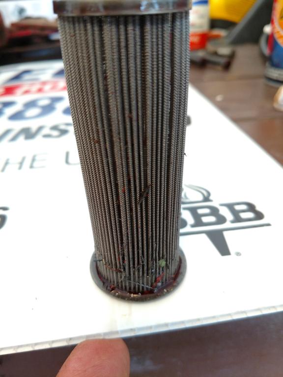

The Tuul Crib 7,338 #7 Posted April 22, 2019 Is that a filter ? Share this post Link to post Share on other sites
bc.gold 3,403 #8 Posted April 22, 2019 39 minutes ago, pfrederi said: They only coated the inside of the Hydro transaxles not gear drive ones. In addition to "Glyptal Enamel" ability of sealing micro pores in a casting ( leaks and hidden micro sand ) the painted surface inhibits rust and sheds oil to the sump where it belongs. Share this post Link to post Share on other sites
pfrederi 18,103 #9 Posted April 22, 2019 33 minutes ago, The Tool Crib said: Is that a filter ? Suction screen filter. they are NLA and hard to find good used ones..... do not damage it. Share this post Link to post Share on other sites
The Tuul Crib 7,338 #10 Posted April 22, 2019 27 minutes ago, pfrederi said: Suction screen filter. they are NLA and hard to find good used ones..... do not damage it. Are they just on the hydros? When I my 5060 apart there was none! Share this post Link to post Share on other sites
pfrederi 18,103 #11 Posted April 22, 2019 35 minutes ago, The Tool Crib said: Are they just on the hydros? When I my 5060 apart there was none! Just hydros Share this post Link to post Share on other sites
