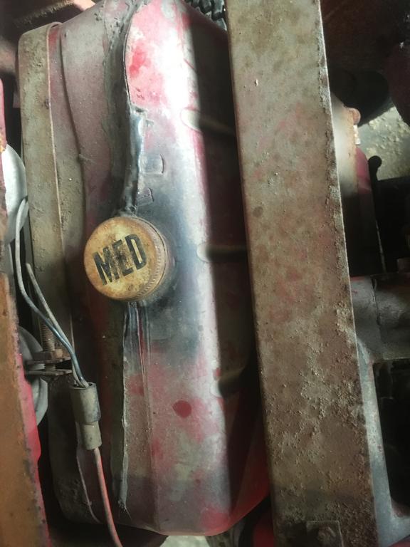

12 hp Kohler
15 hours ago, Pollack Pete said:
VERY nice GT-14.I have 5 or 6 of them myself.I  see by the exposed fuel tank that it's an early one.Later ones had the full cast iron grill protecting the tank.Be careful you don't run into anything and poke a hole in that plastic tank.Have fun with your new toy.
I looked at the gas tank a little bit and it is in really bad shape, I’m not sure if it is salvageable. I’m not sure if it could be repaired or not. I will take some pictures of it tomorrow and you guys can give me some pointers.

12 hp Kohler
Here is picture of the fuel tank. The whole top of it is cracked and bent up. It’s already been repaired but the repair broke. D8F92616-8F62-4116-97E0-D97E5E07D0F8.jpeg.f3c00c32fac0267063fcc35900f011f2.jpeg
  • Sad 2
oldredrider
These tanks are getting hard to find in good condition. I had one where the bottom was cracked almost all the way across. Sent it to a friend who had a plastic welder. Came back all sealed up and stayed that way. Do a search on Google regarding plastic welding if you can't find a replacement tank.
  • Like 3
19richie66
Soldering iron and black zip ties. Groove the crack with the tip of the iron, melt a zip tie into the groove and work back and forth till it is melted into the tank. Being it is on the top, it’s not as critical and you can sand it and seal it

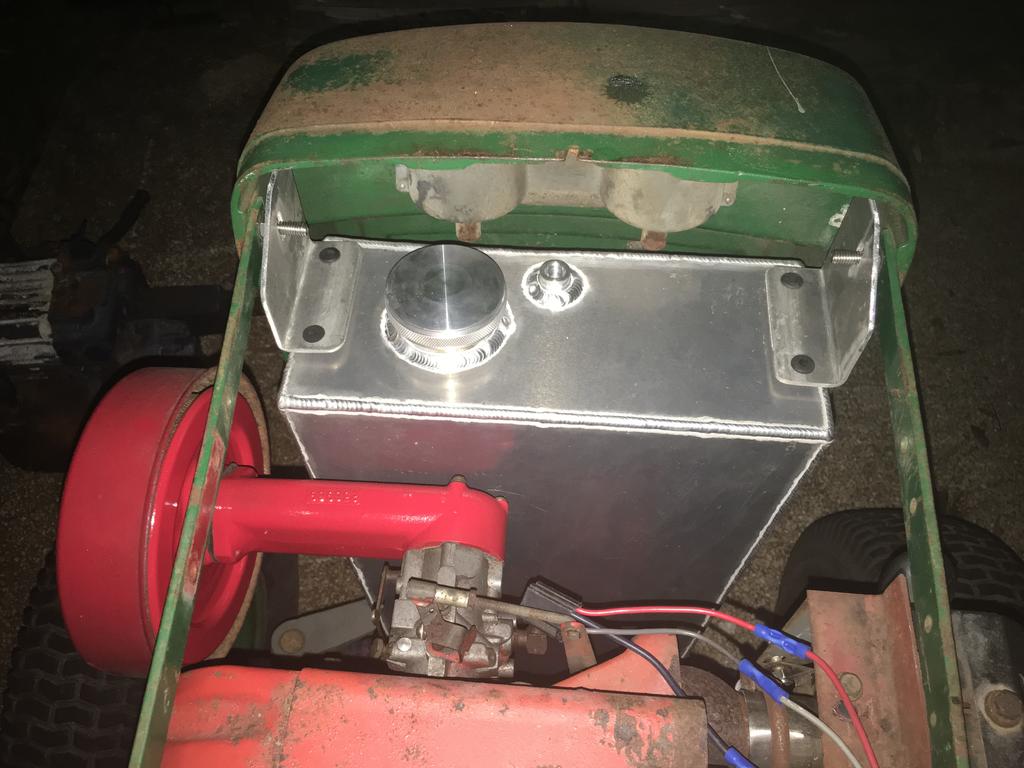

19richie66
Probably the age of the plastic. Aluminum is the way to go. 👍
  • Like 3
  • Excellent 5
Aldon
Your son needs to start a side business!
Edited by Aldon
  • Like 3
19richie66
If people didn’t mind paying for them, we would. They wouldn’t be cheap but would last a looooong time. It wasn’t a direct fit but pretty darn close. A couple slight mods to the lower mount but I think the upper holding strap may work. I made my own mounts. Not as much capacity as stock but still around 4 gallons. But , it doesn’t leak and I don’t have to worry about poking a hole in it. 👍
Edited by 19richie66
  • Like 4
  • Excellent 3
