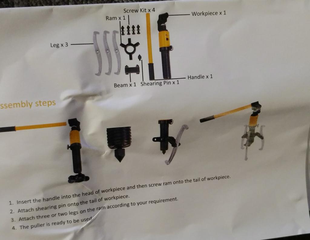

troutbum70 857 #1 Posted April 11, 2019 Just received a hydraulic gear puller 5 ton capability. Anyone use one of these with any success? Been struggling with the wheel hubs to remove them on the 417, trying a new product also from seafoam called Deep Creep. Not sure it's any better than the rest at this point. Won't get to try the puller for a couple days, so have to wait to see if it works. 1 Share this post Link to post Share on other sites

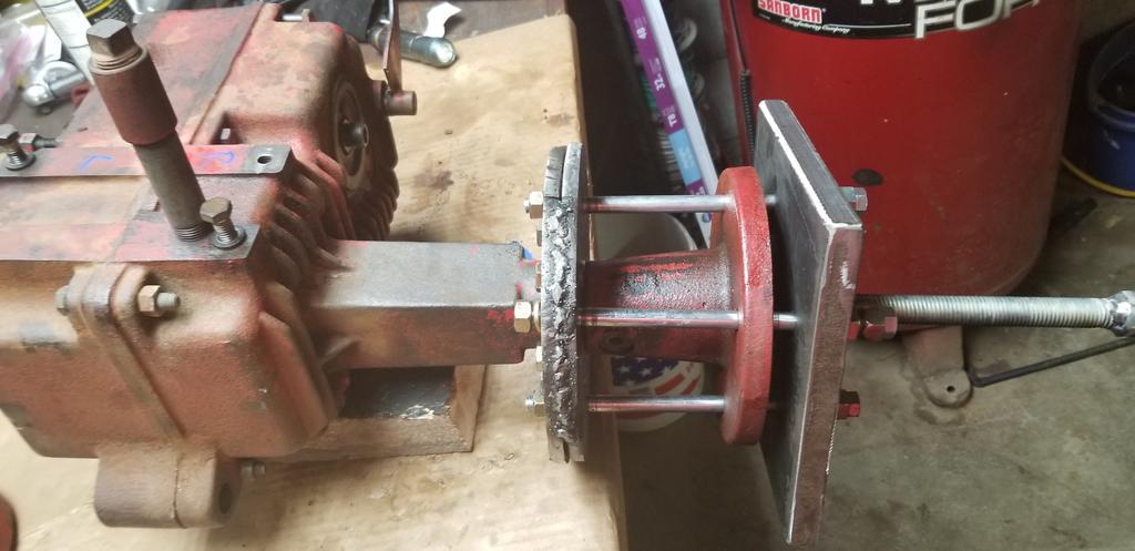

ebinmaine 70,320 #13 Posted April 12, 2019 It's a little tough to see but here is what I have. I used the piece that holds the claws of the 3 jaw puller between the two of the hubs. Bolts are through all the holes of both hubs. Bolt size is 3/8" by about 4 long. I have (on purpose) broken a hub this way. I have also... Accidentally... Broken a hub. This isn't fool proof but it works well. I do realize you're trying to save the seals but the heat makes a HUGE difference. It may be worth your while to use the torch and then just replace the seals. They're inexpensive, easy to get, and easy to change from the outside. Share this post Link to post Share on other sites

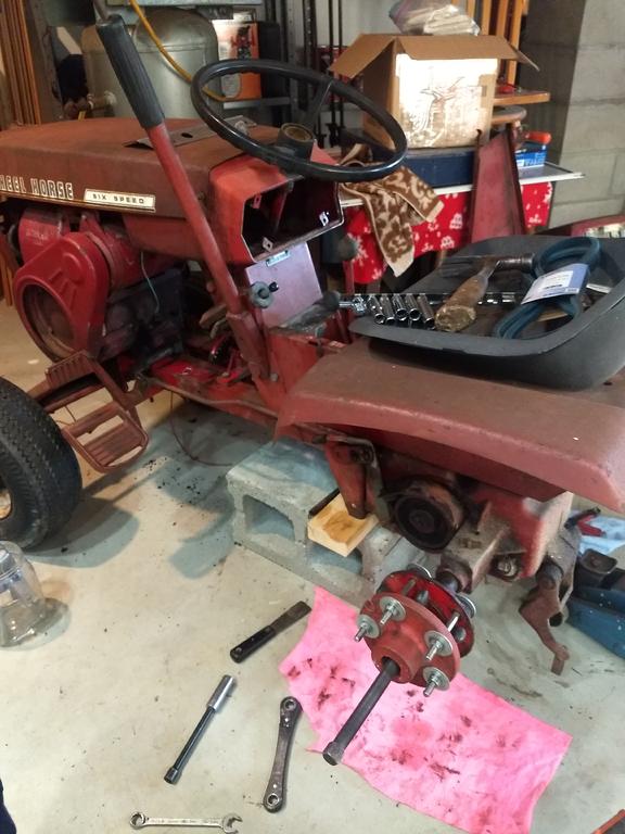

pfrederi 18,279 #18 Posted April 12, 2019 I got the 10 ton version but only used it once and not on WH hub. you will break the hub if you use it on the flange. However if you can pull on the back of the hub the hydraulic thing would work. See two examples of pulling on the rear of the hub 2 3 Share this post Link to post Share on other sites
ebinmaine 70,320 #19 Posted April 12, 2019 3 minutes ago, pfrederi said: examples Paul, the upper one... That is using 5 bolts straight through the Hub you are removing. How does that go on the axle? Is it a slot? That slides down over it? Share this post Link to post Share on other sites
pfrederi 18,279 #20 Posted April 12, 2019 (edited) 2 hours ago, ebinmaine said: Paul, the upper one... That is using 5 bolts straight through the Hub you are removing. How does that go on the axle? Is it a slot? That slides down over it? Look at this thread starting #62 GT riders idea Edited April 12, 2019 by pfrederi Share this post Link to post Share on other sites
troutbum70 857 #21 Posted April 13, 2019 Pfrederi I plan a setup similar to picture 1 only using a bearing separator to clamp around axle and pulling from that point. I don't believe the axle and in side of hub are tapered, that being said with all the penetrate I have shot back in the key slots and down the set screw holes a body would not think they can still be that stubborn tight. Share this post Link to post Share on other sites
