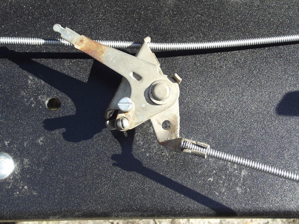

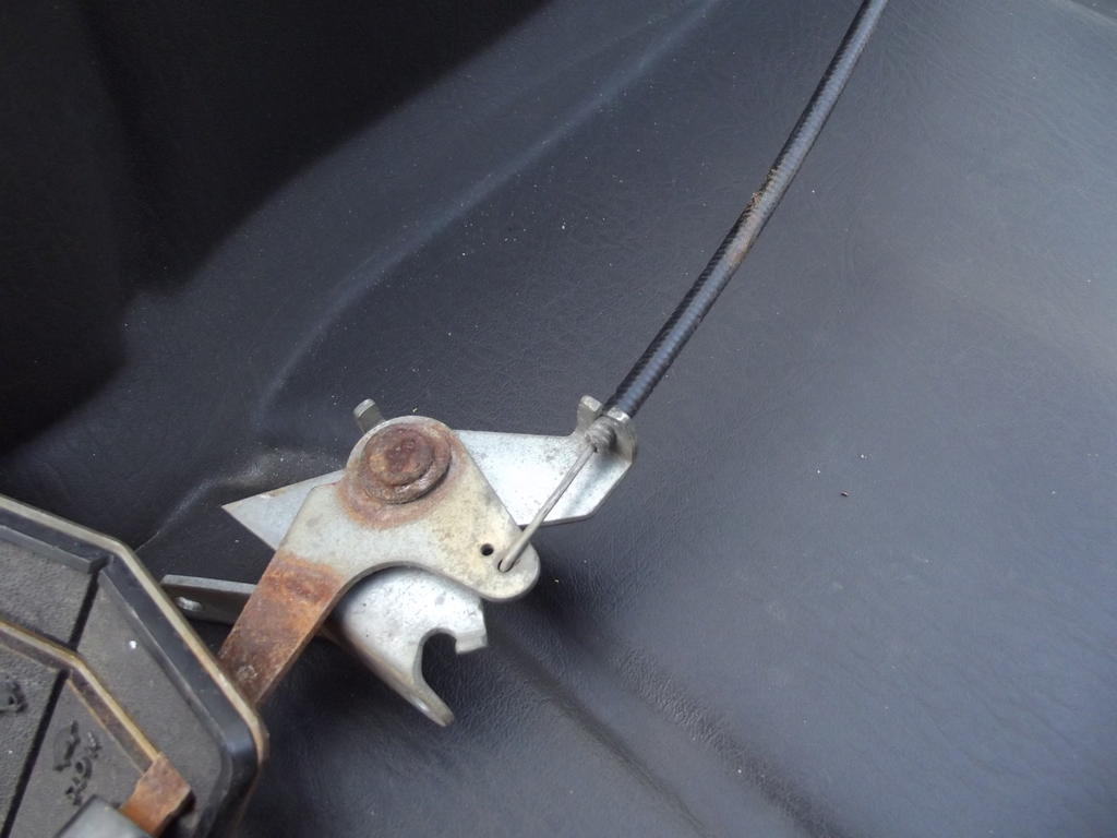

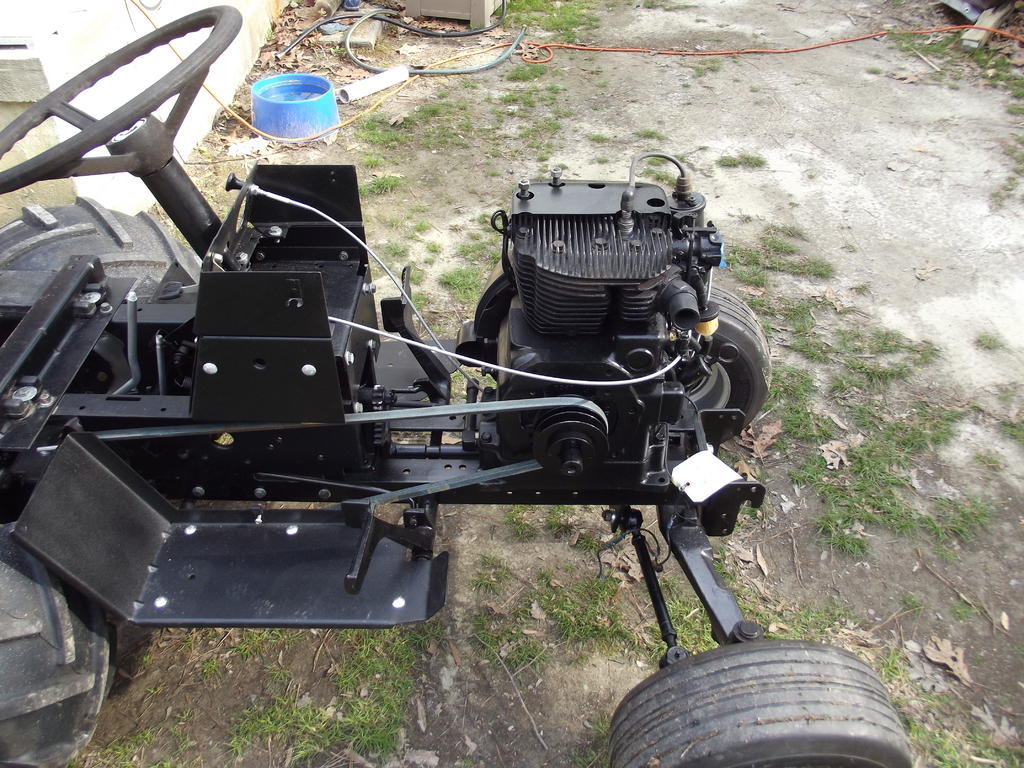

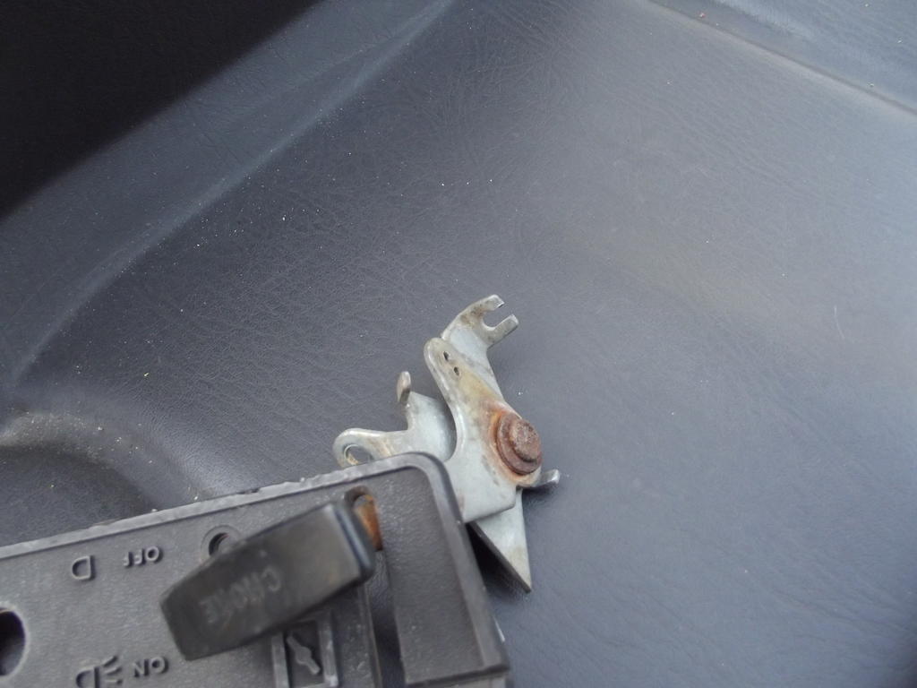

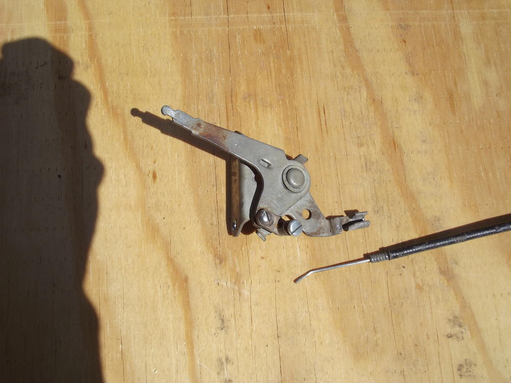

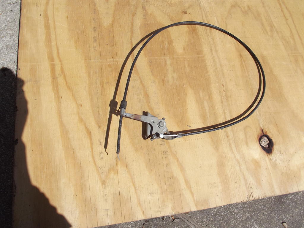

JAinVA 4,629 #1 Posted April 10, 2019 (edited) I needed new choke and throttle cables for my 312a custom so I made some.I hope this will help someone else.I wanted to use the existing throttle cable actuator and just replaced the cable.The cable mount had the crimped section opened up and the old cable removed. I bought a push pull choke cable that was 8' long.The core was pulled out and I cut the spiral portion to length.One end was crimped at the dash end and the other end routed to the engine.The core length was measured and secured at each end.New throttle cable.This fix can be used on any c series or 3,4 or 500 series. Edited April 10, 2019 by JAinVA 2 8 Share this post Link to post Share on other sites
