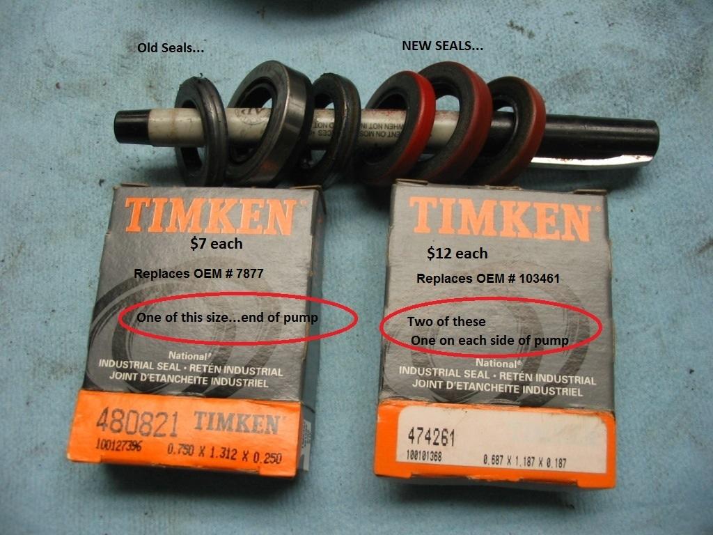

daveoman1966 3,880 #1 Posted April 9, 2019 (edited) IHere is a combined Excel SS of the Sundstrand Automatics model 90-1136, 90-1137, 90-1140, and 90-1173. This file MAY be helpful to those members rebuilding their tractors due to leaking, low power, or other issues. For parts ordering, I've found this website to be my favorite on price and delivery time. https://www.psep1.biz/arinet.asp?aribrand=TO# The replacement seals for the Hyd PUMP are given in a separate file, as attached. SUNDSTRAND PUMP & MOTOR DETAILS.xlsx Edited April 9, 2019 by daveoman1966 error 1 2 3 Share this post Link to post Share on other sites

daveoman1966 3,880 #8 Posted April 10, 2019 21 hours ago, 953 nut said: Paul, I saved it and converted ti to a PDF which you should be able to view. It isn't perfect, but should open for you. SUNDSTRAND PUMP & MOTOR DETAILS.pdf I have revised the Excel SS and exported pit to a .PDF. Will leave it to the Experts / Moderators to upgrade / replace the prior .pdf as it cropped some of the schematic images. SUNDSTRAND PUMP & MOTOR Parts list.pdf 3 2 Share this post Link to post Share on other sites
