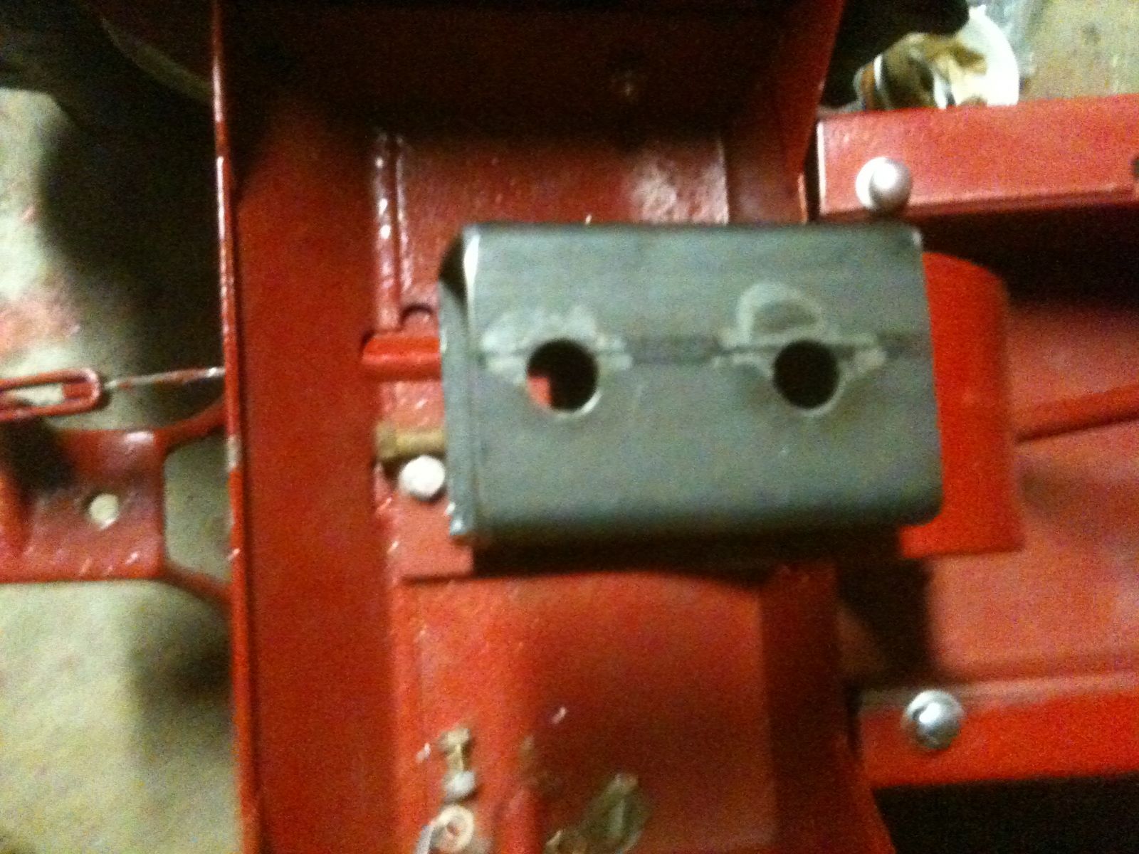

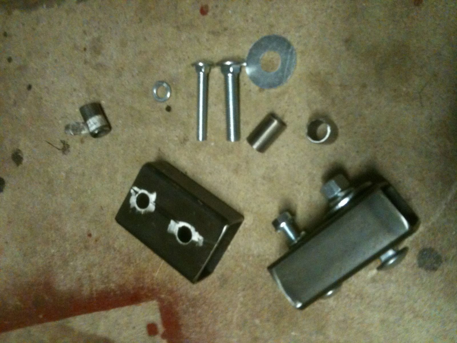

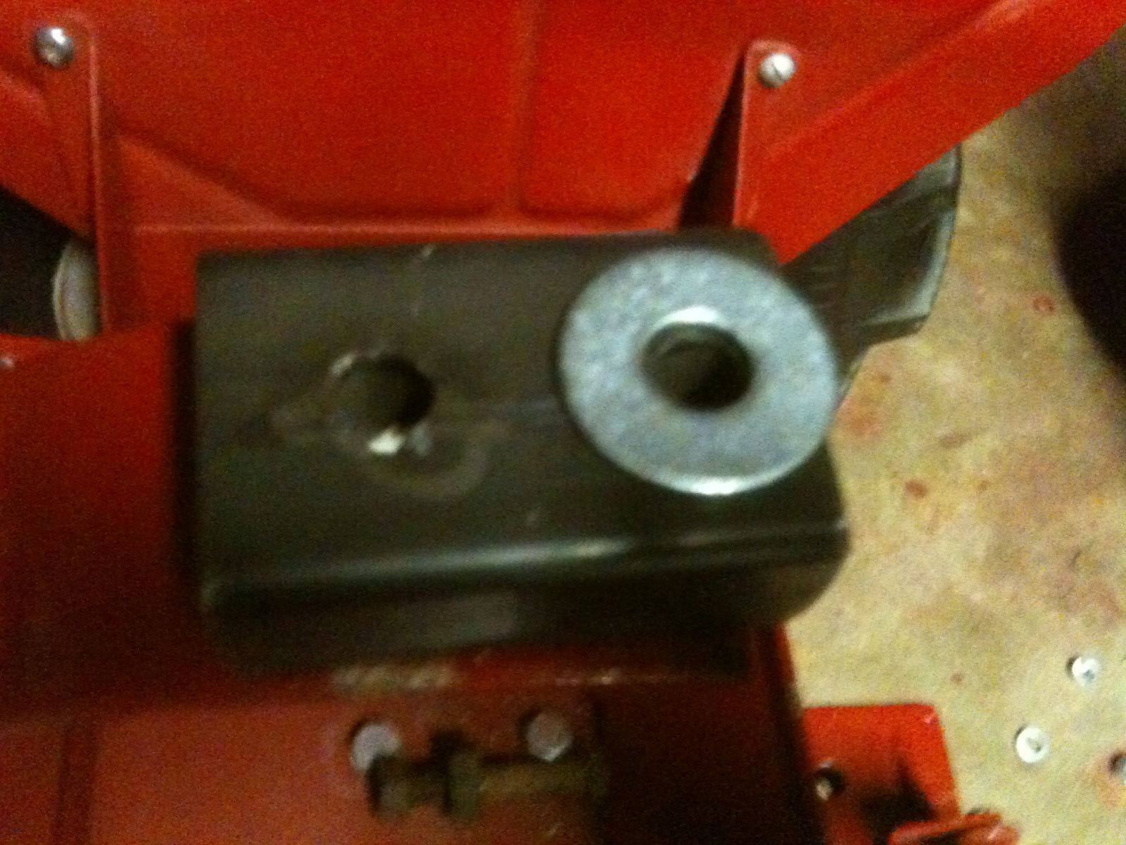

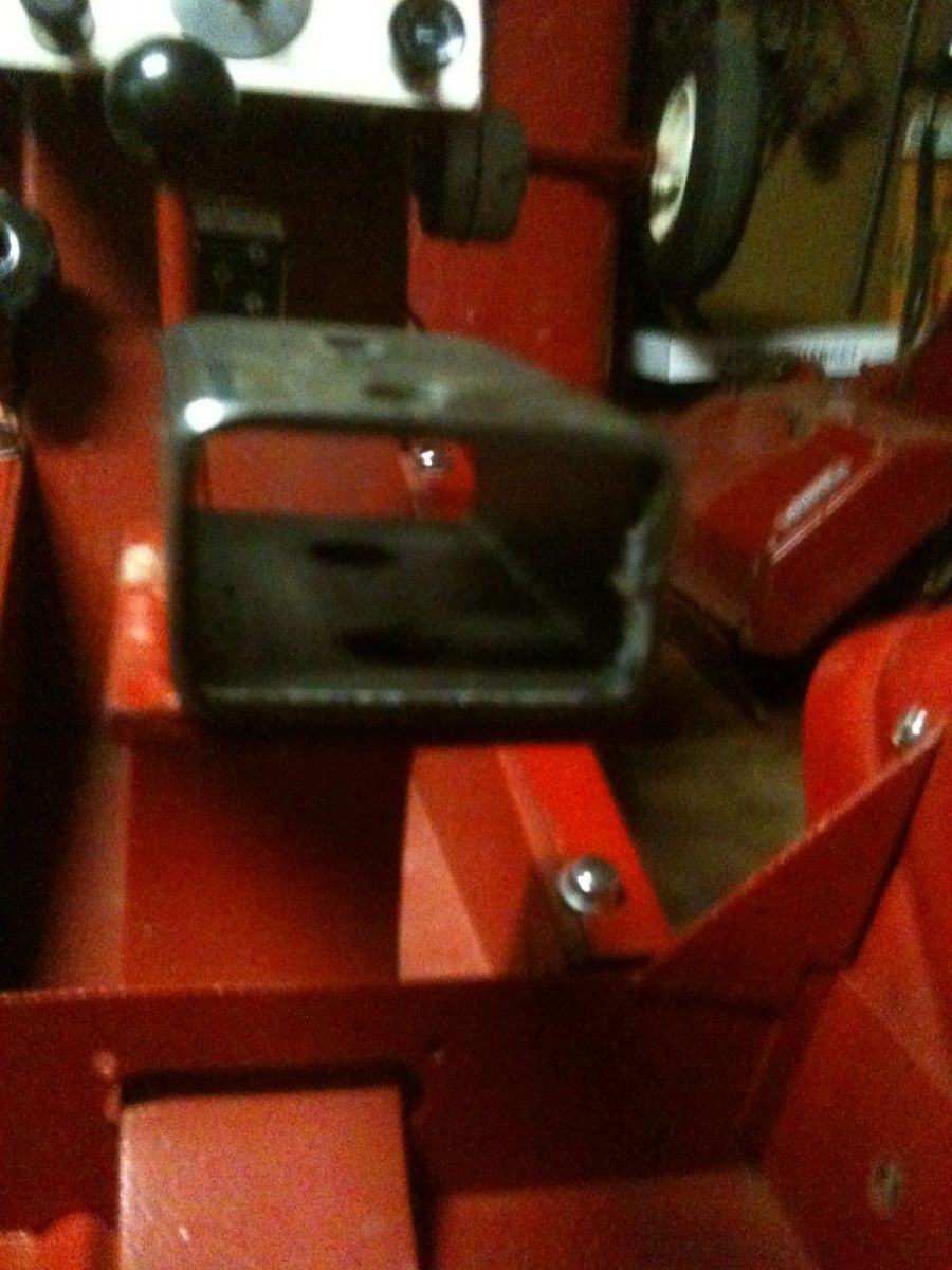

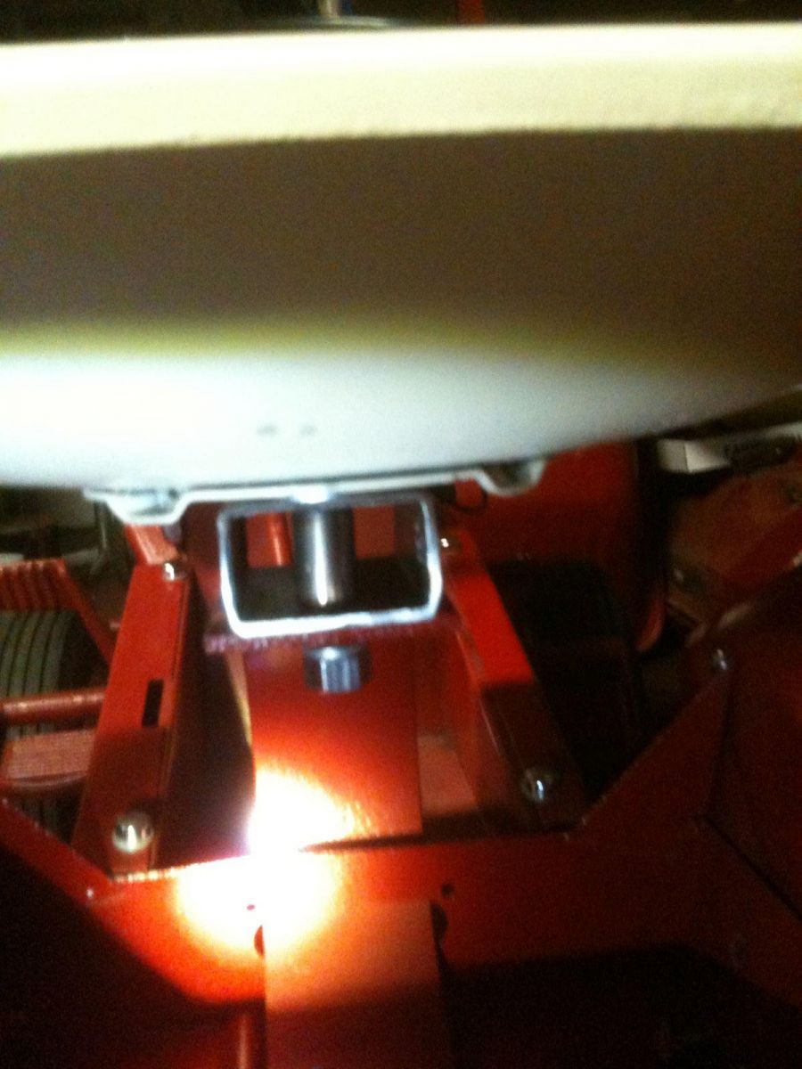

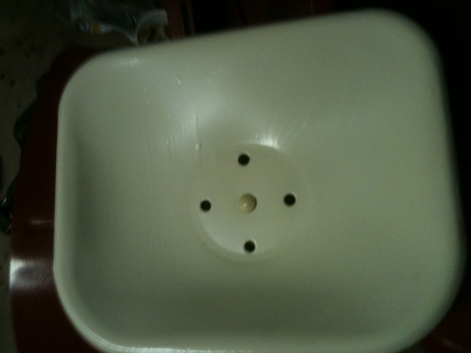

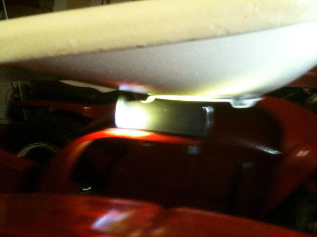

Lane Ranger
The  tubing fix  works great on  top of seat springs and under the seat to lift the seat pan off of the fenders.     Seat springs do wear with time and settle lower.

ronhatch
Ray, I would recommend that you use a spacer that's as wide as the spring and long enough so the seat is as stable as it was originally.  Not doing so will put undue stress on the steel around the bolt area and may eventually crack the seat. I used a 1" thick solid block of Aluminium that was as wide as the spring.   My :twocents-twocents:
