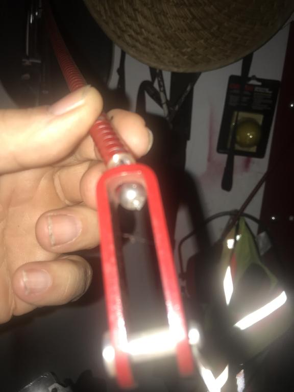

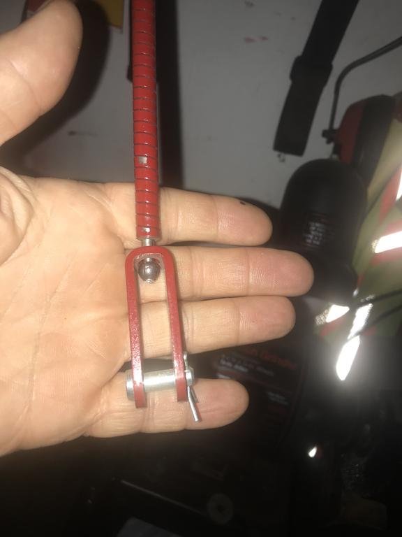

Lane Ranger 11,096 #2 Posted April 2, 2019 (edited) Best thing to do is buy one from Lowell S. At WheelHorse parts and more in vendors section! It will last! Better than the original! stainless steel cable and lined conduit! Edited April 2, 2019 by Lane Ranger 1 3 1 Share this post Link to post Share on other sites

Sarge 3,464 #6 Posted April 2, 2019 Those crush type swage ends won't hold to the limit of the cable itself - most will never hit 1/3 of the cable rating. I have the hand type crimper made for those ends and make my own cables for several things - that tool, and those swage ends will not hold enough weight for the WH lift, manual or hydraulic - doesn't matter. The test bed was a 10" Brinly single bottom plow - not a very heavy implement and every test cable ripped right through the swaged end. Both the barrel type and the ball type sleeves are not designed for the stress that our tractors and implements will put on that cable - there is a huge strain on them due to the leverage created within the geometry of the lift linkage. Even the bolt type saddle clamps are not rated to the full cable breaking strength. Lowell is using hydraulicly swaged cable ends that are designed to hit the max limit of the cable rating - huge difference. To make these requires a hydraulic die crimper that is made specifically to do these ends, quite an expensive tool to say the least. The hydraulic crimping machine works similar to the ones used to make hose fittings and has specific dies to fit the cable size and sleeve/ball ends. Again, tools like this are not cheap - go have a look around at places like McMaster or Grainger. I applaud the fact that he put the investment into doing these - that is a pretty expensive investment and risk in tackling such a small market. I had researched at least 5 different companies to make these cables. None of them had the least bit of interest, no matter what the initial order quantity was due to the liability that is involved. My opinion - get Lowell's cables, it helps him help us as an investment for these non-existent parts and helps to drive the market. It can also help to drive more different parts being made to equal or above the factory originals. Sarge 1 4 1 Share this post Link to post Share on other sites

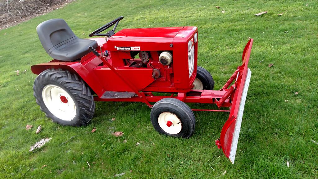

TIGman 2,006 #9 Posted April 2, 2019 Can't hardly wait to get the rear lift working again. The 1054 is my go to tractor for work around the place, especially moving my utility trailer where needed. 1 5 Share this post Link to post Share on other sites
19richie66 17,560 #10 Posted April 2, 2019 Nice looking ride @TIGman 2 1 Share this post Link to post Share on other sites
WVHillbilly520H 10,376 #11 Posted April 2, 2019 1 hour ago, TIGman said: Can't hardly wait to get the rear lift working again. The 1054 is my go to tractor for work around the place, especially moving my utility trailer where needed. Yes sir I concur...but sometimes you just need a little more tractor... 1 Share this post Link to post Share on other sites
