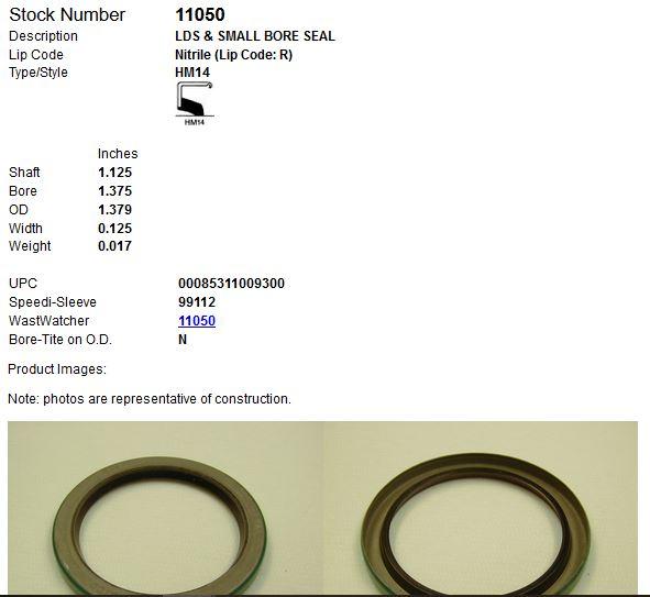

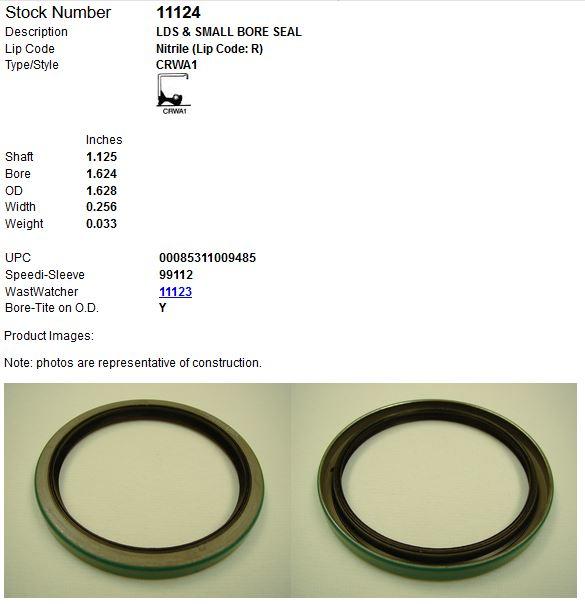

pfrederi 18,295 #10 Posted April 4, 2019 (edited) The gasket is different for hydros than gear drives Hydros use 5999 which is NLA form Toro but Lowell sells them ..or you can make your own. Sundstrand hydro transaxles use a different Seal than the gear drives 1-1/8" axle. WH# is 6449 CR11124 Gear drives use 100443 CR 11050 Edited April 4, 2019 by pfrederi 3 1 Share this post Link to post Share on other sites
