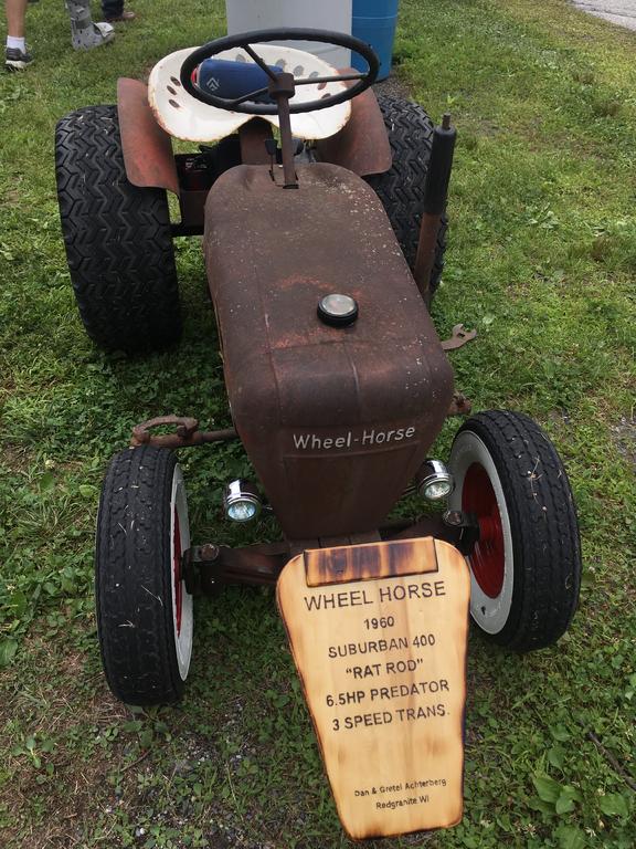

Dan @Achto did some mods to his 6.5 Predator in the Rat Rod and thinks he gets about 8.5 out of it.

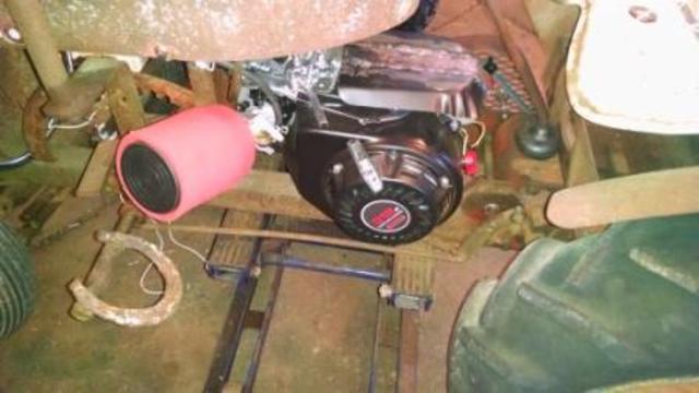

If you want a little more out of that Predator, check out the Go Cart sights. They have a ton of mods for those engines. Some mod kits are claiming 11hp + at 7000RPMs. Important note: the stock flywheel will come apart at 5000RPMs, so if you wish to reach beyond that you will need a billet fly wheel.
I planned on keeping my governor so I did not replace the fly wheel. I did file half of the key on the crank down so that I could advance the timing a little. Installed a billet rod & piston, larger cam, and heavier valve springs.
A few picks of my install. The belt guard I made new & the rusted it to match the rest of the tractor.
IMG_20160227_142609011.jpg.6415a68fe62dd282c40e2118c42468d1.jpgIMG_20160320_144053462.jpg.b9056f462643721aad8023d575893755.jpg

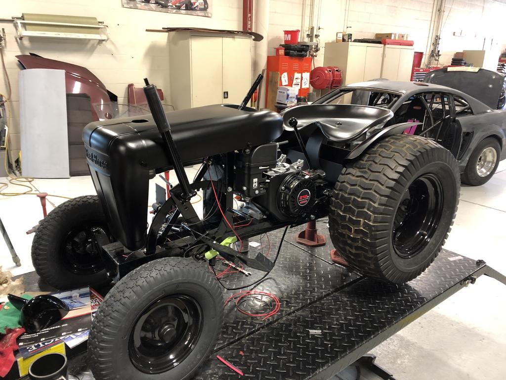

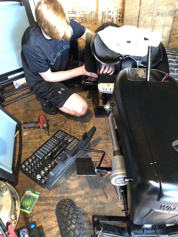

Dillon is doing some last minute modifications. Trying to make the fat tires not rub. We need to find rims with less back space.
stevebo
Get it done. Looking forward to seeing it tomorrow
BHunter
We decided to load it up and finish hooking up the fuel line when we get there. See you tomorrow.

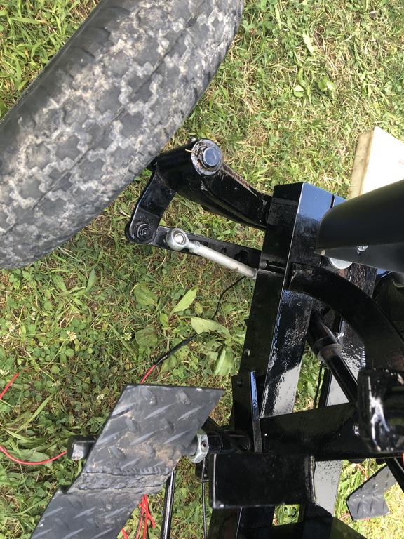

Thanks @stevebo for the tie rod. It looks good.

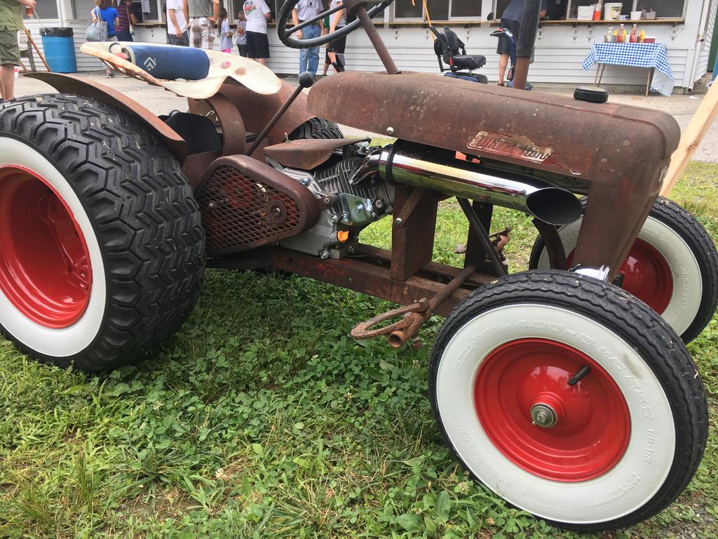

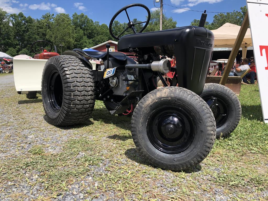

Enjoying the Big Show
19richie66
That turned out great!
