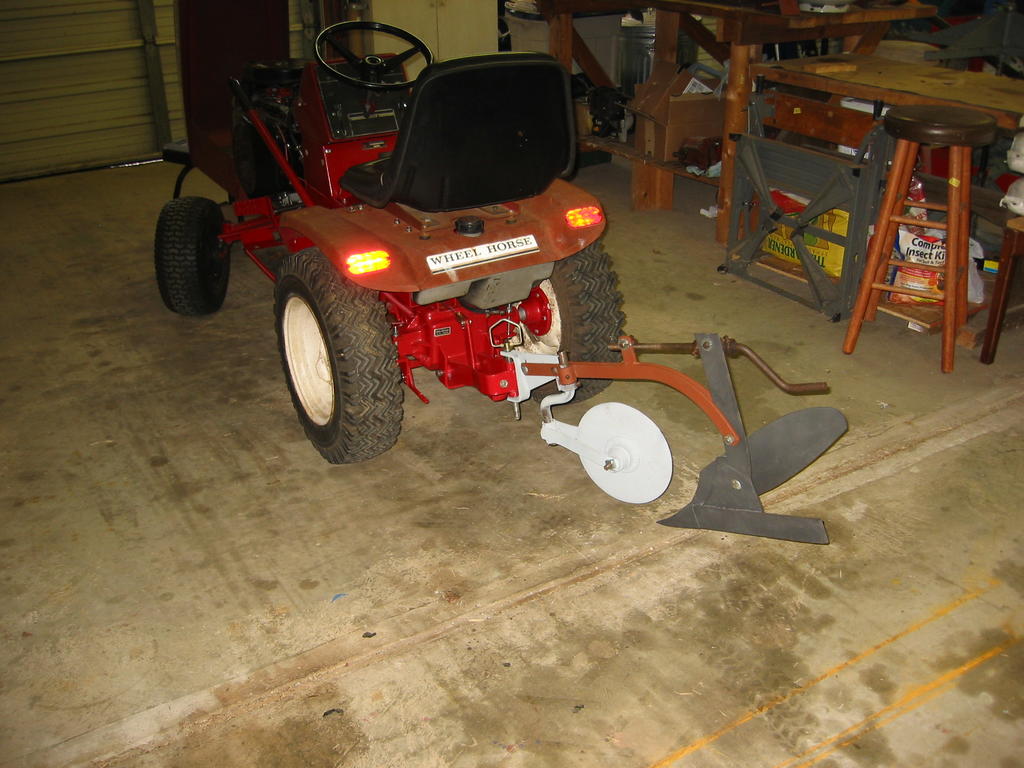

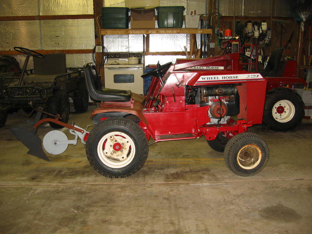

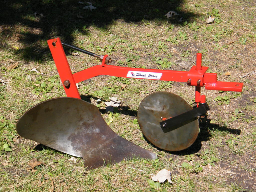

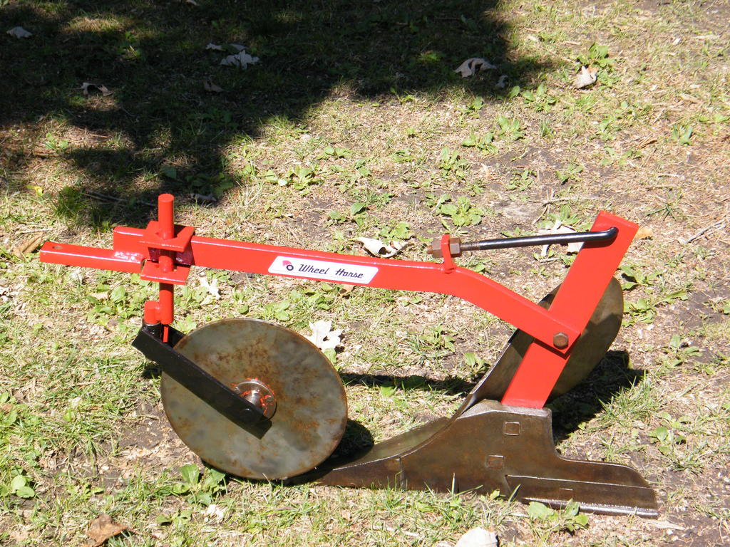

Guten Tag   I am sure others will have better pictures
rearcable008_zpsaa5253f4.thumb.jpg.8891e3c325b1a5fc591451dd40f3c0e8.jpg.21cfd4f081d7c97c8bf5446ee3a46a5a.jpg

hi, thanks a lot

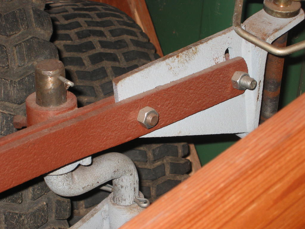

would it be possible to send a close-up of the attachment of the plow (
because I have to build these too )?

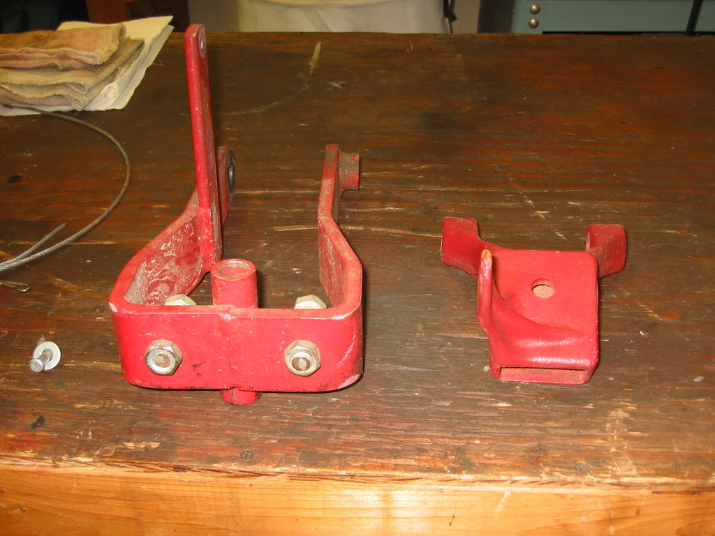

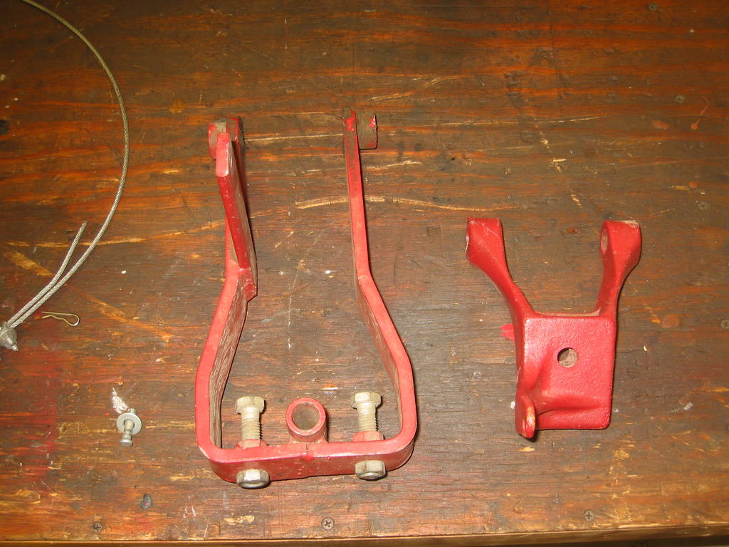

Look at the last pic here. That stub slides into the slot hitch. do you have a hitch on yours?
Wheel Horse slot hitch;
pfrederi
You can use either hitch here.  The C-175 in my first pictures used the clevis hitch 8-5511 or 85518.

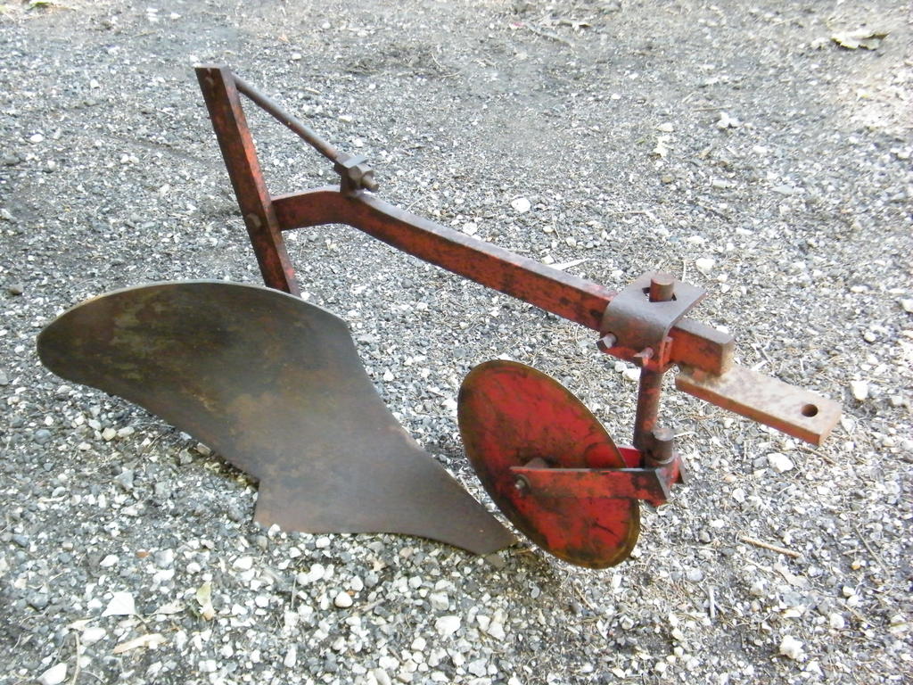

stevasaurus

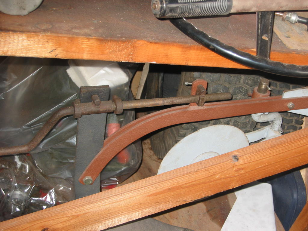

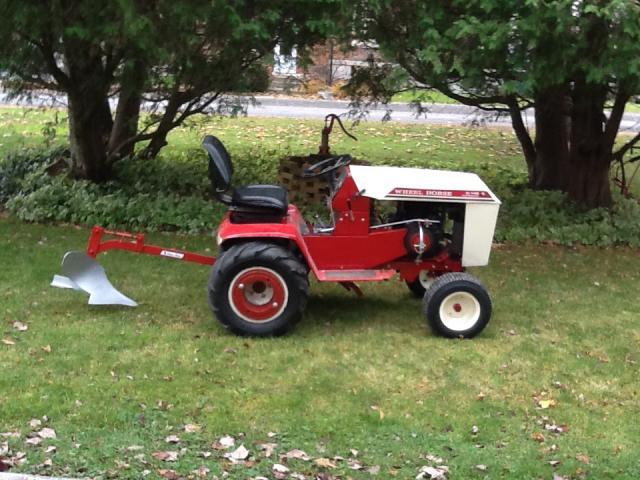

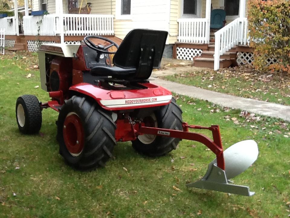

Here are a few images that use the slot hitch.
wheeliepower
thanks a lot, these are enough ideas to build something own ;-)

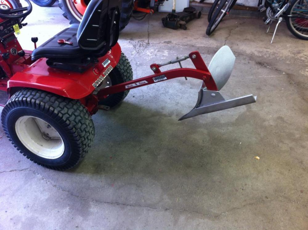

pfrederi
If you want a clevis hitch plow.
Sorry it is behind a bunch of stuff so pictures are not the best.

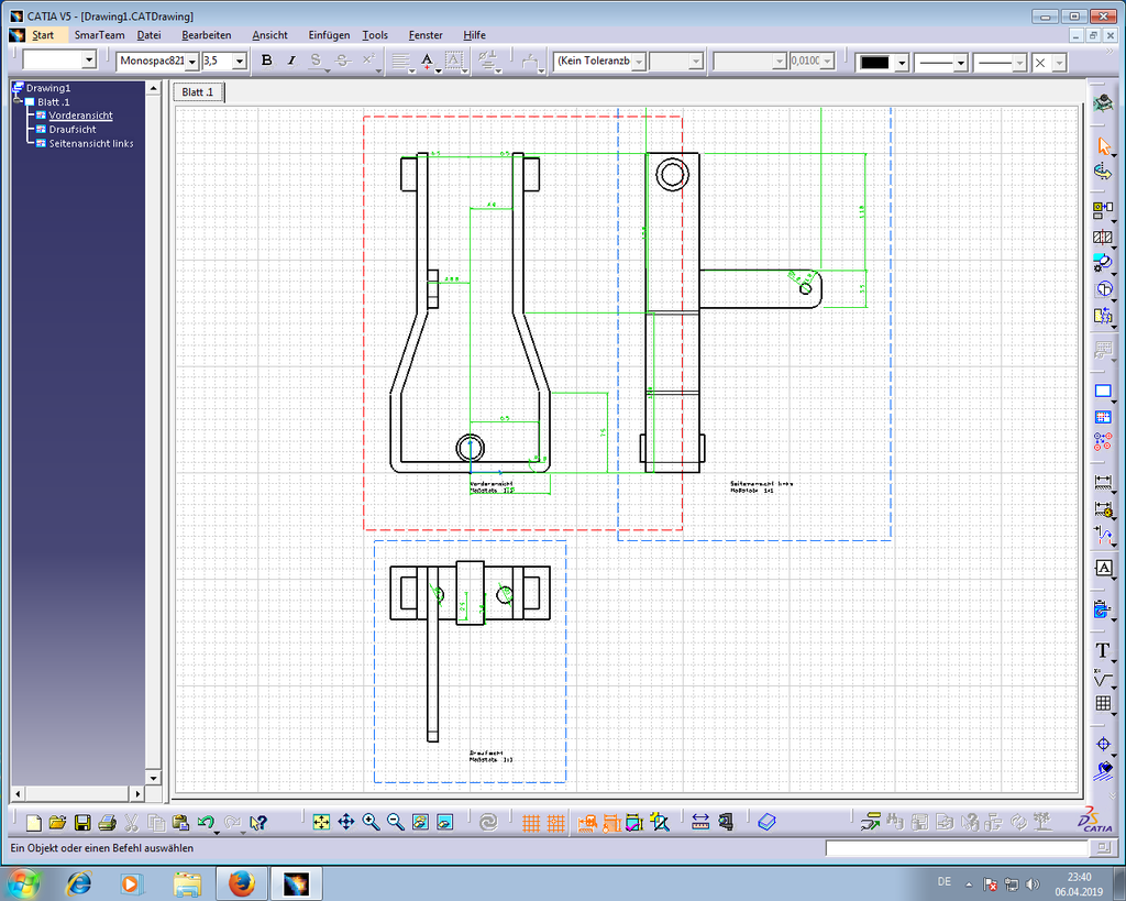

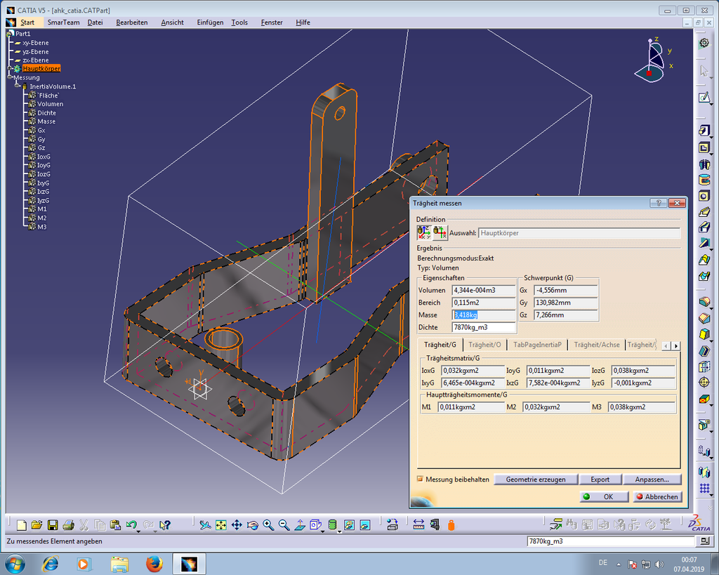

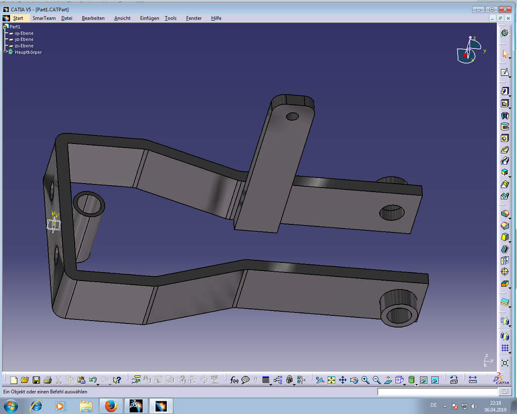

I had a little time :techie-ebay:
Thanks again to pf..... for the dimensions.
Edited by wheeliepower

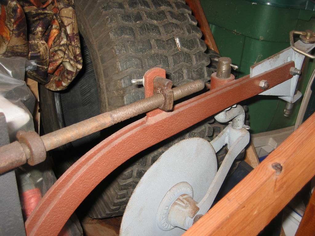

another picture
