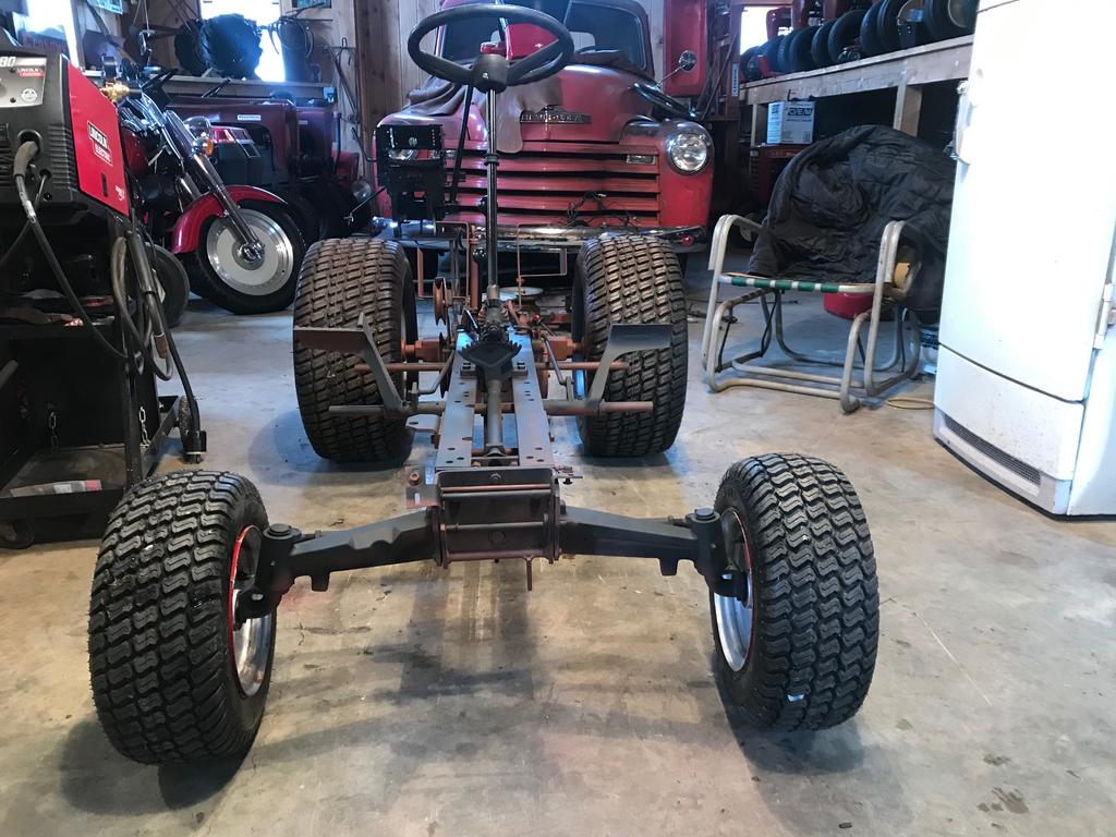

So...I took a look at my tractor today.  I'm not so sure the front end swap will work how I want it to.  The crank on the predator sits lower then standard so the belt angle to the mule is much less.  The belt is much closer the front axle now then it was before.  I think that by adding the forward swept axle would create clearance issues and the belt would hit it.
I think I am just back looking for a 48" deck.
stevebo
Might look something like this. Mine is a 416-8
WildmanC120
Are all the axles notched like that for the belts?
bds1984
Yes they are but I think it is more for the single stage snowblower tensioner .  I went though this swap on my C165 a few years ago and for a time I ran just the front axle and wheels until I was able to get the old steering wheel off to install the gear-reduction set-up.  I had to make a custom set-up with the tie-rods, but that is nothing that cannot be done on a Saturday and a beverage of choice.  If you don't like the 60" deck, and cannot find any decent 48s off a C/3/4/500 series, you can find one off a 260 series and install your attach-a-mattic hardware and deck spindles/hardware as I did for my 48" deck.
But don't give up hope on running the 60" deck!  It'll be worth it!
WildmanC120
As long as all the axles are clearanced like that I should be ok.  I guess I'll just get the parts and go from there. I would really like to run the deck.  Would be great for my 3 acres.

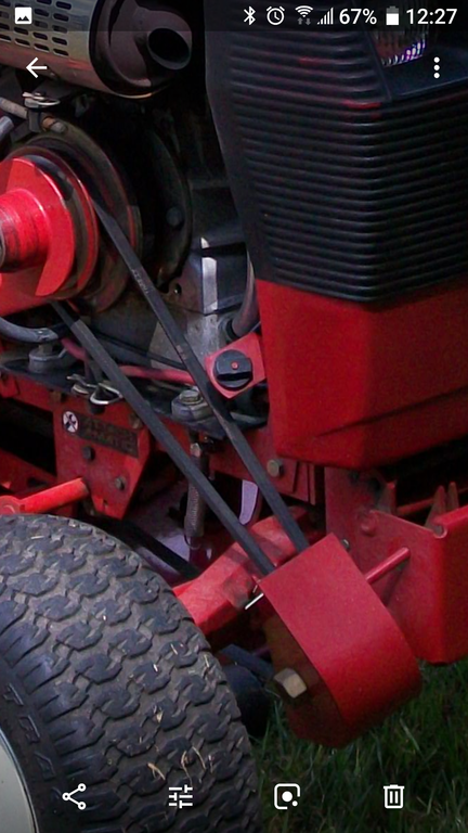

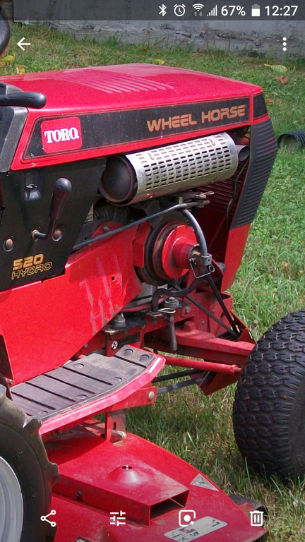

WVHillbilly520H
Here's my Anniversary 520H pics of the belt over the axle...

WildmanC120
Nice setup.  Thanks for sharing the photos showing the notch.  I should be ok then.
WVHillbilly520H
Bought that one new in 1998...
