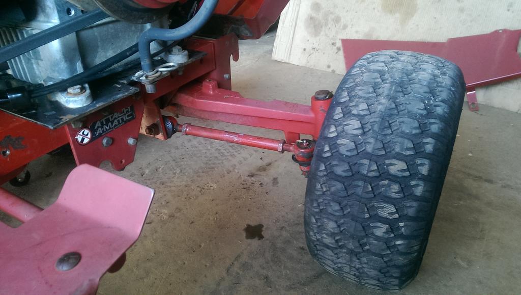

OK,The 520 mods can be done with little change to your current machine.If you want to mount the gear reduction steering it is a bolt on.The 520 H had an additional pair of 3/8' holes in the frame for the base unit.Thats the only difference and you can probably ignore this mod.The 520 HC didn't have the gear reduction steering but just the forward swept axle so you choose.I have all of these combos but not a 60 deck.
WildmanC120
How do you like your tractors with the swap?  Is it really as easy as just dropping the old axle and new one in?  I will probably go without the steering
JAinVA
Yes, Pull the axle pivot pin and stuff a swept axle in.The tie rods are another story.The horizontal steering shafts are different at the tie rod end.The HC and 520h use a wider plate at the tie rod end and you will need an HC or 520h shaft or make a replacement plate on you current setup.

I'm curious also Jim.   Do you need the 520 tie rods, spindles and wheels or will the C components fit?      I'm not considering a 60" deck, but more clearance with the right wheel would make it easier to remove and install the 42s and 48s.

Ed, I hope I can get this right.The swept forward axles need a different tie rod and horizontal steering shaft.The steering shaft for the swept axle are wider(bigger) at the tie rod area.If this helps great,if not I can provide picture tomorrow.

You could but keep in mind that each tie rod design is very different.The standard WH sets are closer to lawn tractors of the time and the HC/520h designs mimic the farm tractor design.

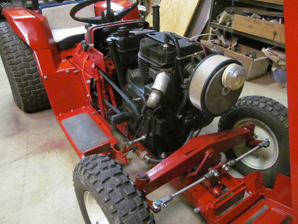

@Ed Kennell tie rods like you made for your low rider custom would work great. Just jump up a size for heavy duty..
:handgestures-thumbupright:
Ed Kennell
Fyi Wildman, these are the tie rods Jay @roadapples is referring to.

Ed,Hiem joints are the cats meow.

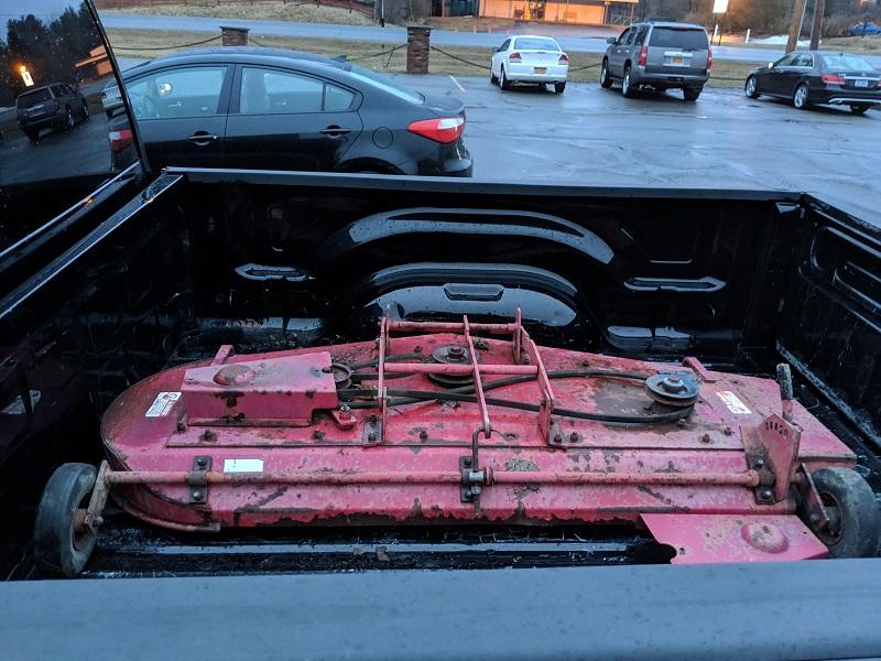

Well, it looks like a decision was made today.  Grabbed this 60" off Facebook Marketplace.  All the spindles spin too.  I don't think I could go wrong with it.  That's one heavy SOB too.
Edited by WildmanC120
Ed Kennell
Great price.  Did you get the mule drive?   The 60" decks use a special spring loaded mule drive.
WildmanC120
UGH...no. I didn't know that.
Will a normal one work since its not going on a 520 anyways?
