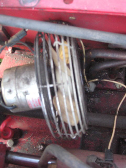

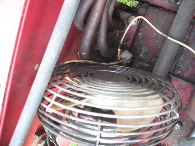

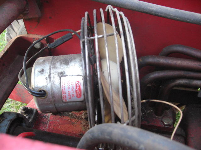

pacer 3,175 #8 Posted March 11, 2019 26 minutes ago, Dano101 said: supposed to be an electric cooling fan for the hydro pump looks like it’s missing on mine. I dunno, I've had 5 of the D's and only one of them had a fan, and it was the latest model. The others were older and there was no indication there was ever a fan. Hah, and the one I got was frozen solid and probably hadnt worked in years! 2 Share this post Link to post Share on other sites
pfrederi 18,289 #9 Posted March 11, 2019 Fans came only n later d series. You can probably adopt a defroster type fan very easily. i can't as i have the easy ride seat. no room for the fan. The correct mounting bracket for the fan will clear the rear PTO not the seat. 2 Share this post Link to post Share on other sites
Dano101 32 #10 Posted March 11, 2019 51 minutes ago, pfrederi said: Fans came only n later d series. You can probably adopt a defroster type fan very easily. i can't as i have the easy ride seat. no room for the fan. The correct mounting bracket for the fan will clear the rear PTO not the seat. Ok good to know. I think from what I can see with the model number mine is a 1980. If I look it had the power wire running to the back for a fan and you can also see where the mount was at one point and the 2 bolts are now missing. Also looks like it may of had a rear pto at one point because it looks like there was a bearing bolted in the rear where it should of been mounted. Is the fan even needed? Share this post Link to post Share on other sites

pfrederi 18,289 #12 Posted March 11, 2019 31 minutes ago, Dano101 said: Ok good to know. I think from what I can see with the model number mine is a 1980. If I look it had the power wire running to the back for a fan and you can also see where the mount was at one point and the 2 bolts are now missing. Also looks like it may of had a rear pto at one point because it looks like there was a bearing bolted in the rear where it should of been mounted. Is the fan even needed? i had an overheating issue and i mounted a small 4" computer type box fan. Didn't do much but neither did it move much air. Real solution was tear down of the hydro polished up slippers and one valve plate and a new valve plate in the pump. Runs strong now and no overheating issues. the overheating comes from the excessive internal leakage from worn and scratched parts. Share this post Link to post Share on other sites

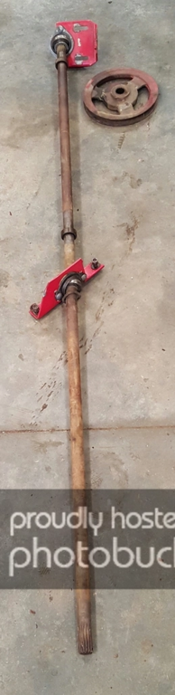

Super-C 4 me 612 #19 Posted March 12, 2019 hey @Dano101 this is the shaft that runs the rear PTO Share this post Link to post Share on other sites
Dano101 32 #20 Posted March 12, 2019 1 hour ago, bmiller0457 said: hey @Dano101 this is the shaft that runs the rear PTO @bmiller0457 now to find one 😅 1 Share this post Link to post Share on other sites
