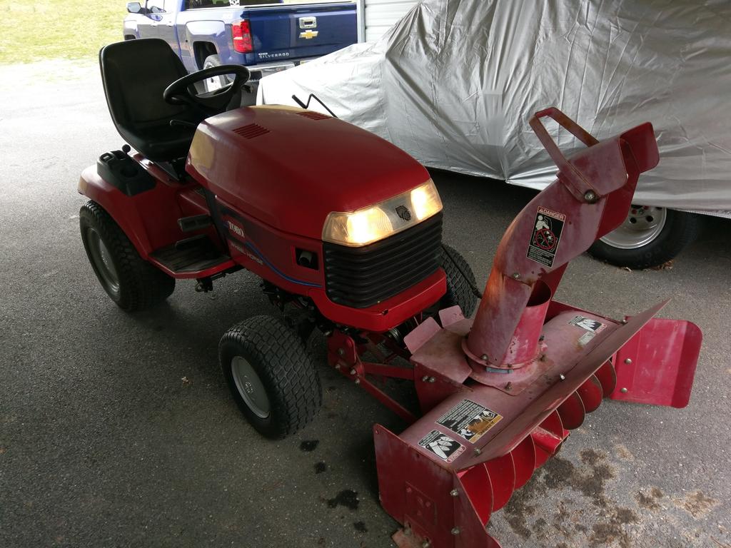

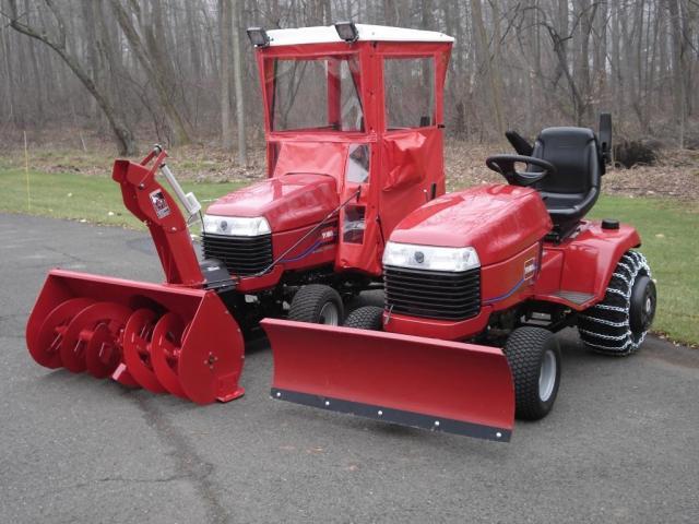

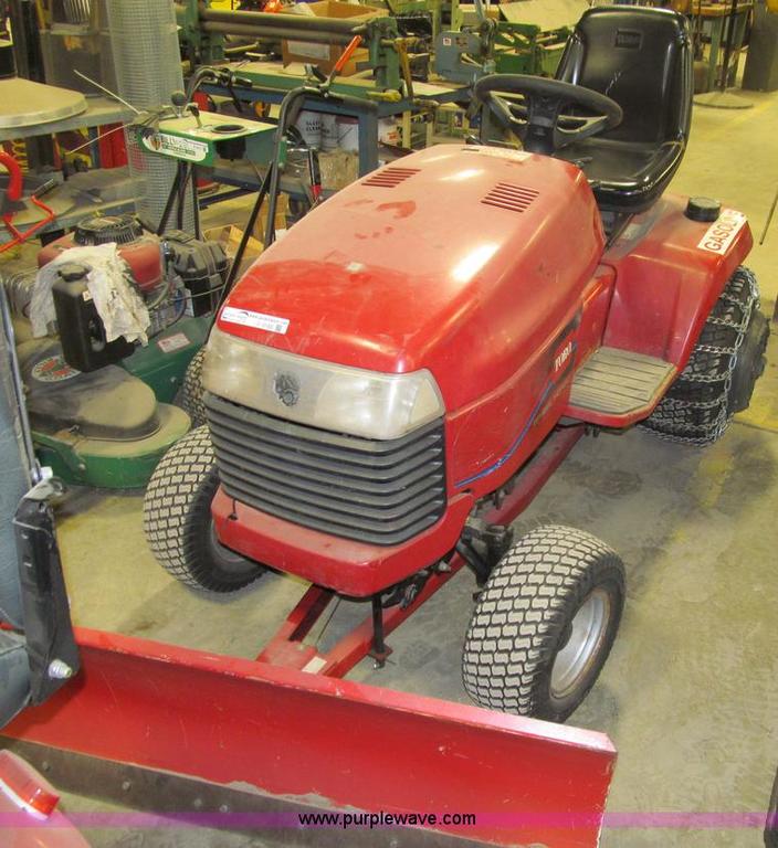

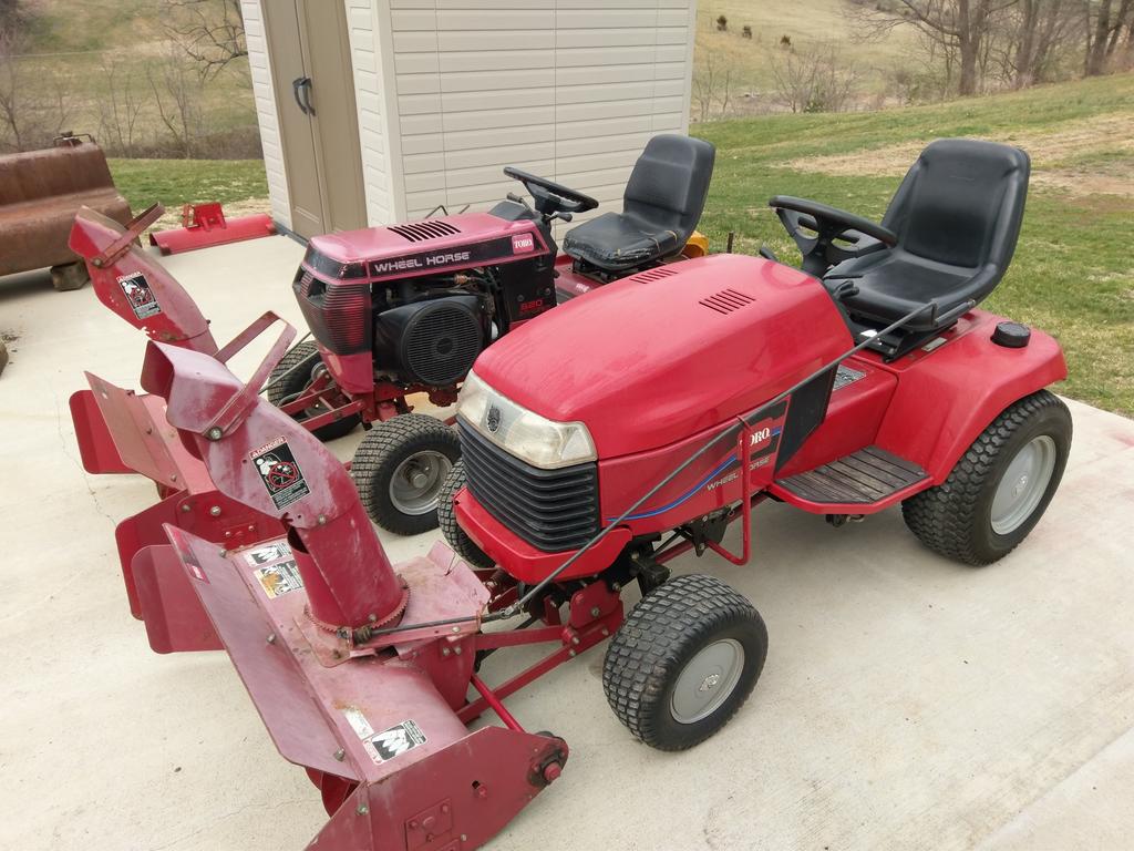

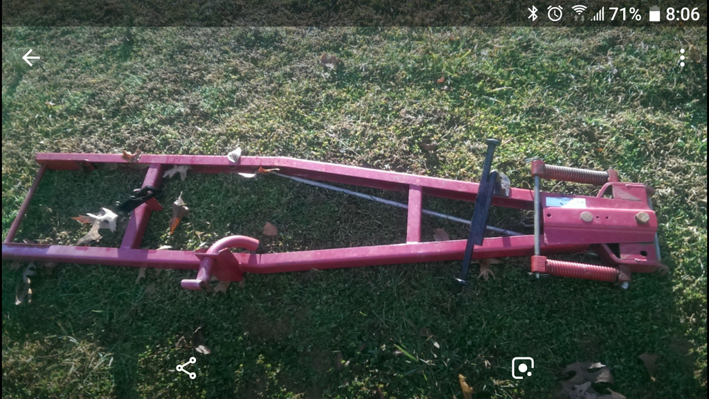

WVHillbilly520H 10,374 #4 Posted March 9, 2019 3 hours ago, Ghost66 said: Hello everyone, I recently purchased a Toro 520LXI for my parents. It has the 2-stage snowblower attachment. My dad wants a front end blade as well. So I am wondering if there is a way remove just the "blower part" of the snowblower assembly and replace it with a snow blade. I haven't had a chance to look at it very closely since my parents are 120 miles away. Thanks in advance for any help you can give me. I'll say no, first off it would be more of a pain to remove the blower housing from it's frame than swapping to the correct blade and frame...but with another style/brand blade and a lil fabrication it would be doable but IMO just not worth the headaches and hassle. Here's a few pictures hope these help put things in perspective... I had a 520xi with both a single stage thrower and the 48" snow blade the xi series was a bit faster foe implement change overs than the classic series IMO. 2 Share this post Link to post Share on other sites
