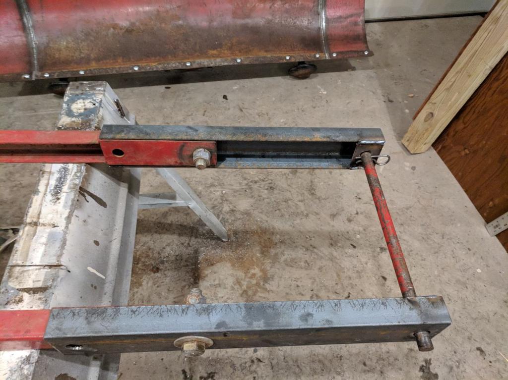

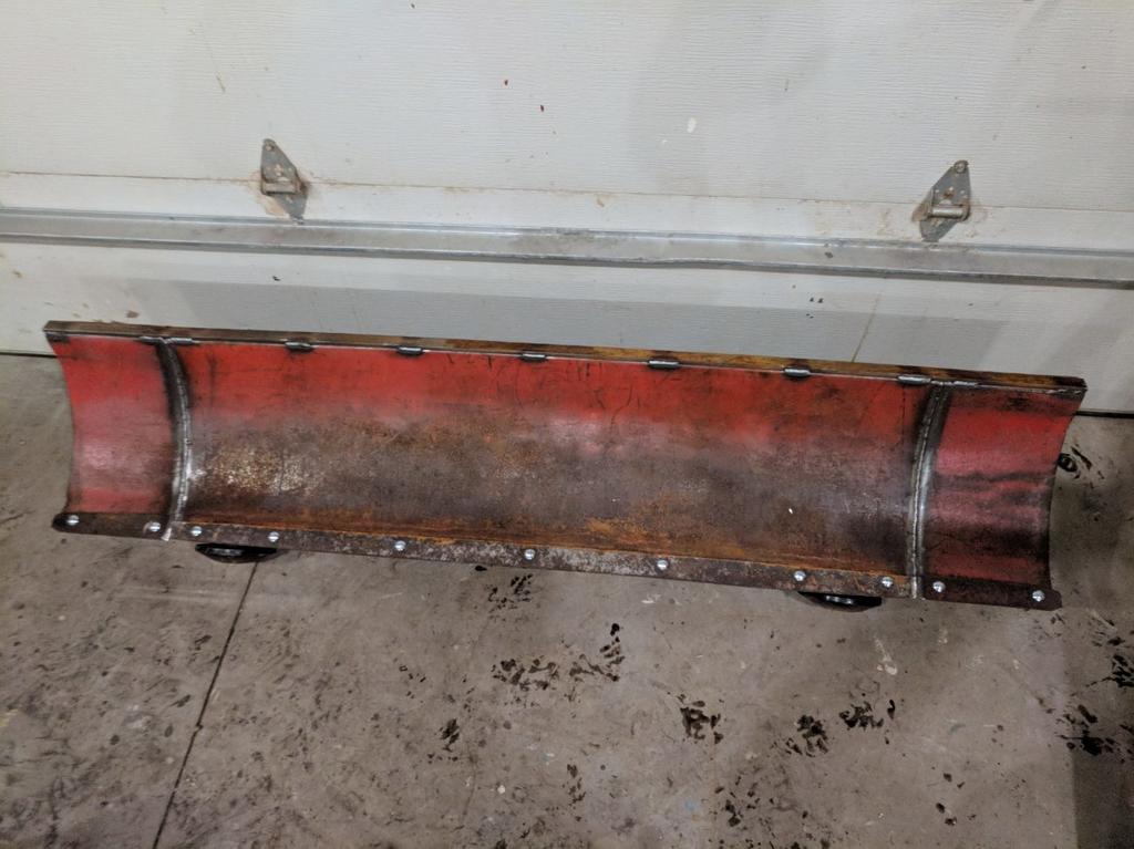

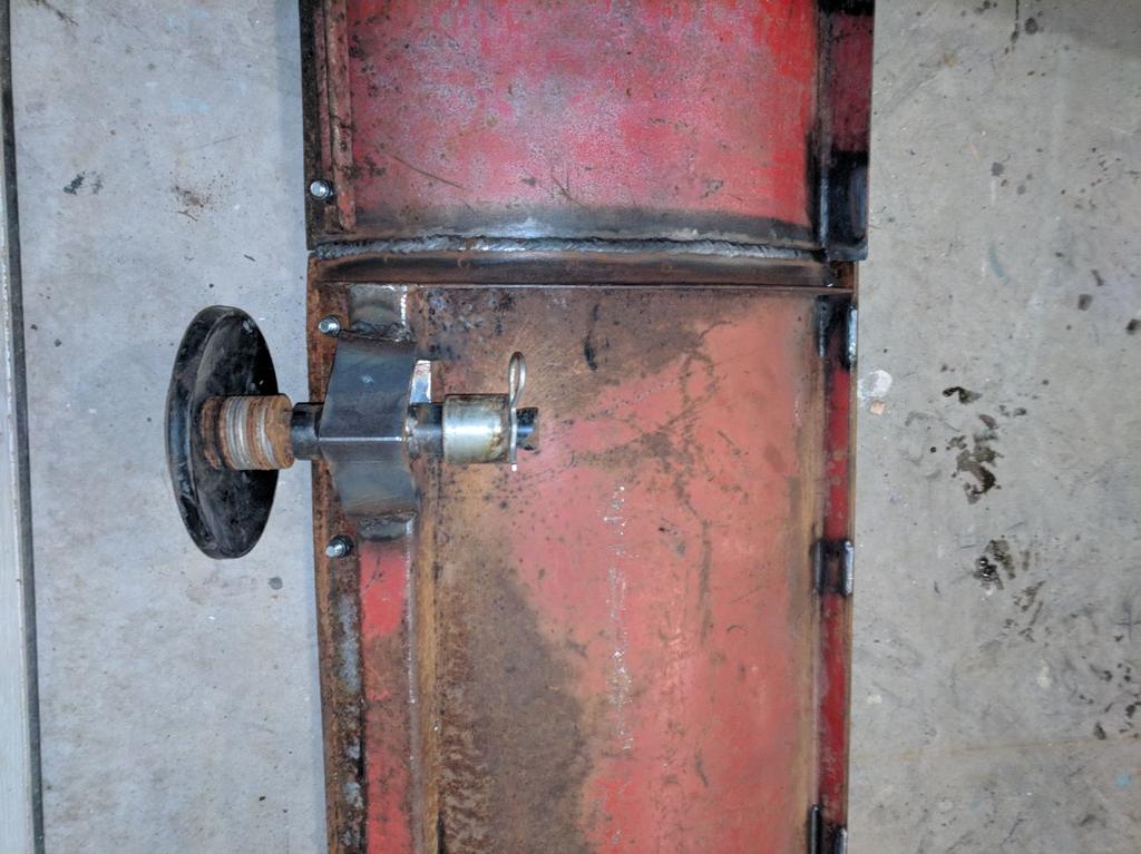

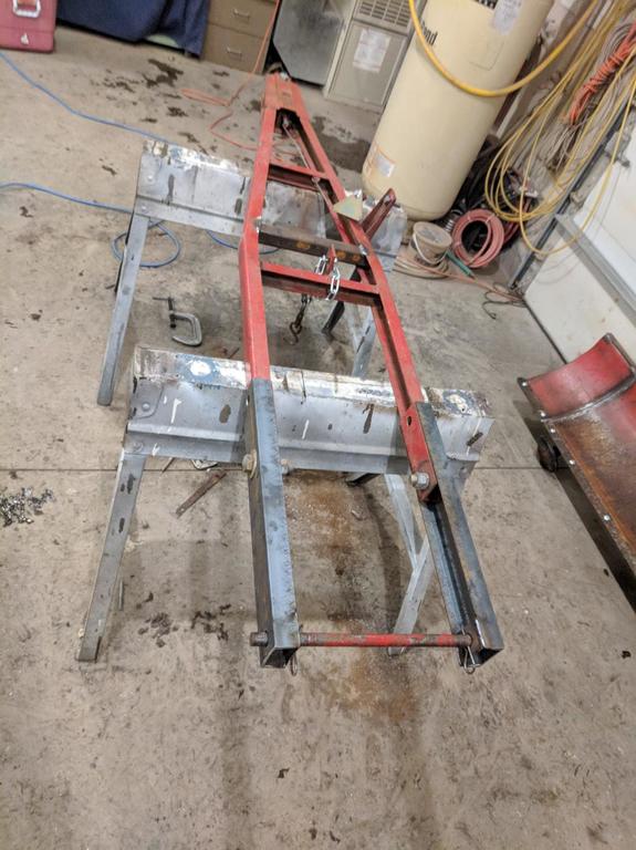

So this week we were back working on the C  195 dually setup now complete,  and the 72" in Wheel Horse snow  blade is just about done below are a  few pictures of the extensions of the plow it originally was a 54 inch wheel horse blade which is now 72"  can't wait to get it in action Burst_Cover_GIF_Action_20190214193429.gif.634228741199210097fcdb07a7720397.gif

mr biggs, with the added side thrust and over all stress added to the plow end of your tractor , suggest you might try adding this, Pete

Looks great!
I had a WH plow I adapted and made 72" for my rhino. Really moved the snow.

On my plow I'm just going to add two small chains one on each frame rail criss cross them to the plow and bolted to the frame so I still have my up and down movement ,  the chain will allow it to move slightly about 1-2  link each direction I will post some pictures when it's done and on my tractor next week hopefully

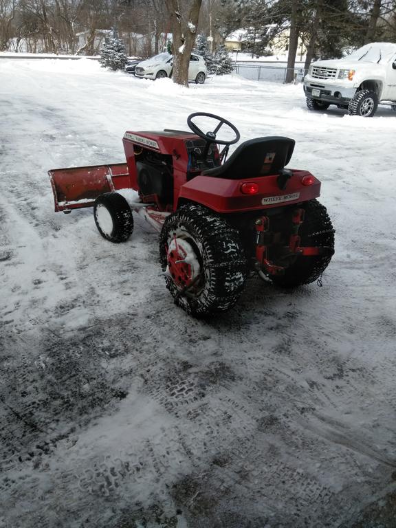

      Had the day off so I figured I’d get the plow situation set while I wait for mower deck parts.
      I have the rear tires weighted to 90# ea. The old ag tires are dried out and have some cracks but still hold air tubeless. I have a set of chains but they do a number on the driveways I plow. I see a tire spray that’s supposed to improve traction. Anyone ever try it? Is there something out the to soften old rubber? I the really don’t wanna drop $160 on new tires when these still hold air. 😁
      That’s my 4”x3/16” plow edge. It’s a 50” long piece I got from the cut pile at the local steel yard. It was cheap and has lasted a long time. I flipped it for the first time.
      I may put tubes and fill my fronts with RV antifreeze. I’m also gunna make a downpressure link soon.
       I haven't used it to plow in about 5 years due to transmission issues that are now solved and some timing adjustments that quelled almost all of my engine knocks.
