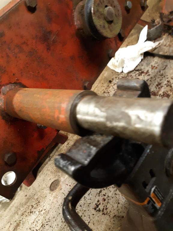

I need axle seals getting  from napa wht the part number  thanks
stevasaurus
Welcome to Red Square.  :occasion-xmas:  The seals are available from TORO...#83-2840 .  Grab a chair, they are about $23 apiece...but worth it for that horse.
Confirm first, that your bronze axle bearings aren't worn excessively...otherwise you'll just be throwing your money away installing them new axle seals.

To check you bronze axle bearings, grasp the axle shaft and try to move it up and down.  If it moves more than a tiny tiny visible amount your bearings are worn and need replacement.

Hey guys thanks  and yes my axle broze  bussing  are shot were get em

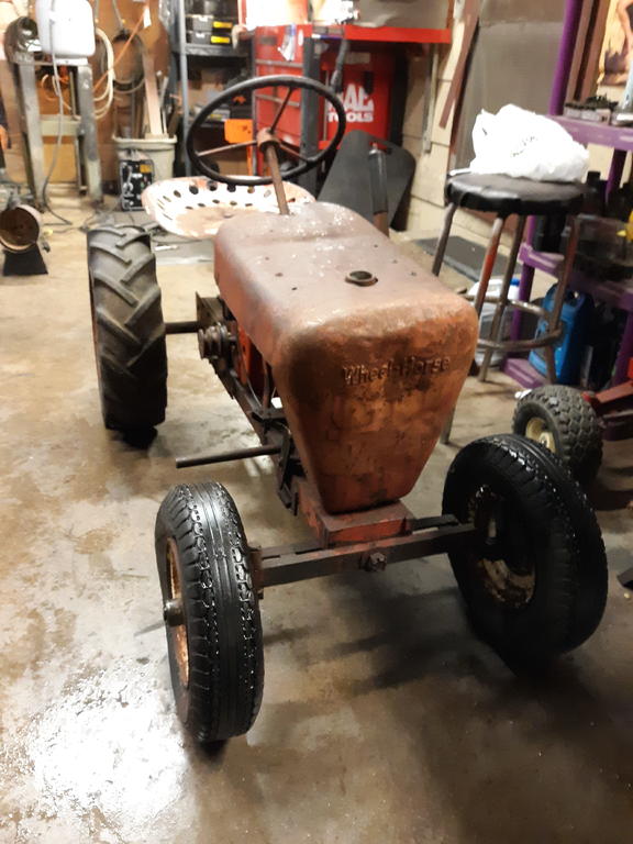

When I got it home big difference  now. Go check  out  my YouTube  channel  Jordan's tractors vlogs

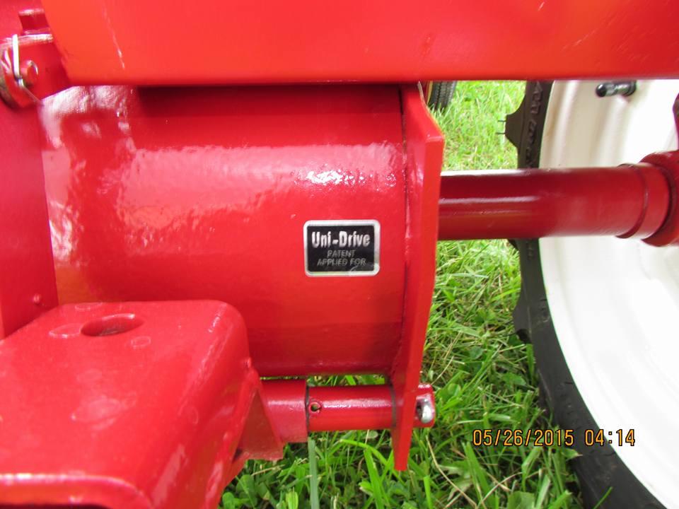

i bought mine from motion industries. when i redid mine. they had all the bearings,bushings, and seals. and i asked if they had american made ones and they did. So i bought all american made stuff. it was made here in the good ol usa so i wanted to keep it that way. it didn't cost but a few bucks more. well worth it to me. So mine has a totally rebuilt transmission. she works great!
