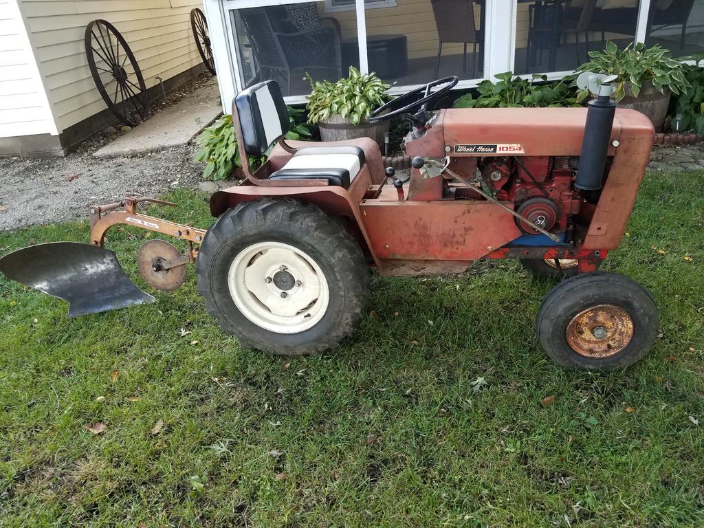

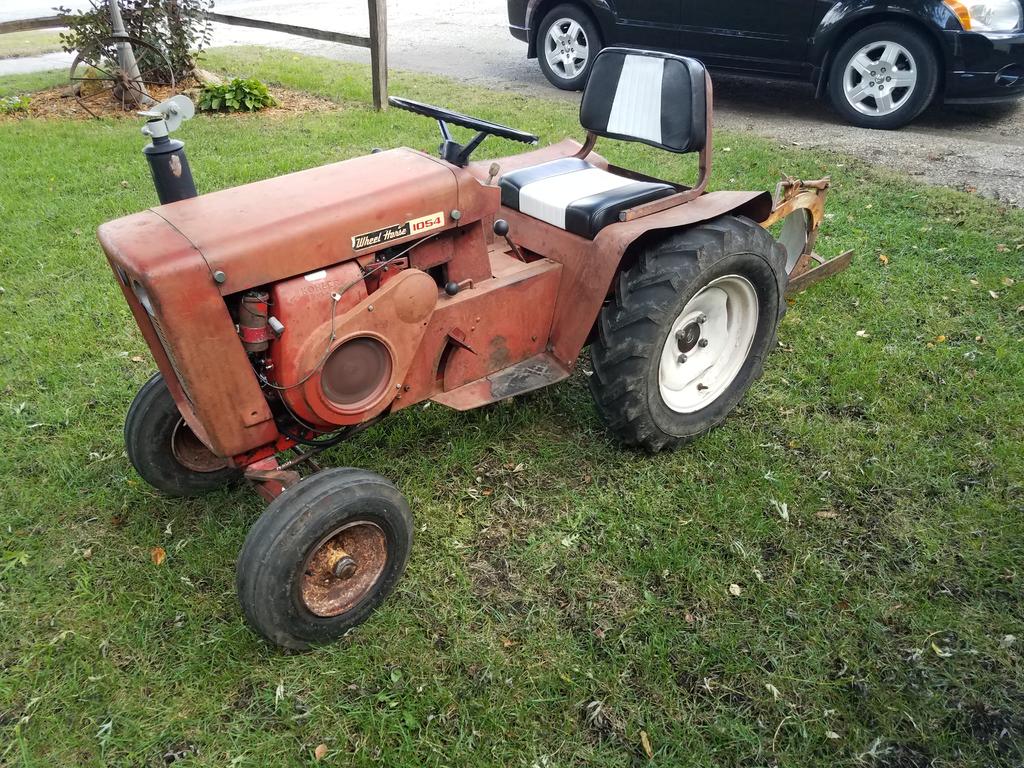

953 nut 56,047 #2 Posted February 24, 2019 (edited) I know that @PeacemakerJack's dad put a set of 7.60-15 tires on his and they were a good fit. Have you joined the 953 club? Edited February 24, 2019 by 953 nut 1 1 Share this post Link to post Share on other sites

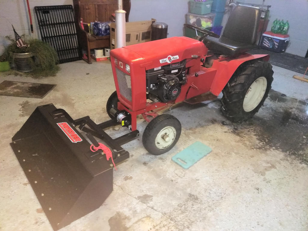

pacer 3,174 #3 Posted February 24, 2019 I also put the 7.6x15's from (https://www.stopandgotires.com/model.asp?model=Traction Implement I-3) on my 1054 and they looked really good. 1 Share this post Link to post Share on other sites
Herder 2,354 #4 Posted February 25, 2019 Goodyear 7.60/15. Tire sizes are limited 1 1 1 Share this post Link to post Share on other sites

Shynon 7,469 #6 Posted February 25, 2019 I have Goodyear 6.70-15 ags on my 1054. They were a little spendy but i like the look. 2 3 Share this post Link to post Share on other sites

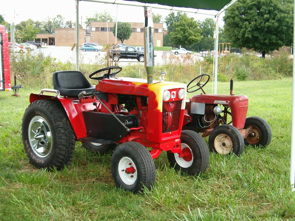

953 nut 56,047 #7 Posted February 26, 2019 Jim, if you aren't planning on using Ag. tires you could use Light Truck mud and snow tires. One of my 953s has a pair of LT 235/75-15 tires. They fill the wheel well but don't scrub it. 4 2 Share this post Link to post Share on other sites
Justy37 41 #8 Posted March 3, 2019 7.60-15 American Farmer Traction Implement I-3 tires. 4 Share this post Link to post Share on other sites
