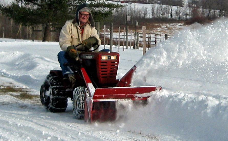

pfrederi 18,103 #5 Posted February 22, 2019 (edited) A lot depends on what and how much you have to clear. I ran a single stage on a 12hp hydro for a few years. In recent years went to a 16 hp hydro Did a 28 inch snowfall two years ago. i live on a hill that is windy I do not need or want to blow snow 30 ft in the air. 8-10 feet laterally is more than enough to get it out of the driveway. No comments about the hat. This was the Charger 12 several years ago Edited February 22, 2019 by pfrederi 3 Share this post Link to post Share on other sites

Sarge 3,464 #7 Posted February 23, 2019 18 hours ago, pfrederi said: A lot depends on what and how much you have to clear. I ran a single stage on a 12hp hydro for a few years. In recent years went to a 16 hp hydro Did a 28 inch snowfall two years ago. i live on a hill that is windy I do not need or want to blow snow 30 ft in the air. 8-10 feet laterally is more than enough to get it out of the driveway. No comments about the hat. This was the Charger 12 several years ago 2 Absolutely nothing wrong with that hat, Paul - I have one similar for hardhats and use it quite often. If you saw the damage from frostbite on my left ear that never goes away - you'd tighten the straps on that hat until your eyeballs bulged out. That Charger is one of the best tractor series ever made for snow or dirt work - limited slip rear axle, plenty of power and pure WH simplified build, can't beat it. I love a gear drive for a tiller, otherwise - hydro all the way. Sarge 1 1 Share this post Link to post Share on other sites
