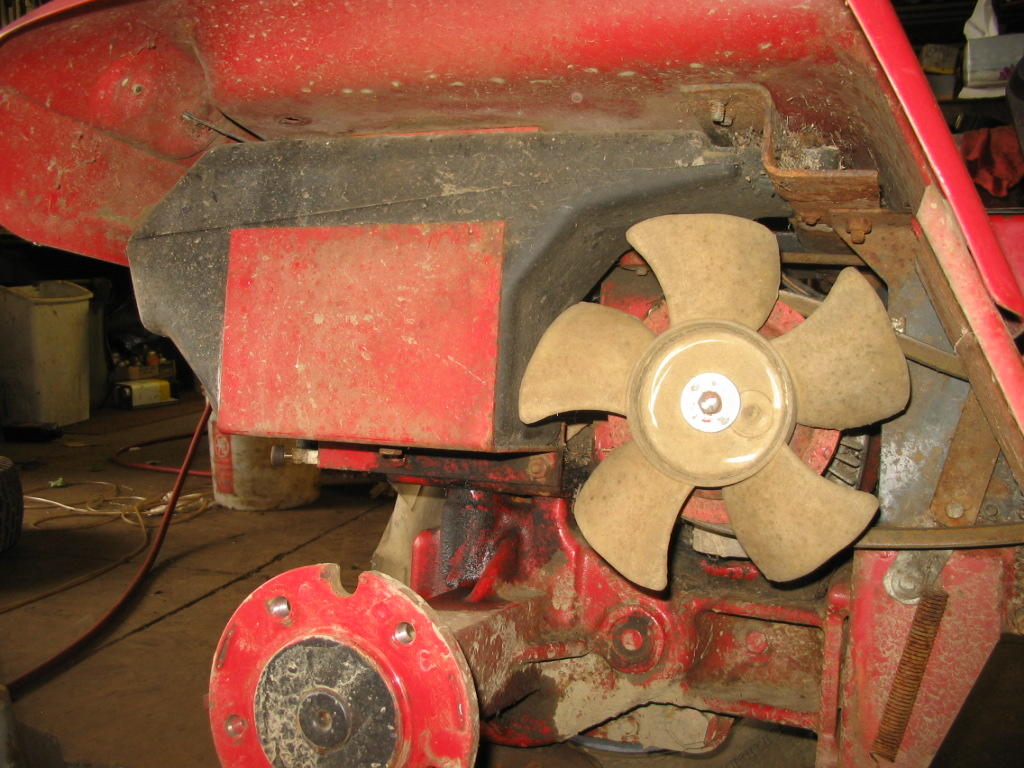

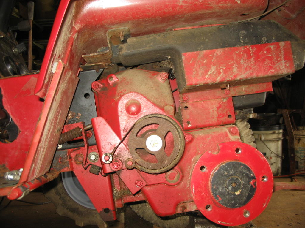

does anyone have pictures of the gas tank and brackets for a 314. I started reassembly and don’t quit remember how they all went on. I took pictures but they don’t clearly show me how I took it apart. Any help is appreciated
daveoman1966
hERE IS A 314-A.  Should be the same setup.

These may help as well.
Cleat

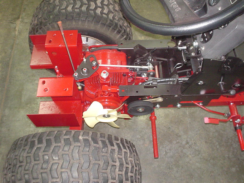

Firebug

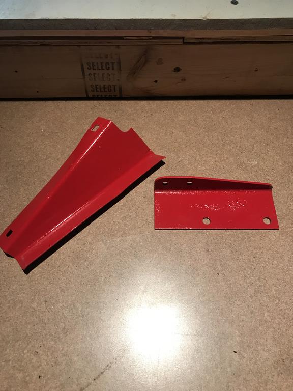

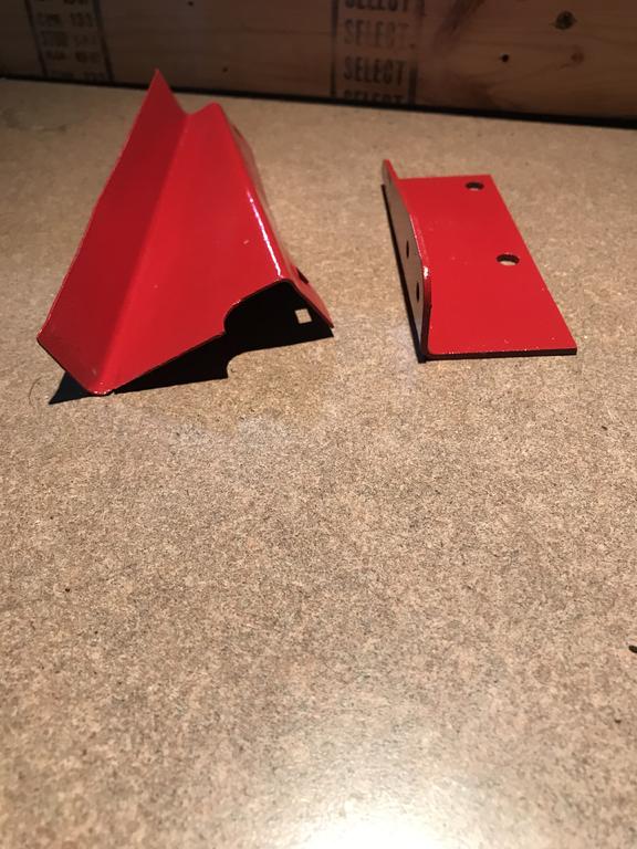

That helps out a lot. Thanks guys. It’s not a hydro. Got the tank and brackets on. Now I just need to figure out where these 2 brackets go
richmondred01
The one on the right goes on the seat/fender pan and is utilized to hold the lift cylinder for the seat.
the one on the left goes on the passenger side running board and is the drive belt guide.

Firebug
I really appreciate it. I thought I took good pictures as I was disassembling but when I went back through them I couldn’t find pics of these parts
