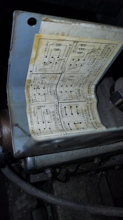

Sarge 3,473 #1 Posted February 19, 2019 Ok - I'll be the first to admit it > I am no Electrician. I can do basic cords, outlets and have installed a few panels (with a sparky buddy to approve/guide) - but that's my limit. Most things I can look at a diagram and figure out on 1ph equipment - but for some reason, I just cannot wrap my half-dead skull around wiring this motor correctly on my son in law's lathe. It was wired to run in one direction only - I suspect that is due to someone that owned it previously couldn't figure it out either, lol. Need both directions functional so I can run some operations to make parts for my own Enco, which is about to undergo some fairly major repairs to worn parts. Without a second and operational lathe - can't repair the other one that is leaking and about as sloppy as a lathe can get, mine has been badly abused. Here is what he's got - older Craftsman 6" lathe. Basically, the late 50's version of the Atlas/Craftsman. Single phase Craftsman general purpose 1hp motor - dual voltage. Furnas R44-C drum switch with Forward/Off/Reverse positions. From what I've read for the last 2 wks, most setups on single phase motors require the double "L" configuration in the drum switch - this one is set up differently and by the diagram in the cover can seem to handle both single and three phase motors. Where I'm really lost is inside the motor itself where the wiring is on the board terminals and how the wiring diagram is laid out on the motor tag. Here's what we have - Craftsman 1hp motor - Model 113.12151 Cat. 1215 This is the Furnas R44-C drum switch - need to set this up to run the motor on 1ph 115VAC. The switch handle is oriented at the top of these drawings. I think the starred note on the lower right drawing for the split phase motor use is for a jumper wire? Switch contact layout and function - As far as I can tell - the diagram that relates to the motor he's using is the split phase/1ph diagram in the corner of the label. I should have grabbed a pic of the motor's internal terminal connections - but I can get that if we need it. Need to figure out which terminal in the drum switch gets the hot lead connected from the switch diagram and which wires to extend to the drum switch from the motor to get it right. I almost believe a jumper will be necessary to make the reverse function, but not sure of that? Found a picture of the plain R44 switch - Almost all the machinery forum threads I've found had used Photobucket and most of those links are either dead or the photos are missing, which is no new thing to anyone. This motor does have a thermal reset switch installed on the case, btw - not sure if that is relevant or not. Any of our resident electricians have a clue on this thing? I'd like to start tearing my lathe apart so I can get it fixed - which, in turn - is needed to get the Atlas Clausing drill press work finished so I can clean up my shop and move forward onto some of the tractor projects and parts. All of this reading/searching has left me with a migraine lately - think I let the magic smoke out my head trying to figure this thing out. Sarge Share this post Link to post Share on other sites

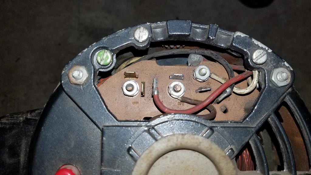

Sarge 3,473 #3 Posted February 19, 2019 (edited) That's exactly what has me so stumped, that wiring diagram is pathetic at best. I did get a picture of the terminal plate in the motor. The way the terminals are located in the plate is why I'm confused. I only have 4 wires to work with - red/white/black/brown. Tried using my DVM to find the main pairs of each winding, but that test didn't make any sense, as some were ringing zero. Maybe it's due to how the neutral side is wired? The tag shows red and black as being swapped for the direction of rotation. Not sure, but maybe I should try testing each terminal for continuity to ground? The extra terminals located next to each other don't all show continuity, either - that really has me scratching my head. I know the run winding should be a low ohms reading and I did get one pair to read that way. Came out to 3 ohms. The other pair was around 27 ohms, but kept changing on my DL389 Phoenix meter. I hate auto-ranging meters for stuff like this and should do it again with a regular analog version. Since this motor is dual voltage, is that why the terminals are so odd? Wish a buddy of mine wasn't tied up with things at home, he'd have it running in short order if he could get here. Sarge Edited February 19, 2019 by Sarge missing details Share this post Link to post Share on other sites

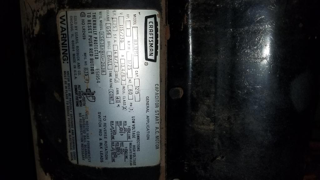

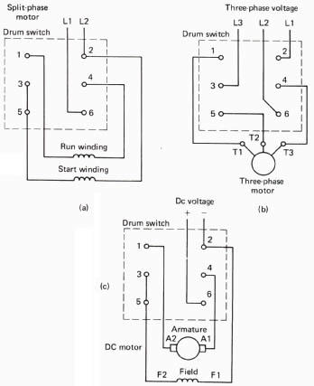

bc.gold 3,406 #4 Posted February 19, 2019 (edited) You have to remove the motor leads from the motor back plate, extend these to your drum switch as shown in this diagram. As you can see from the wiring diagram attached to your motor the red and black being referanced have the spaded ends located at terminal numbers 2 and 5 On a side note, once the motor is up to speed the contact points on the start winding are opened via centifical force a common failure of small electric motors starting under load is for the contacts to burn out and these are easily replaced. Worse case scenario is that the contacts have welded together and have burned out the start winding's. SARGE this is the schematic from the tag on your motor. the red and black leads are the start winding's. Edited February 20, 2019 by bcgold Share this post Link to post Share on other sites

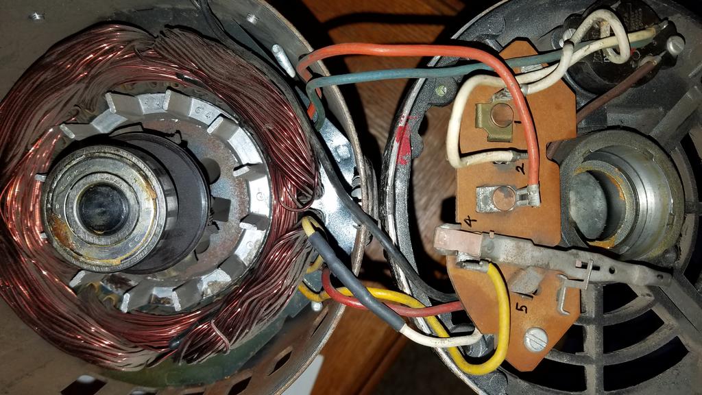

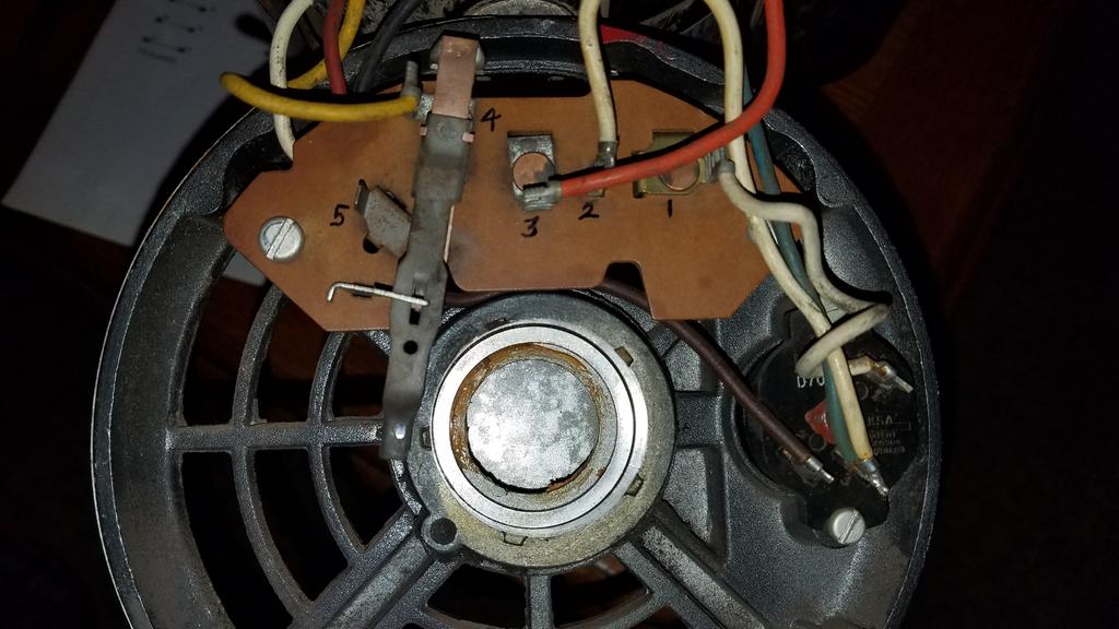

Sarge 3,473 #6 Posted February 22, 2019 Dug a little deeper today when I had the time to really study the thing further. Interesting how the protection switch is wired into both the run and start windings. I took the time to map out the connections from the terminal board - as well as the Klixon K5A protection switch. I numbered the back side of the terminal insulator plate to better understand how it is wired. T1 - white lead to P3 T2 - white lead to P1 & red lead to start winding T3 - brown lead to P2 & orange run winding T4 - yellow & white leads to run winding T5 - black lead to start winding Here's what it looks like - Any clue on how that protection switch can be retained to protect the motor's wiring? Sarge Share this post Link to post Share on other sites

bc.gold 3,406 #8 Posted February 22, 2019 (edited) Your start leads connect to each side of the center poles on the drum switc in the begging do not concern with color then your run leads go to the outside poles then on the opposite side on each end pole L2 and L2, if the motor runs in an undesired direction on start up swap over the two center leads. The chassis ground connections should be obvious. The hand drawn diagram I posted above is correct, you'll have to extend the start and run wires coming from the motor so that they'll reach the drum switch. And stop trying to figure out the internals of the drum switch and put your trust into the schematics. Now for a bit of humor, years ago I used to do a bit of sub contracting for a water well and pump company. One day was called up to do a new install on a shallow well pump, everything went without a hitch. Got s call the very next day from a very irate manager who was now telling me in so many words that I would be going back the the customer I had previous installed the new pump the day before had quit working and that I would be doing it on my dime. I stop in at the shop a grab a new pump to take with me should it be needed, on inspection what I found was that a slug had managed to find its way into the motor via the open end plate causing the motor start contacts to remain closed after starting. Burned out the start winding. Edited February 22, 2019 by bcgold Share this post Link to post Share on other sites

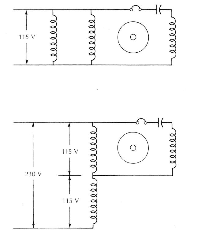

Sarge 3,473 #11 Posted February 23, 2019 The terminal plate in the motor is where the problem started - someone else had been into this thing before and changed how it was wired. That change led to the diagram making zero sense and why I was so confused about any drawings that otherwise would apply to this motor. I finally figured out the pole wiring last night and got it wired so they work together instead of against each other - polarity on these matters. With that done, I got it tied together properly at the terminal plate and tested the motor - works perfectly. I'll take it over to the lathe later today and wire it up to the drum switch and get it installed. We'll spend the rest of this weekend working on going through the lathe and get it properly oiled and cleaned so it can be put into service. Pretty excited to finally be able to make the necessary parts for my Enco and get that sloppy bugger back into proper working order again - I've been putting up with it for far too long. It took 3 drawings to apply to this dual voltage motor - this is the correct diagram to tie the poles together so they don't fight each other So, using a combination of this motor drawing and ignore the drum switch wiring (wrong drum switch - this lathe has an R44-C) ....and use this drum switch diagram for the R44 series switch - Sarge Share this post Link to post Share on other sites
