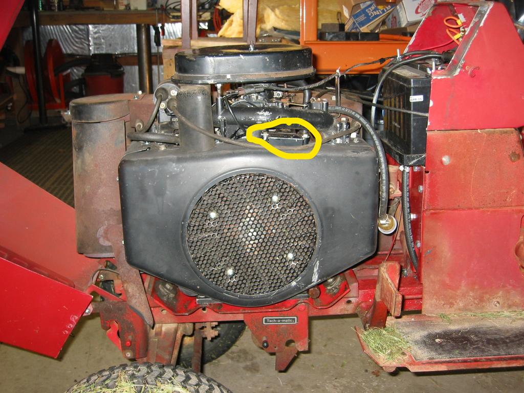

wheeliepower 141 #1 Posted February 18, 2019 hi, can anyone tell me where to find the regulator on a wheel horse C-175? Thanks manfred Share this post Link to post Share on other sites
pfrederi 18,061 #2 Posted February 18, 2019 Top of the blower housing circled in yellow 1 1 Share this post Link to post Share on other sites
wheeliepower 141 #3 Posted February 19, 2019 (edited) thanks for your response german proverb what applies to me here => "Ich habe den Wald vor lauter Bäumen nicht gesehen" => "I haven't seen the forest because of all the trees" determined after the measurement regulator defective, I already ordered the new one Edited February 19, 2019 by wheeliepower 1 Share this post Link to post Share on other sites

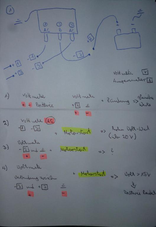

wheeliepower 141 #5 Posted February 19, 2019 (edited) that I believe you !!!!!!!! But I come from an area with many apple juice and cider [ german => "viez" ] ) - I don't know if you know that. Make a big head anyway !!!!! here still is my plan to measure the regulator and the stator => Edited February 19, 2019 by wheeliepower Share this post Link to post Share on other sites

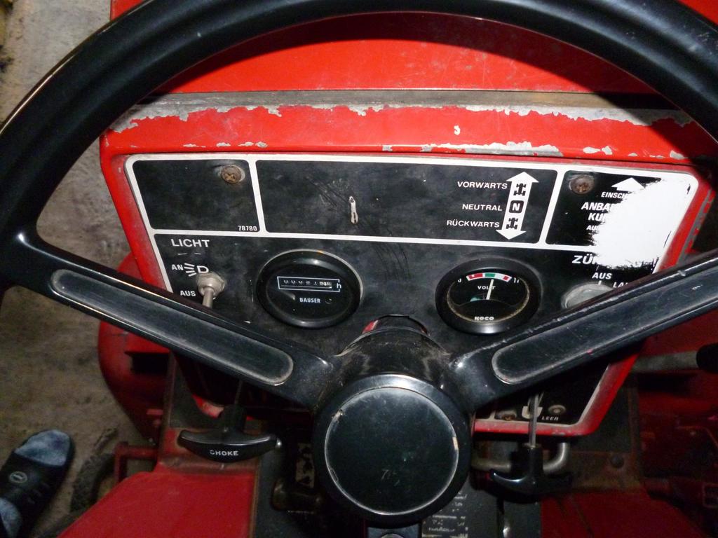

wheeliepower 141 #6 Posted February 22, 2019 I'm worried about an ampere indicator (the built-in indicator was burned down at the previous owner) That's why I decided to install a voltmeter. When measuring the electrics ( plan listed above ) I noticed that the regulator was defective too. Luckily I still had a part in reserve. 212/5000 2 Share this post Link to post Share on other sites
