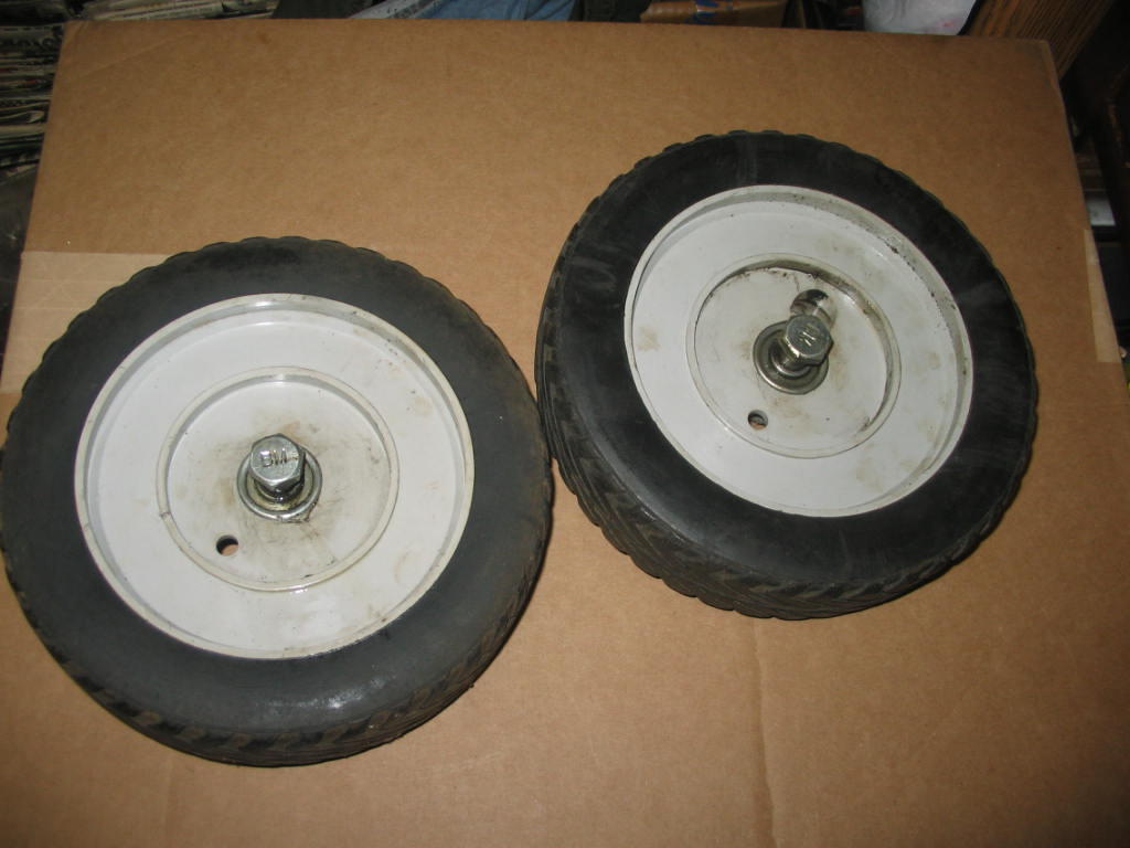

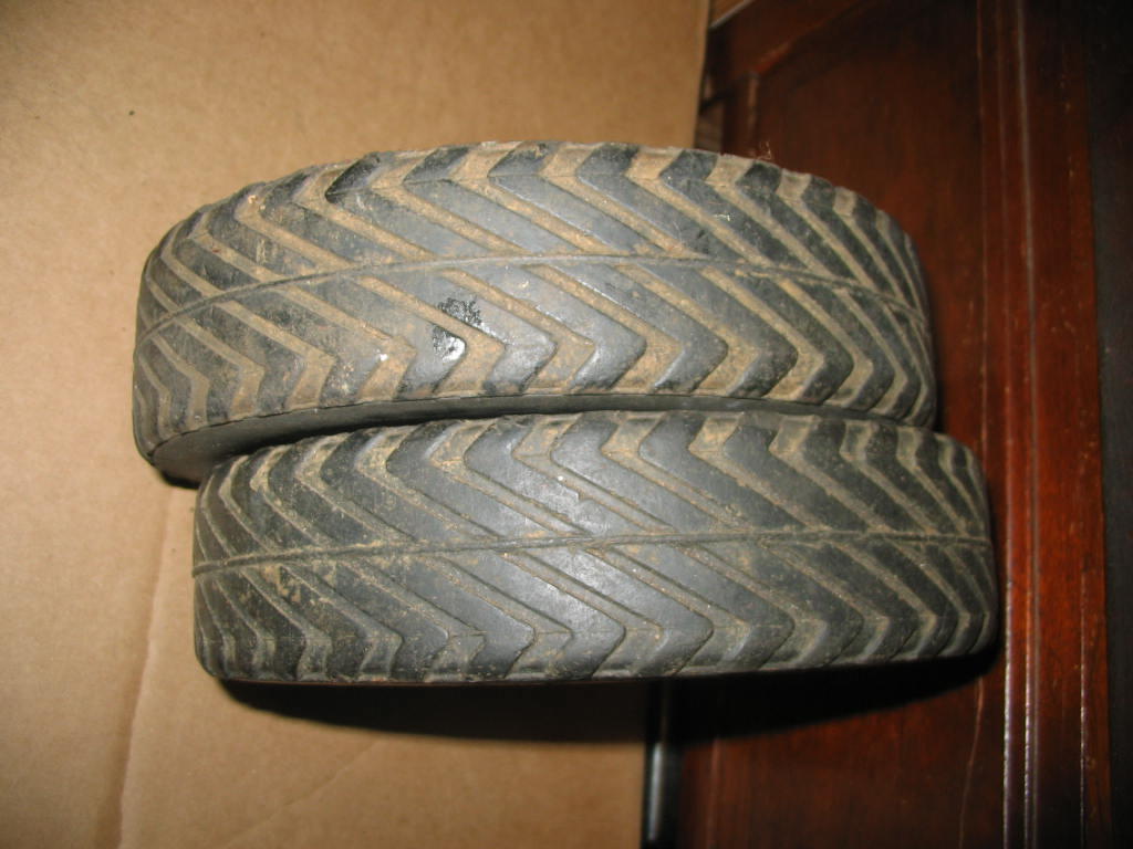

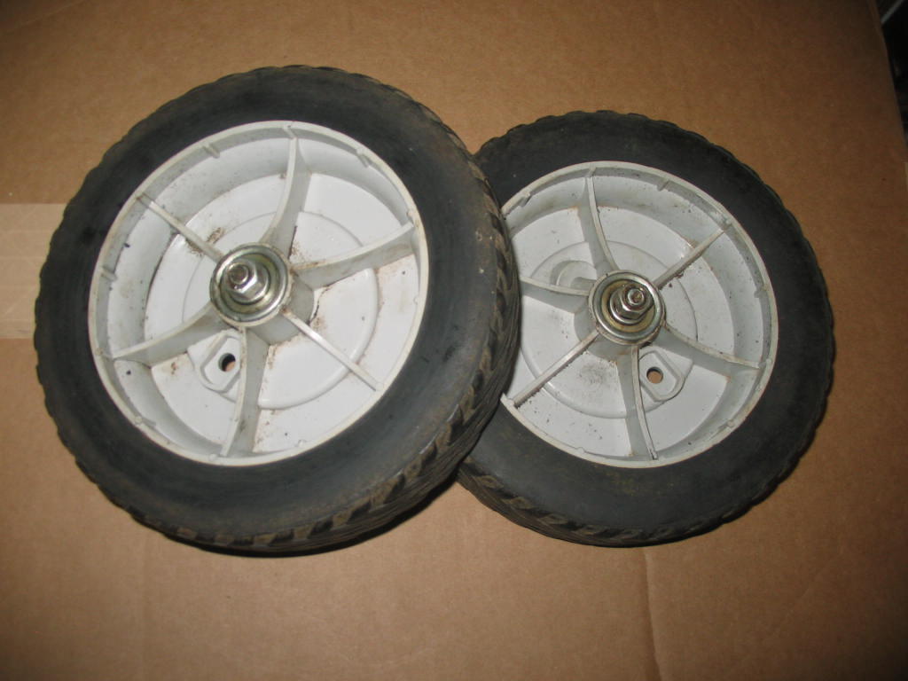

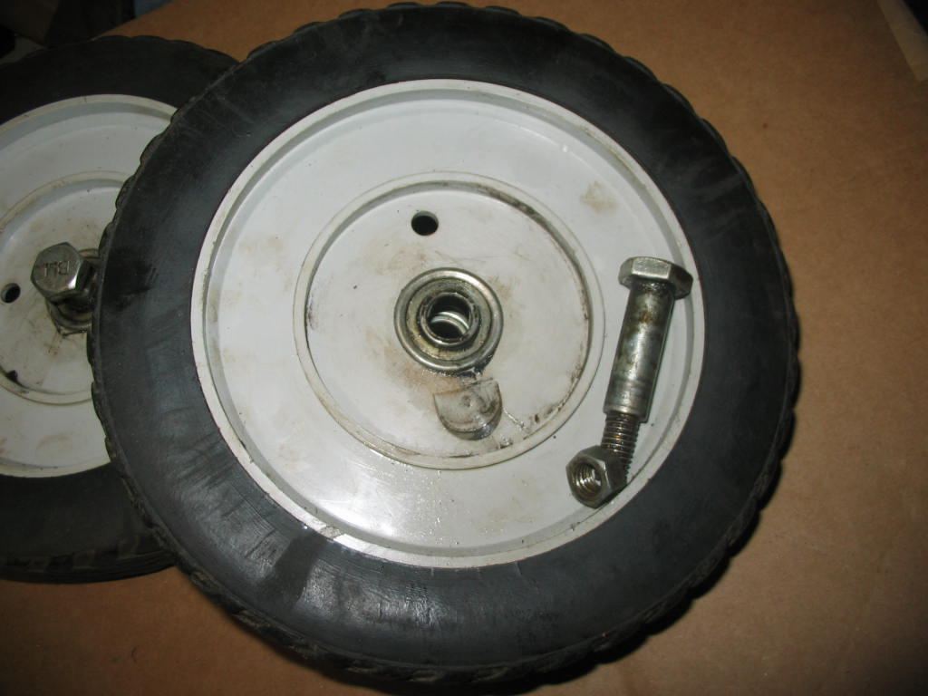

lynnmor 7,545 #1 Posted February 15, 2019 I looked up wheels for the 60" model #78390 deck and Toro now says discontinued, some websites show them for about $150 each. Be aware that the parts list is in error about bolts and spacers. One alternative mentioned here was the model #42427 wheel from Harbor Freight for $6.99 each so I bought a pair even though I know better. The bearings were pretty much junk so I knocked them out for replacement. Well the metal rims on these things are thin as paper and my opinion is that they will not hold the bearings in place for very long. The rubber tires seem to be OK and maybe I'll make wheels to fit the tires, but for now I installed them to see how long it takes for failure. The plastic wheels from Martin, part #ZP182RT-2C2 might be OK. If anyone has a better idea for a 8" wheel, let me know. 1 Share this post Link to post Share on other sites

lynnmor 7,545 #5 Posted February 16, 2019 On 2/16/2019 at 12:24 AM, peter lena said: TRACTOR SUPPLY https://www.tractorsupply.com/tsc/product/martin-wheel-8x250-8-in-heavy-duty-wheel-2-1-4-in-x-5-8-in-centered-hub PETE I was aware of those, the plastic did worry me but they might be the best available. Thanks for the reply. Share this post Link to post Share on other sites
