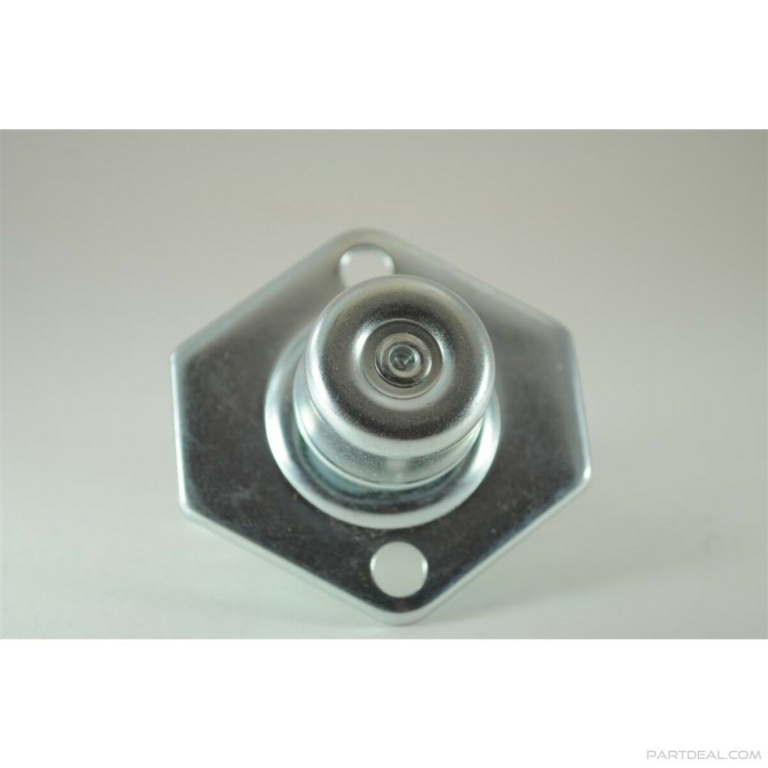

formariz 12,352 #7 Posted February 13, 2019 I have done that on a few tractors, mine and others. Unless you have children that may try to start tractor when you don't want them to, I think the key is a bit of an inconvenience. If tractor is kept outside unprotected, switch lets water in and its just a matter of time until it deteriorates internally. I like the Cole Hersee heavy duty foot switches. Not too expensive high amperage and nearly indestructible. All you need besides that will be a simple on/off toggle switch to activate power to coil and perhaps a solenoid if you go that route. 1 Share this post Link to post Share on other sites
