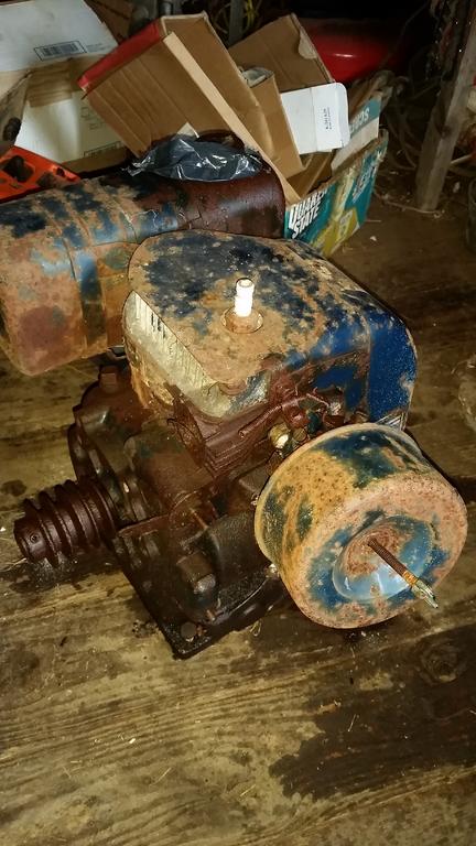

I recently picked up this k181 for free. It is completely locked up and probably worth its weight in scrap. I was able to swipe bolts off it that were missing on the k241. I can at least practice honing and valve seat cutting on it if I can get it apart.
  • Excellent 2

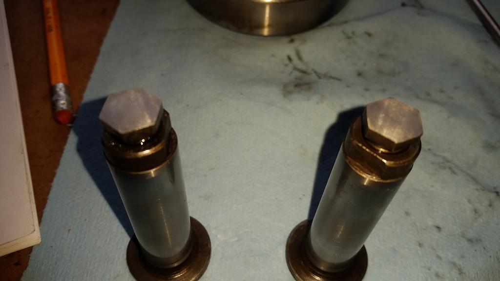

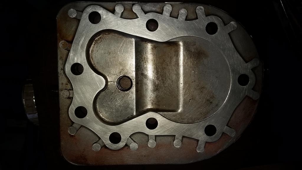

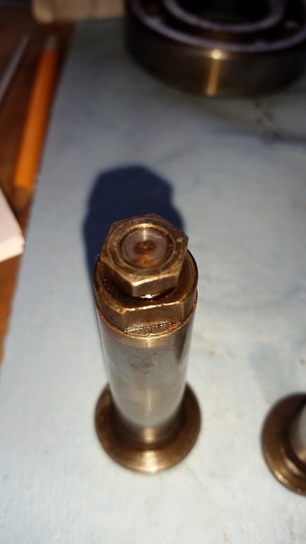

  On 3/23/2019 at 5:26 AM, tntatro said:
Since I'm waiting on parts I cleaned and flattened the cylinder head.
The valve lifters had pretty deep dimples in them. I measured the difference and one was sunken .0055" and the other was .0045". I flattened them with a file and then sanded them smooth.
Valve lifters wear areas  would have been case hardened, if you were able to file our already beyond the hardened skin.
If the cylinder bore is water damaged probably needs an oversize piston anyhow, the wrist pin will parallel the crankshaft anyhow I drill the piston top full of holes making it easy to break up.
Once that frozen piston is out the the way the rest of the disassembly is a snap.
