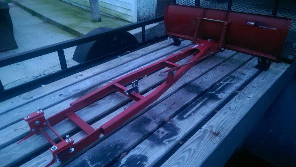

Stepney 2,335 #1 Posted February 9, 2019 Hello, all. Going to check out a Charger 9 in the morning. Fellow has a 0648BS01 snow plow. He says it's off an newer WH, but a tab can be welded on to work with the original lift .. something about it just doesn't look right. I searched the model number and literally nothing comes up. Did find some under title 0648BC01, but not BS. Anybody have an idea? It just looks odd to me. I'd rather not buy it if it couldn't be made to work. Share this post Link to post Share on other sites

ebinmaine 69,578 #3 Posted February 9, 2019 Spens that fits the lighter duty lawn tractor series. They can be made to fit but I don't know how. Maybe @WVHillbilly520H or someone else can advise. Or you can buy it and trade for the correct frame. 1 Share this post Link to post Share on other sites
WVHillbilly520H 10,376 #4 Posted February 9, 2019 (edited) 59 minutes ago, ebinmaine said: Spens that fits the lighter duty lawn tractor series. They can be made to fit but I don't know how. Maybe @WVHillbilly520H or someone else can advise. Or you can buy it and trade for the correct frame. That one is an easy fix for any long frame tractor just by adding the lift tab (unpainted part in the pic). Edited February 9, 2019 by WVHillbilly520H 3 1 Share this post Link to post Share on other sites

Stepney 2,335 #6 Posted February 14, 2019 On 2/9/2019 at 7:49 AM, WVHillbilly520H said: That one is an easy fix for any long frame tractor just by adding the lift tab (unpainted part in the pic). You wouldn't happen to have a measurement of that tab, would you? Share this post Link to post Share on other sites
ebinmaine 69,578 #7 Posted February 14, 2019 I can get you an accurate measurement off of my 1982 to 1989 48 inch plow later on today. Picture or two as well. the hole that is in that to accept chain link or bar pin is definitely a wear item. I might be prone to using a slightly heavier duty piece of metal for that application. Share this post Link to post Share on other sites
WVHillbilly520H 10,376 #8 Posted February 14, 2019 17 minutes ago, ebinmaine said: the hole that is in that to accept chain link or bar pin is definitely a wear item. I might be prone to using a slightly heavier duty piece of metal for that application. Only if you use the down pressure link quite a bit, after 40+ years the holes in my tab are barely enlarged...when getting those dimensions the tab isn't perfectly centered you'll need that measurement too. 1 Share this post Link to post Share on other sites
ebinmaine 69,578 #9 Posted February 14, 2019 2 minutes ago, WVHillbilly520H said: Only if you use the down pressure link quite a bit, after 40+ years the holes in my tab are barely enlarged...when getting those dimensions the tab isn't perfectly centered you'll need that measurement too. That probably would explain that. One from my first C 160 chassis was rounded out some, just like the rest of the tractor. Thank you for that reminder of The Off Center. I've noticed that but probably wouldn't have given it a thought. I'll get that too. 1 Share this post Link to post Share on other sites
