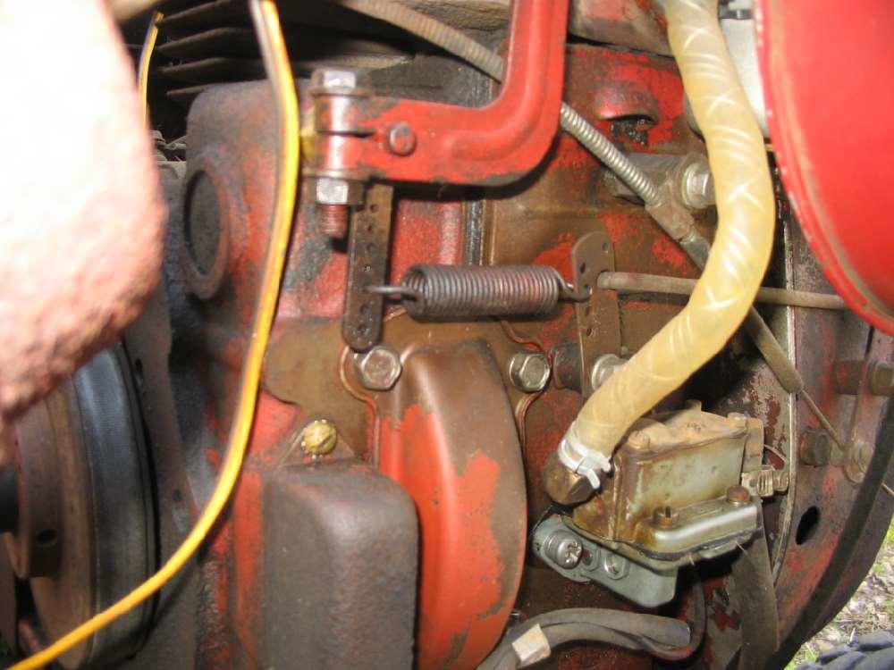

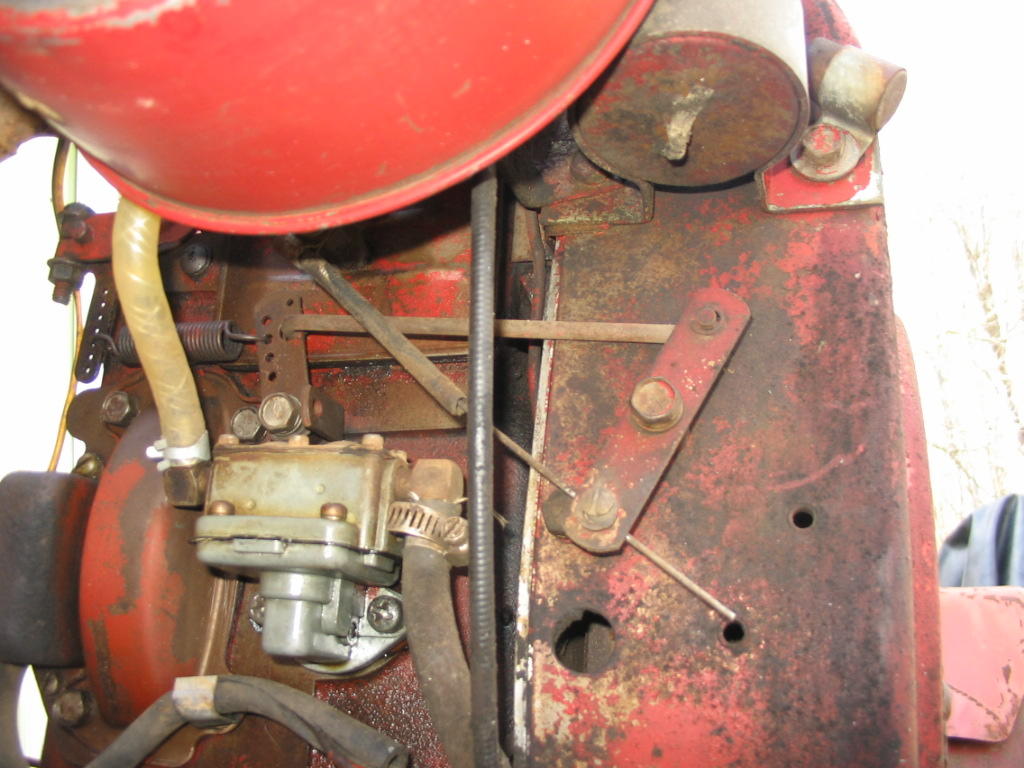

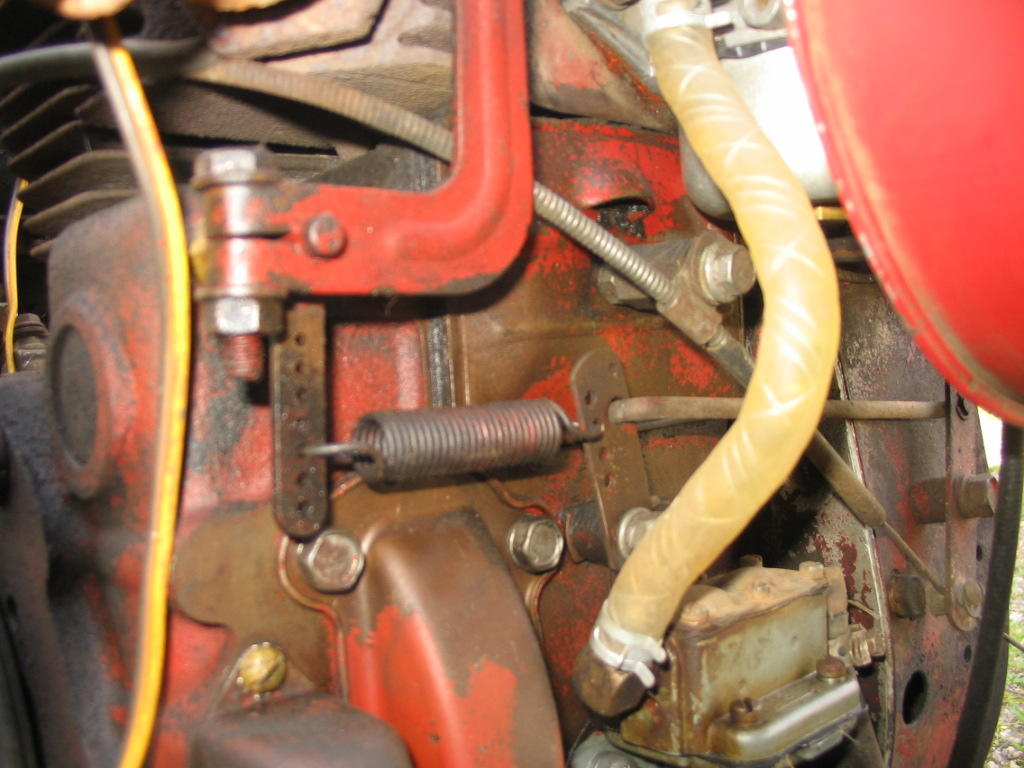

daveoman1966 3,762 #6 Posted February 8, 2019 This is a B-100 with 10hp Kohler...linkages are same as a C-160... 3 1 1 Share this post Link to post Share on other sites

ebinmaine 68,800 #8 Posted February 8, 2019 3 hours ago, daveoman1966 said: linkages Excellent Dave. Thanks. You also showed me a couple other things I was going to ask about. 1 hour ago, OILUJ52 said: governor ...... Hope this helps. Also excellent! Thanks Joe! Share this post Link to post Share on other sites
