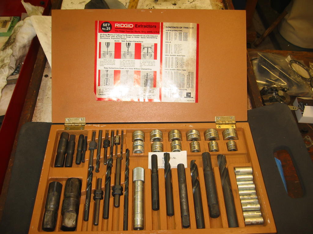

pfrederi 18,279 #9 Posted February 8, 2019 (edited) I have used Kroil for several years. it works... sometimes, also tried PB Blaster (smells terrible) but it works ..sometimes. Also bought some BG In-Force.. it also works...sometimes. Have tried ATF/acetone works sometimes, and even candle wax... hardly ever works and when it fails it sort of seals the gaps making it hard to use other stuff. Bought a Kroil pump oiler a few years ago. worked for a few years then started leaking badly. All too often wind up using this Ridgid #25.... Edited February 8, 2019 by pfrederi Share this post Link to post Share on other sites
